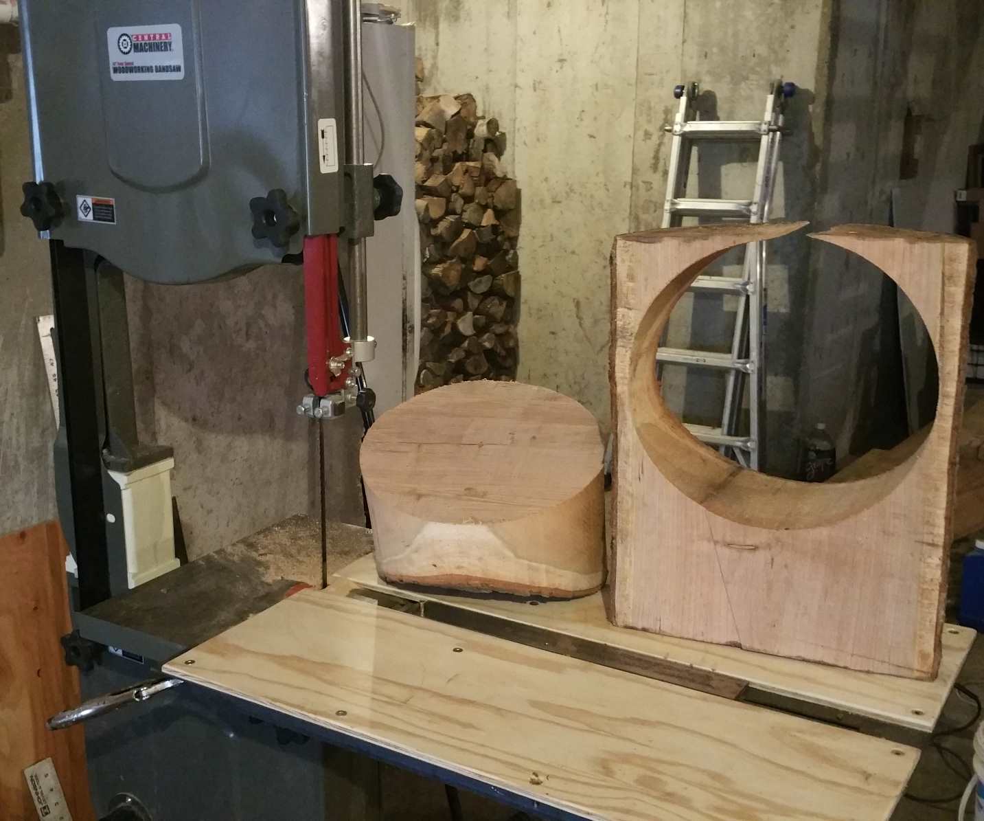

I've got the Harbor Freight bandsaw working pretty good. Today the woodturner blades I ordered from Highland showed up. I upgraded the motor to an old 2hp Lesson that was 240v only that had been sitting around for ever. It came from an old Sears air compressor (does anyone remember when they were green, not red?). It turns at twice the speed so I was a little worried but with the belts tightened and on the lowest speed it had no problems. I made a circle cutting jig that I can adjust to any dimension from 4" to 24" out of steel. I'm currently using vice grips to hold it in place but I think I'll use bolts now that I'm happy with how it performs. The first time cutting the tension on the blade loosened up so so the blade didn't track true but I think that was just a combination of the new blade and tires seating.
This was my first round blank. It had a crack in the center (the dark line) and I was worried that it was from where the tree split when the wind snapped it off. But once I cut the blank I realized that it's the pith so I don't think it'll pose a problem. I'm still looking for a lathe. I found a used green Powermatic from a school that came with minimal tooling for $750 but it didn't seam like a good lath for making bowls on. It was only 1hp 3 phase so I would of needed to add a VFD (which would of gave me better speed control than the reeves drive) but it only had a swing of 12". I already have some yellow birch that would be too big to fit on it. For a little less I can get a new Grizzly that would give similar range but like Deanocraft did I'm sure I would want to upgrade it to a VFD so I could slow it down further. Once that cost is figured in I'm thinking that I might want to move up to their 22" swing model that shouldn't limit me.
