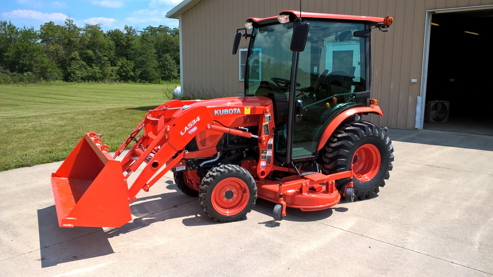

I finally got Imgur to upload a picture of my new B2560. I just finished cleaning up the trails in my woods, IN 89ー HEAT. No sweat (literally) with the AC. I'm Lovin it. :D WP_20170810_13_07_06_Pro.jpg
I guess you have to click on the image to view a larger picture.
Joe
PS. For some reason extra characters are inserted in front of the degree symbol, I can't get rid of them, please disregard them.
