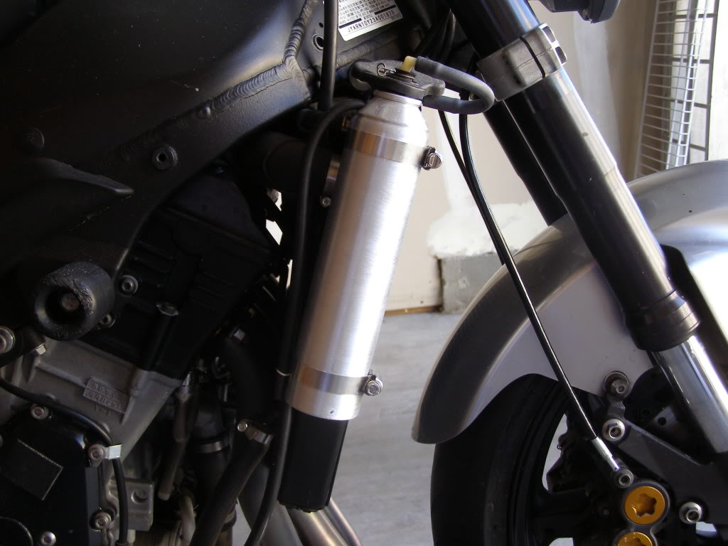

As Bird said, I think just buying a generic version of an overflow tank from the parts store is the better bet, but it is certainly possible to do something else; it might even be cheaper. There's a streetfighter style R1 motorcycle in my garage that has an overflow bottle re-used from an Aussie brand hairspray or mousse bottle, for instance. It's even cheaper to use free stuff, and it doesn't look too bad once polished up. :D
