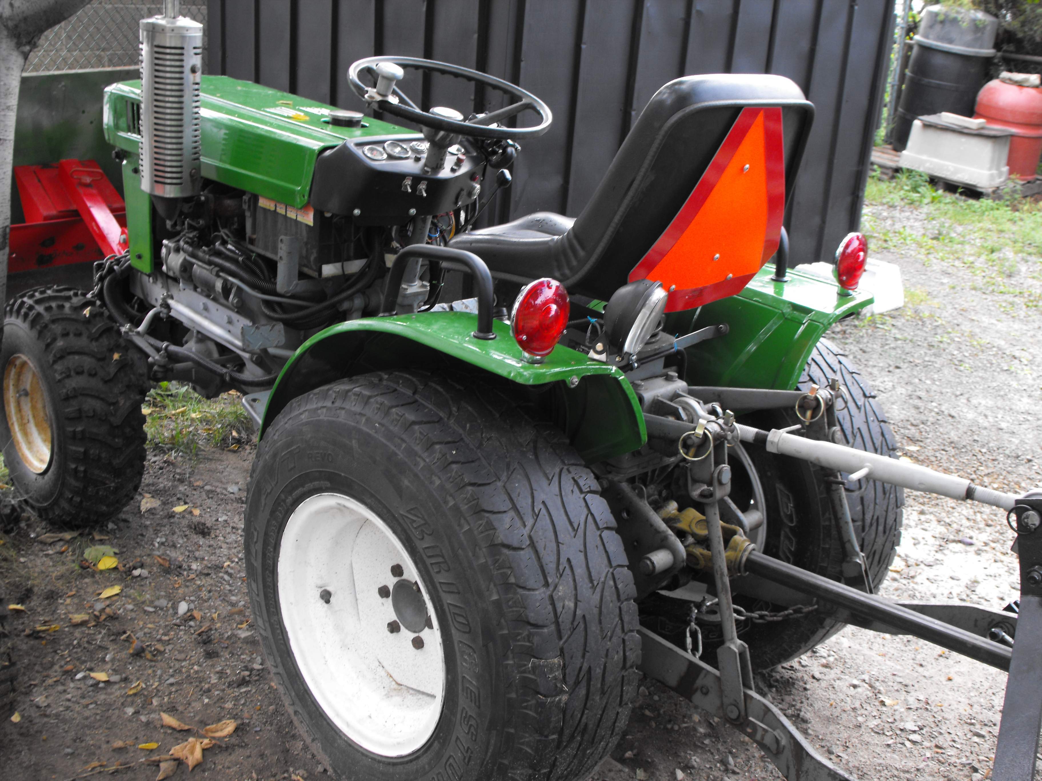

I'm thinkin' of buyin' a new Craftsman 48" snowblade,I had a Craftsman 42" blade but I left it on my LT that I sold in April of this year.....I wanted a 48" plough since I have a PA (Princess Auto) ( now repainted yellow) 4' plough for the 3 pt. ,you can see a bit of it in front of the tractor...but for the very little snow I got to plough at this townhouse we just moved into.....I'm not up to shoveling no more(health reasons won't let me do what I use to)the grass is mostly done by the hired contractors so I have a 60" (5') Waco/Douglass Finish mower for sale ...... a front plough is all I'll need since the driveway slopes downwards towards the garage, I need to know if I can tap off the rear hydraulic lines without messin' things up....and what do I need to buy in parts?,the angle I will just leave it manual,only the up and down motion is all I'll need, as the exercise to angle it right or left and will do me good,I've included a pic of my ISEKI G-174....Yes it's a 4x4,I could probley adapt the 4' 3 pt. graderblade to fit on the front but that would mean cutting/welding it to fit and also it don't have the fold down springs when you hit something solid ......Thanks in advance Ampa :)

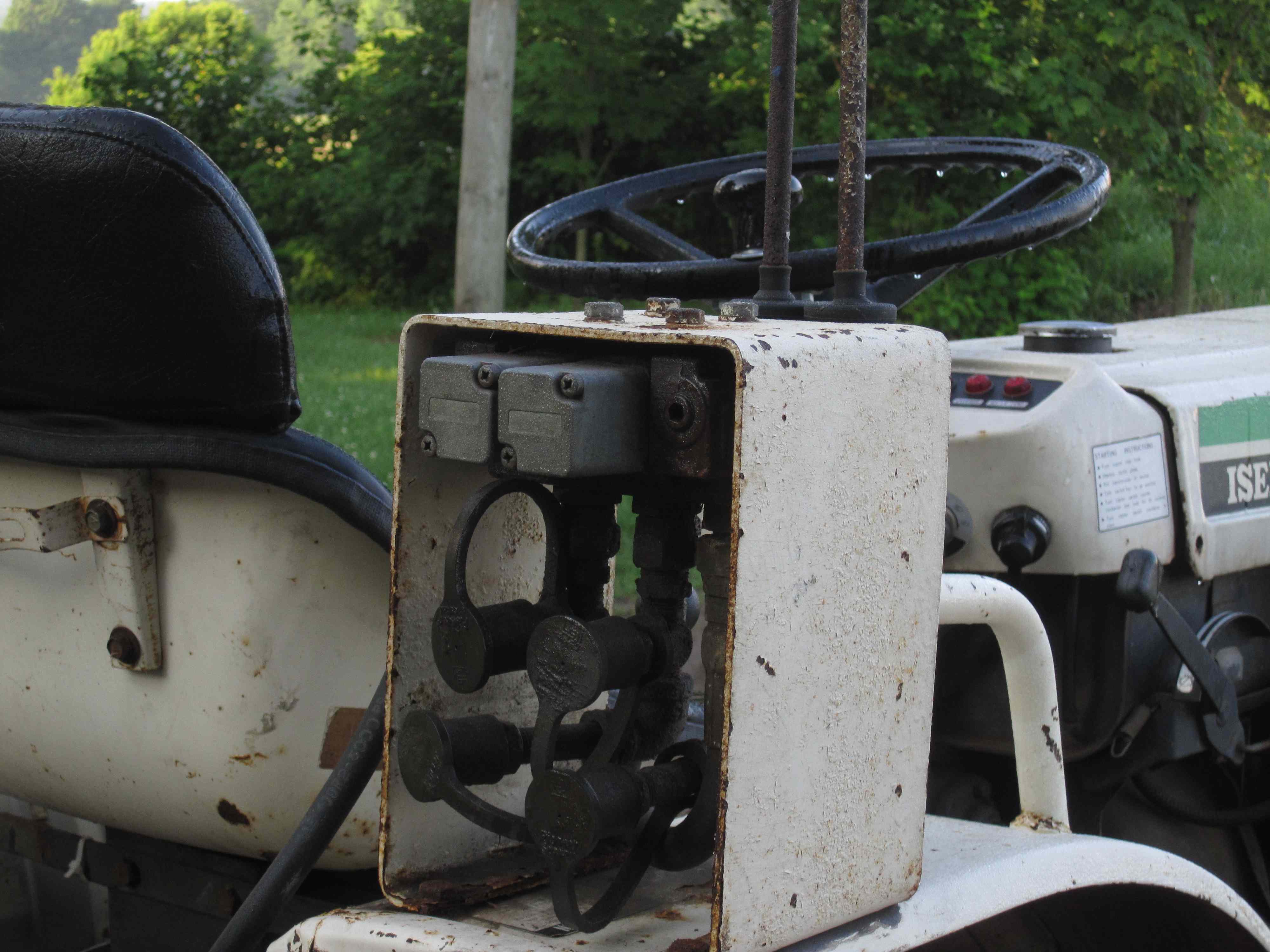

My G174 came with a pair of hydraulic lines mounted to the right rear fender. The handles were in the way so I had a friend remove the whole assembly. It took him about ten minutes. He just reversed a couple of parts and everything was back to normal. You might want to talk to a farm machinery guy and have him install a hydraulic line. It seems very easy to tap into the system just to the right of the driver's seat.

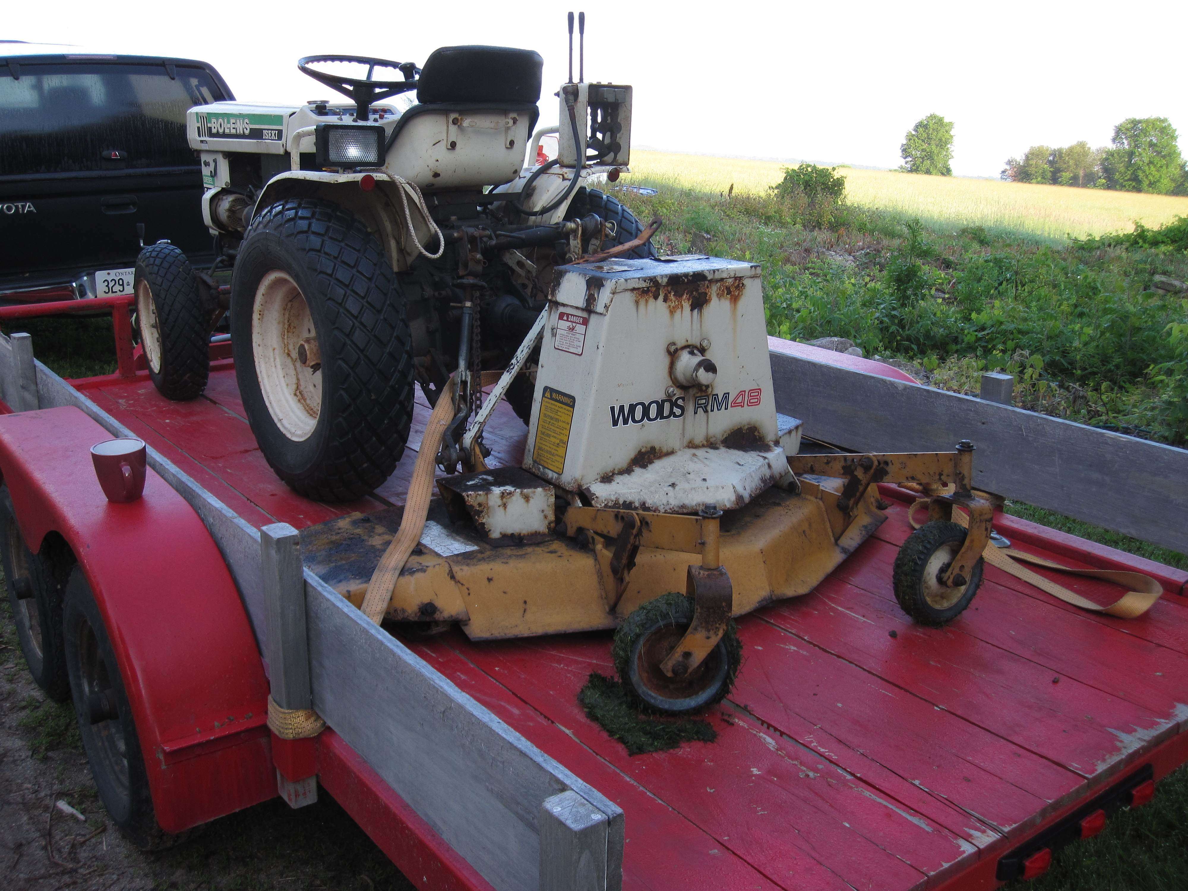

Here are a couple of shots I found on my camera.
Rod

Thanks Rod in Forfar,seems someone has added the box with the 2 controls,my Bolens/Iseki had no mods done to it,till I bought it,I guess this is what I need to build,the lines have caps on them so I assume these are quick disconnects,very interesting,all I need to do is use this set up,ask Princess Auto to make up some extra long HP Hydraulic hose,looks to me the one hose is connected to the controls,then to the 4 quick disconnects the return line which be the larger one must run up under the fender from behind,I don't know,I'm unable to see this one,anyhow by all means,simple,bein, quick disconnects yes one could connect very quickly,but like I mentioned above my tractor don't have this conversion,but one thing is proven,this can be done,I just need to see how this is connected to the original 3 pt hitch hydraulics,I know for sure that the pump is mounted on the side of the engine,the steel lines (2) one feed and one return run to the built in resorvior (not too sure if I spelled this correctly) but this be part of the axle case I presume,anyhow maybe some one else can now chime in,because this is what I need to do to get hydraulics up front to raise/lower and angle an new 48" snowblade for this coming winter,thanks once again for your interest and input plus providing the pics,take care....Ampa :thumbsup:

You sound as though you are in Ontario, as well. Wanta buy the whole kit for $100? The levers will take some loosening up, but it's complete.

First, with regard to the mower: it ate belts until I replaced the sheaves and got rid of the corroded surfaces. Now it works pretty well. Quite a job getting it apart, though. It's a restoration project. I own a 6' 3 pt. hitch blade which I use on one of my 35 hp tractors. Most of the mowing's with an off-brand 48" rotary mower I bought new this summer. I also have a new Rhino 60" rotary mower for the TAFE 35DI.
I have never used these hydraulic controls. All I know is that if I hit a tree limb while mowing, it would load the engine down until I straightened the lever back up. They're stiff from disuse and not pretty, though I think they did the job when last connected.
The unit's in my storage shed. Tomorrow afternoon I'll take a picture of it and send it along. The plumbing's surprisingly simple.
