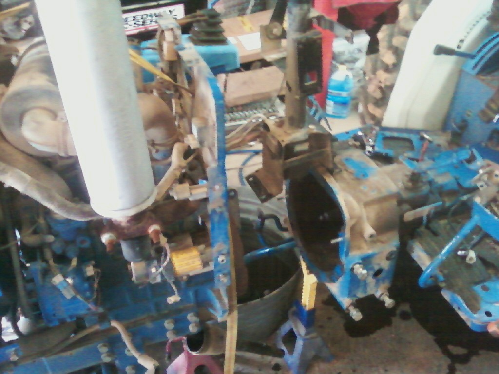

Alright, I finally got my Mothers Honda put back together and running. So I was cleaning up the shop and started backing the tractor in, wouldn't you know it. The roll bar is about an inch to high to clear the door. It was getting late so I'll unbolt that tomorrow evening maybe. Back it in and start tearing into this clutch issue. I'll post up pics of my findings when I get to that point. Long and drawn out process, but I am getting it done. slowly but it is getting there.

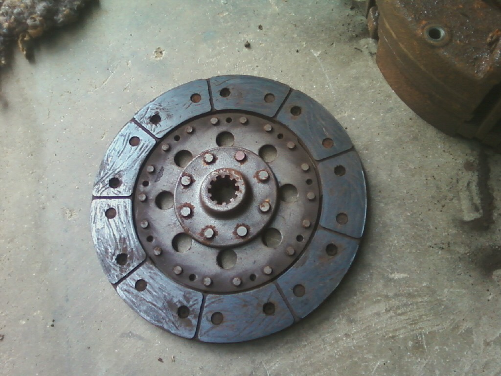

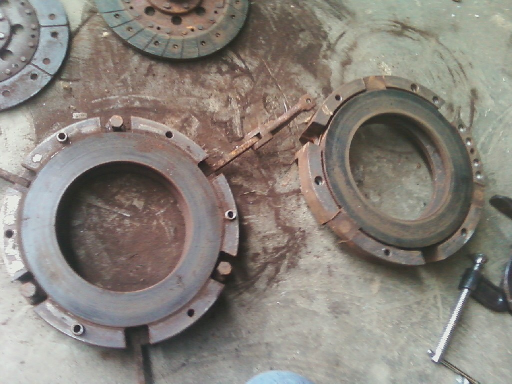

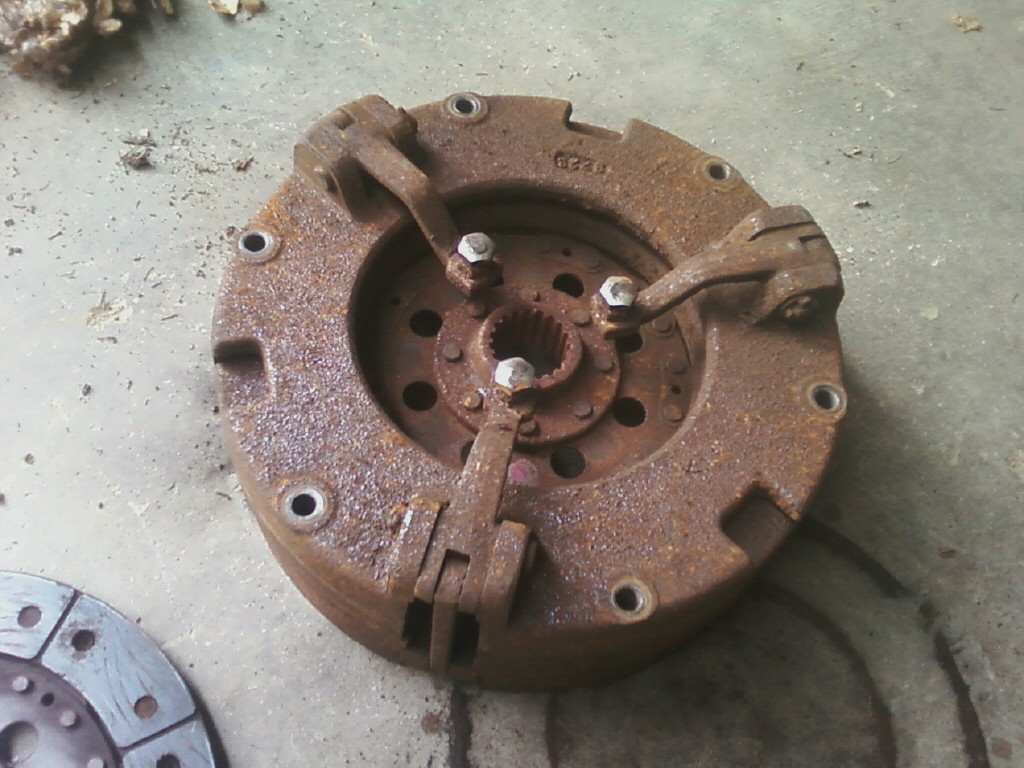

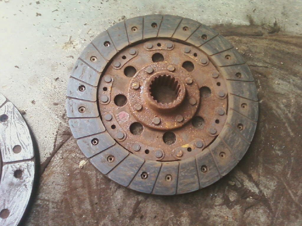

ALrighty!! heres what I got. Doesn't appear to be really much anything wrong with the disc themselves. Tractor split the clutch pedal moves freely just has the return spring tension. What I am thinking, is that the pieces of the pressure plate are binding up not letting the clutch work properly. What makes me think this, is because when I was removing the pins for the fingers. I had put 3 c clamps around it, to keep it from flying apart. I removed all the clamps and it didn't come apart until I tapped on it with a hammer to break it loose. In my opinion,( tell me if I'm wrong) These pieces should't be bound up.

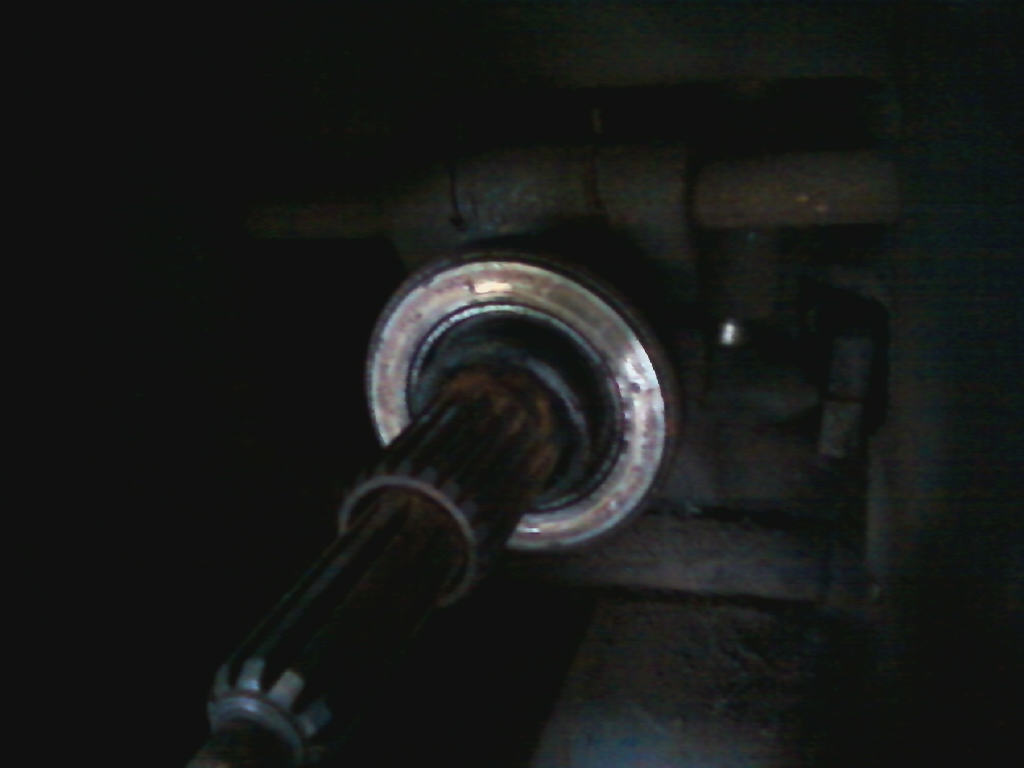

Oh, I should add, I spun the input shafts with my hand, put the tractor in gear, could tell it was trying to spin the tires. Also the PTO, the output shaft spun. so the hard parts seem to be working properly.

Nice, I think the back end as far as transmission input shaft and pto shafts are working like they should. My first impression of the whole assembly is "lots of rust"!! I wondered if this tractor was partially submerged in water at some point. I would have done the same as you have done by using 2 or 3 c clamps and secured the assembly before attempting to take out PTO clutch. I'm sure taking off the whole assembly off of flywheel you slowly loosened the bolts off in a criss cross pattern not to put undue pressure on the spring assembly. I wonderd if you could put a piece of 2 by something on the pressure plate assembly for the pto and use two clamp to see if there is any spring action. My guess is this thing was frozen shut due to rust? did you get a new clutch set? how much clutch disk thickness you got? pressure plate surfaces look good and just need a bit cleaning. How much effort did you put to split them?
I wish there was easy way to manipulate 3 fingers evenly so you could clean things up , put old clutch together and did a dry run without putting two side of tractor together.
Good job so far Barry:thumbsup:
JC,
Ps. So the disk with the larger spline was for the transmission and smaller for the pto? right?

The rusty part has me baffled as well. The tractor has sat out in the rain a few times, It usually has been parked in a barn. I was considering sandbalsting all the parts, and putting some paint on the parts to prevent future rust. clean up all the surfaces where the plates are suppose to move freely. Even though the disc appear to have good thickness. Not sure what the thickness tolerance is supposed to be?

the larger splined disc is for the PTO smaller for the transmission.
