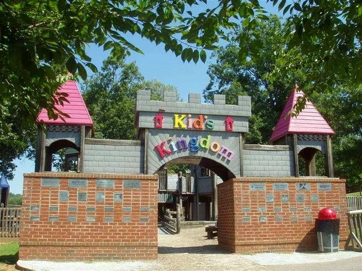

When we built the Madison AL Kid's Kingdom in 1997 and during the rebuild in 2004, we used nothing but screws and galvanized bolts and nuts. No nails whatsoever in the construction. This is a professional designed, community-built public playground. The same people who designed the Madison playground also designed the community-built and public playgrounds in Huntsville and Athens as well.
That might something you would might call a clue right there.

My kids used it until they outgrew it. Being on the KK Build and Rebuild Teams is one of the major reasons I don't nails anymore.
