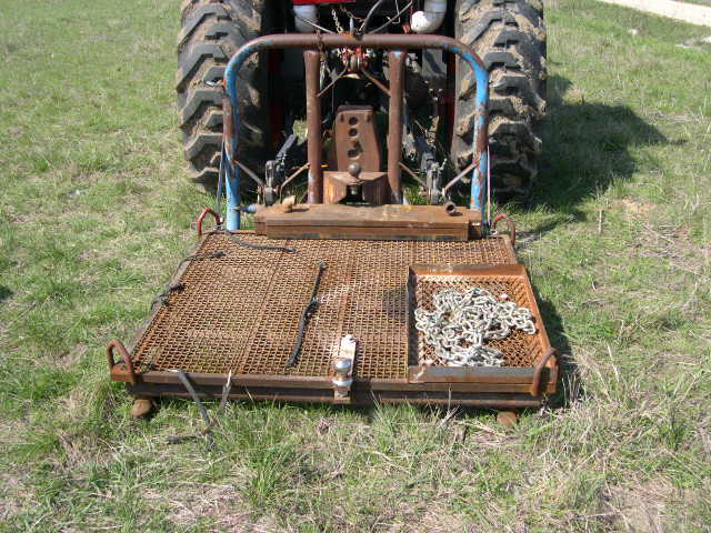

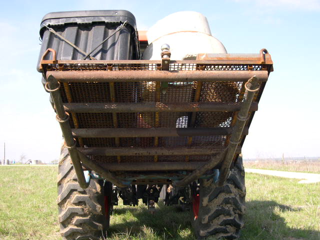

OK this post is from texasjohn, he posted this in another thread I have on rear weight being more functional than just heavy. This was his solution and an all time classic!!!
texasjohn said:
I used my 3PH hay fork, put a carryall on it, welded a gooseneck ball to the hay fork, put a grate floor on the carryall (makes it easy to chain/tie stuff down), added weights, toolbox, other heavy stuff. This rear rig goes with me everywhere except when I'm actually hauling hay on it. The carryall has pipes that slip over the tines of the hay fork and chains hold it on the fork. So, this rig is both heavy and functional. Photos below
Thanks texasjohn for the pics and for permission to post this over here.
Folks, this is one of those things every one needs! :)
