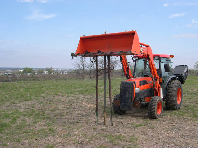

Now, about putting T posts in the ground... use your FEL, have a buddy hold the T post, lower flat bottom of FEL T_POST_DRIVERS_3_1121.JPG, buddy retreats to safe distance (they can rainbow/break if you hit a rock just wrong), gently lower FEL until post is properly in ground. T_POST_DRIVERS_2_1122.JPG around the post of proper length so that sheath hits ground when post is properly driven.
To pull T post, wrap chain around post, hook to chain hook on FEL (you do have such a chain hook, don't you) and lift FEL.
