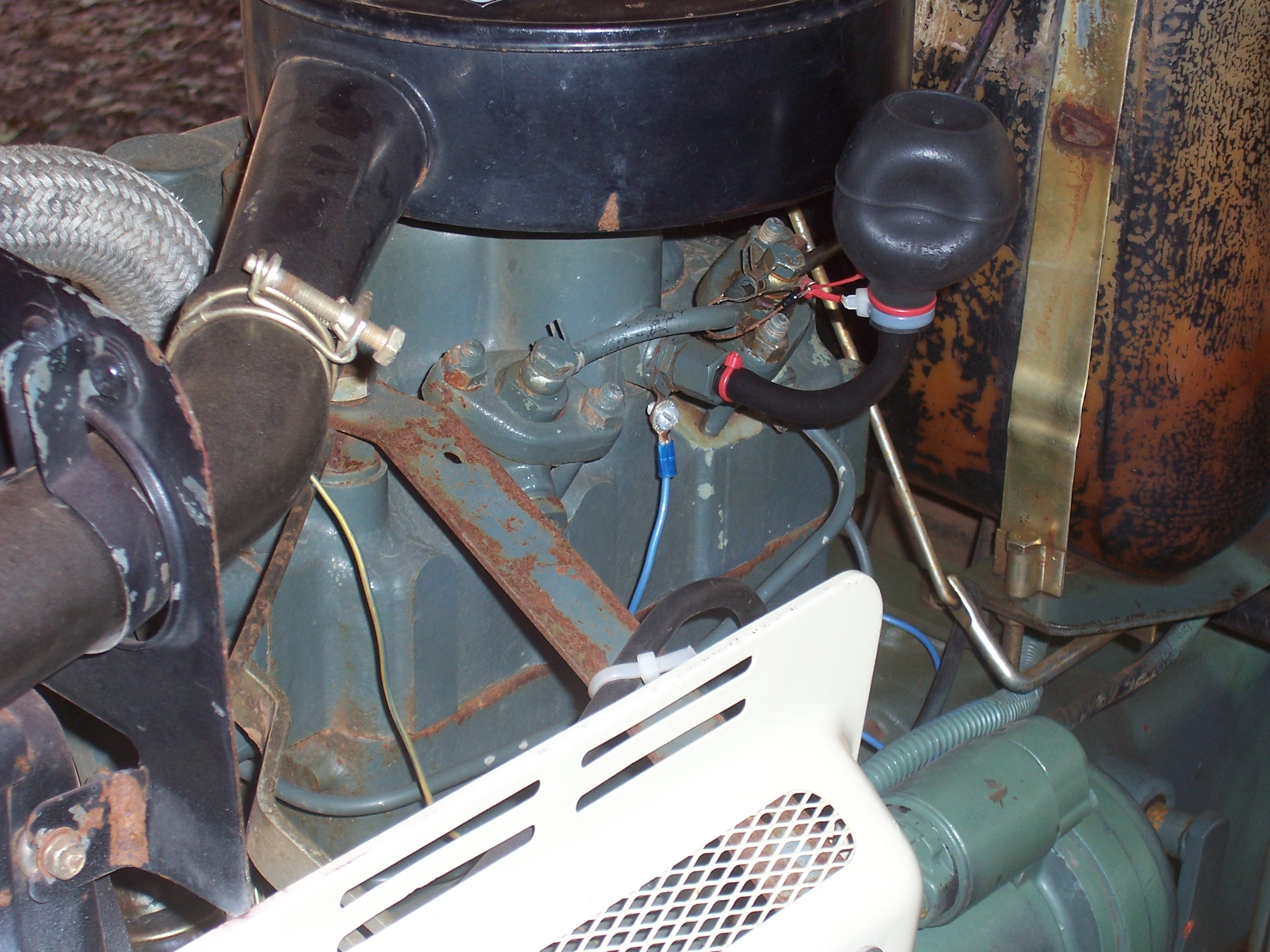

That is used to start in cold weather. YOu turn the key to the left and hold it for 10 seconds then start the tractor. If you have it (there will be a little plastic bottle that holds about 2 ozs on the top of the front of the motor behind the fan. It will connect to the intake with a rubber hose and also there will be a thing that screws into the intake with a wire running to it that will feed power to it. That thing will heat up when you turn the key and then allow some fuel (which is what goes in the bottle) to run in and ignite, warming the air up to aid in starting a cold motor. You really should not need it untill outside air is in the 30's or below.

It's just diesel fuel. If you have a flip-cap bottle under the hood, you need to add a few ounces of diesel to the bottle. The newer version is a closed bottle that is plumbed into the fuel return lines coming off of the injectors. No need to add anything to that style bottle. (You really can't anyway because there is no cap.) Also, I've discovered this winter that my thermostart plug needs to be replaced. They go bad periodically, so if you don't see any improvement in cold weather starting when using the thermostart, the plug is probably no good.

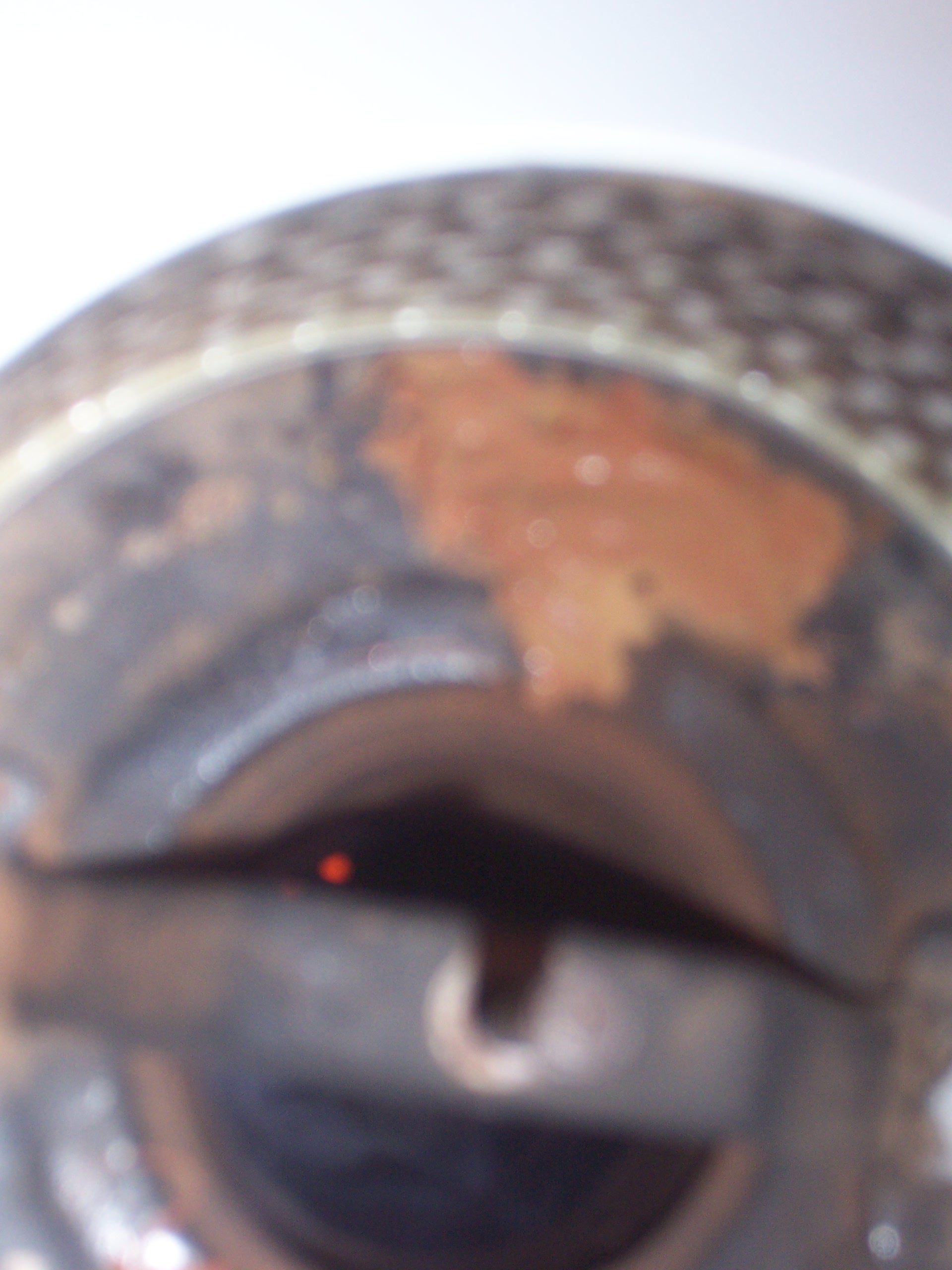

A City slicker Huh :laughing: This should explain it better. There Should be An Ignighter with A hose from a cup with diesel fuel in it. When you give the Igniter Power. The Heating element heats up a check ball and lets in fuel and it gets ignited causing hot air to mix with the fuel in the tractors Cylinders when you go to start it causing it to start like a warm day.
Mine didn't have the fuel bowl but The Igniter was there. I put power to it and the Coil heated up but wouldn't burn. Thats why I came up with this to see what was going on. Ended up the check ball wasn't opening enough which just a liittle squeeze stokes it up.;)

Just checking the weather it's going down to 25 Tonight so I was able to go out and use the TS. It's still in the Upper 30's When I went to crank it up. It was evident it looked pretty good. Sorry about the pics. darn camera Ph. You can see the Red Ign. and the after math in about 10 sec. Just bumped the starter and it fired rght up :cool:
