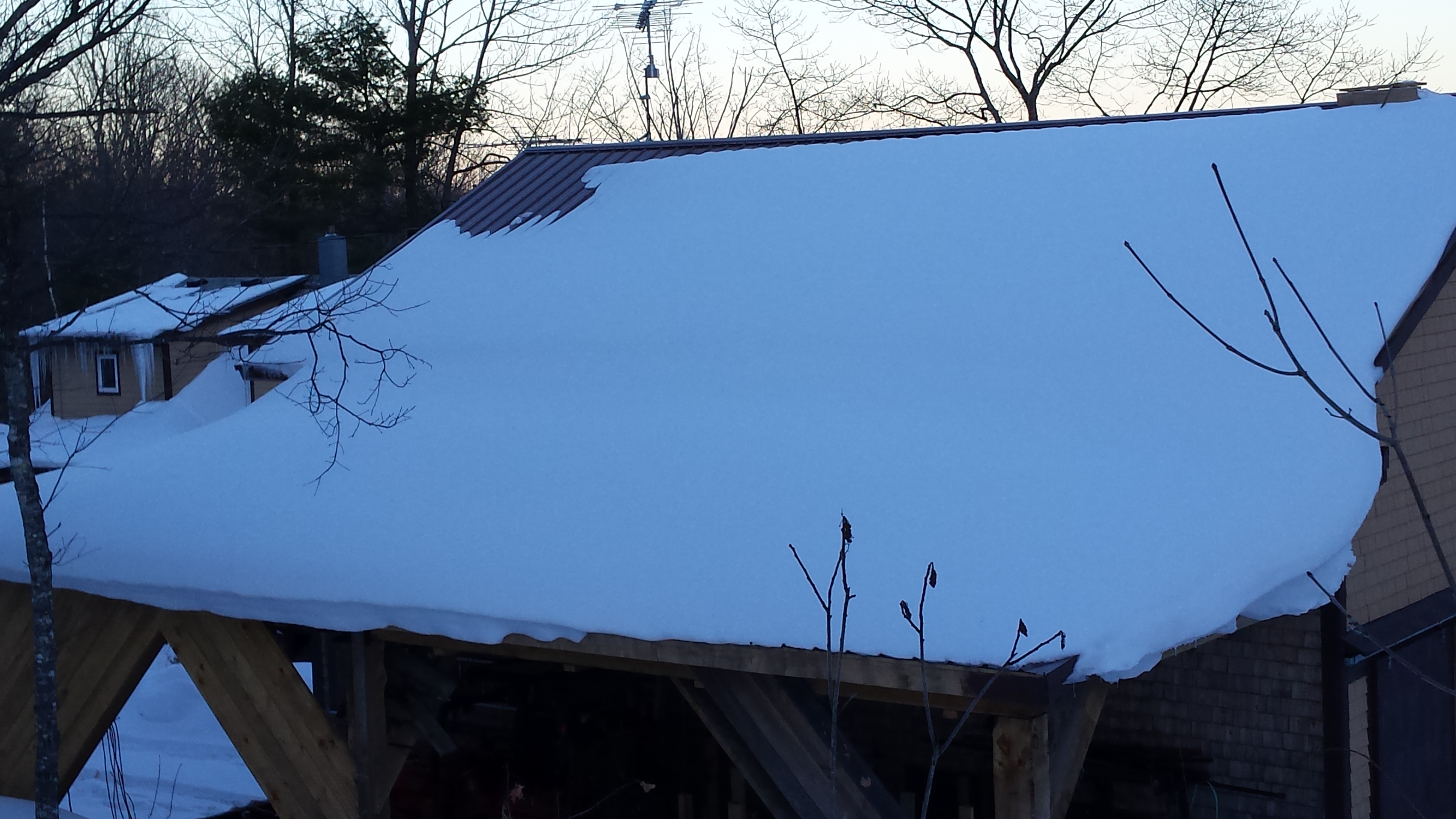

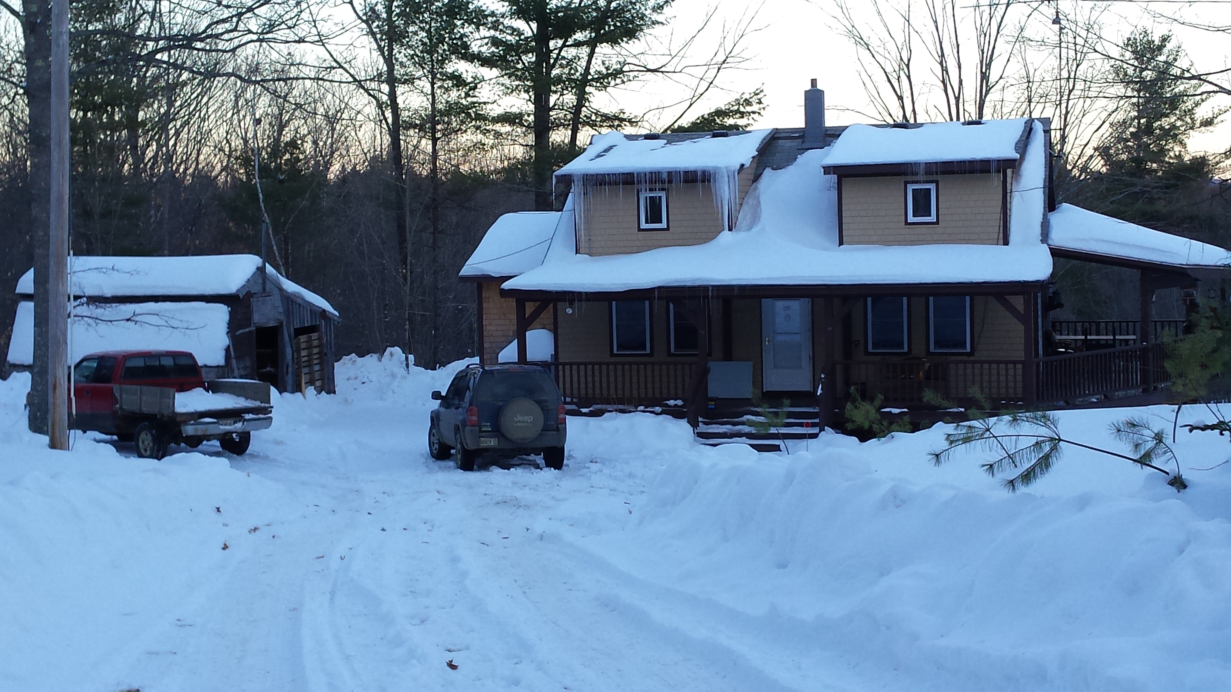

This weekend I'll put some (Roof Melt Tablets) on my eve's, sofar the Weather Shield underlayment seems to be working. The snow on my garage lean-to, I'll rely on the 2x6 rafters to hold the weight, only have to wait 6 more weeks.

This weekend's job - shoveling the snow off. Must be 28" on it. It is a metal roof. We keep the snow away from the wood stove chimney brackets - the sliding ice and snow moves as one piece and bends the brackets- breaking the sealed joints on the stainless steel chimney if I let it. I use a roof rake for that from a ladder I use for cleaning the top of creosote.
The the roof is pretty tough - but I would rather not worry about rain as we go into March - gets heavy. This last snow storm earlier this week- got 21 inches.
My metal roof is on a 2x4 sub frame over my original roof. I used to get ice damns but the air circulates easily. I like metal!

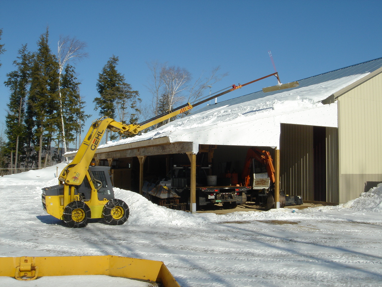

It's on my weekend to do list on my low pitch lean too. At almost 2200sf, I came up with a "work smarter not harder" method.

Unless the structure was built substandard I wouldn't worry about the snow load. The building code will have sufficient redundant strength designed into the snow tables. What I would be concerned with is the ice daming which will occur as the snow melts. If you have ice and water and it was properly installed you should be ok. If it wasn't you'll realize it when the leaks appear. Roof rakes are certainly safer than getting on the roof. I ruptured my L5-S1 disk years ago shoveling snow so I would never recommend shoveling a roof.
Be careful with shingles and it's very easy to damage them.
That's cheating! Looks very cool though. Hope there is a glass window on the front of your skid steer, or you will have lap full of snow!
