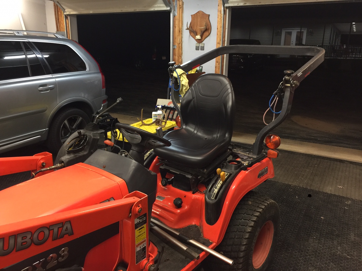

Yea I fought my seat woes for years!! Finally a few years ago i search and found this seat from milsco company Kubota BX Series Series Kit (PN: 6831) .
I love it!! Although when i when to install it i did have to modify ever so slightly in order for it to bolt up right. The cheapest place i found to get it was Rural King. Here is another link to buy it.
Kubota BX Series KM 129 Bucket Seat Kit | Tractorseats.com
In the end i ended up talking to my Kubota dealer about it and he said he could order it for me. I went with the dealer because he matched the price of Rural King.
Maybe later i can snap a few pics and post them here.

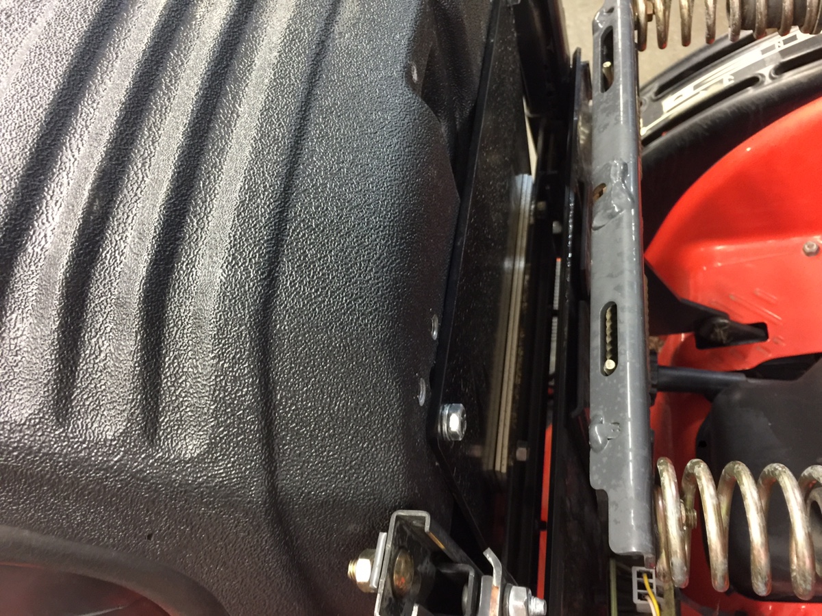

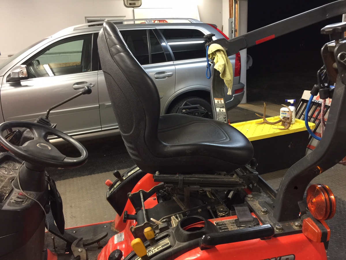

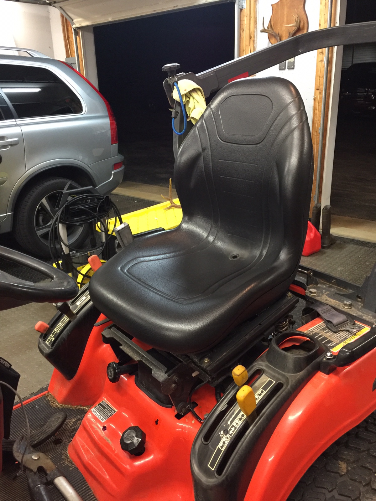

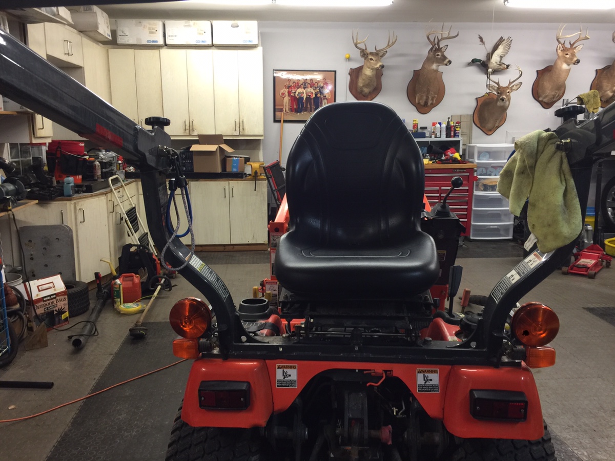

I had to ad the 1/4” to the rear of the seat mount to raise slightly so the back of the seat would clear the seat slide track. A little picture strong but more is better.
Now my BX23 is a 2004 so this seat may have been designed for newer models and may not need to have the rear of the seat raised.
