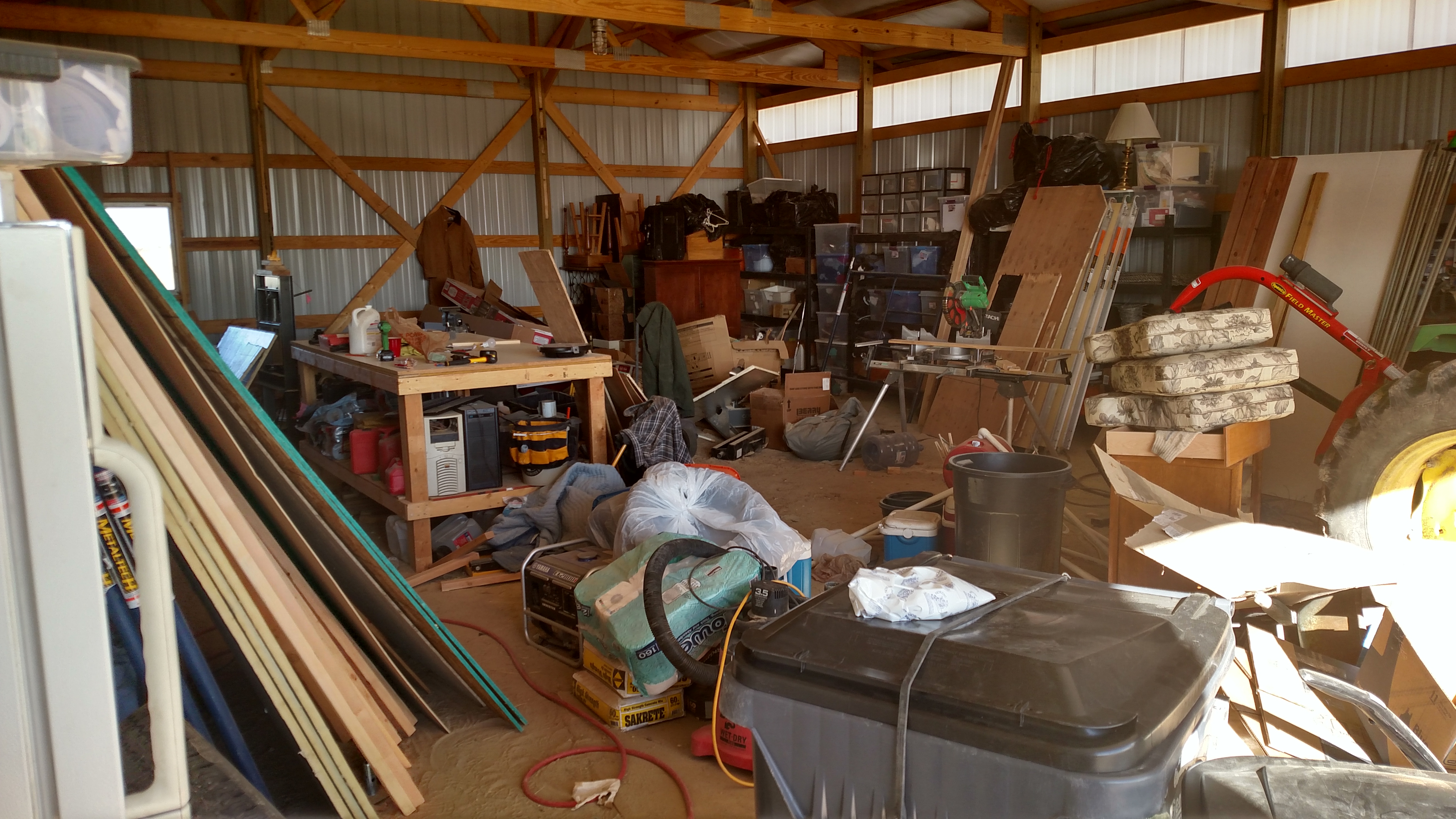

so this is a snapshot of what it looked like after i spent half a day organizing the barn (again). it had gotten to the point that i was a little nervous moving about. there were things on top of stuff that were more than a little rickety. if you wanted to go somewhere within the barn, it was often easier to traverse the length of the barn, go out one of the doors, and then traverse back down again. i say traverse because walking kind of implies a more or less straight line, and there wasn’t anywhere in the barn where it was that simple.

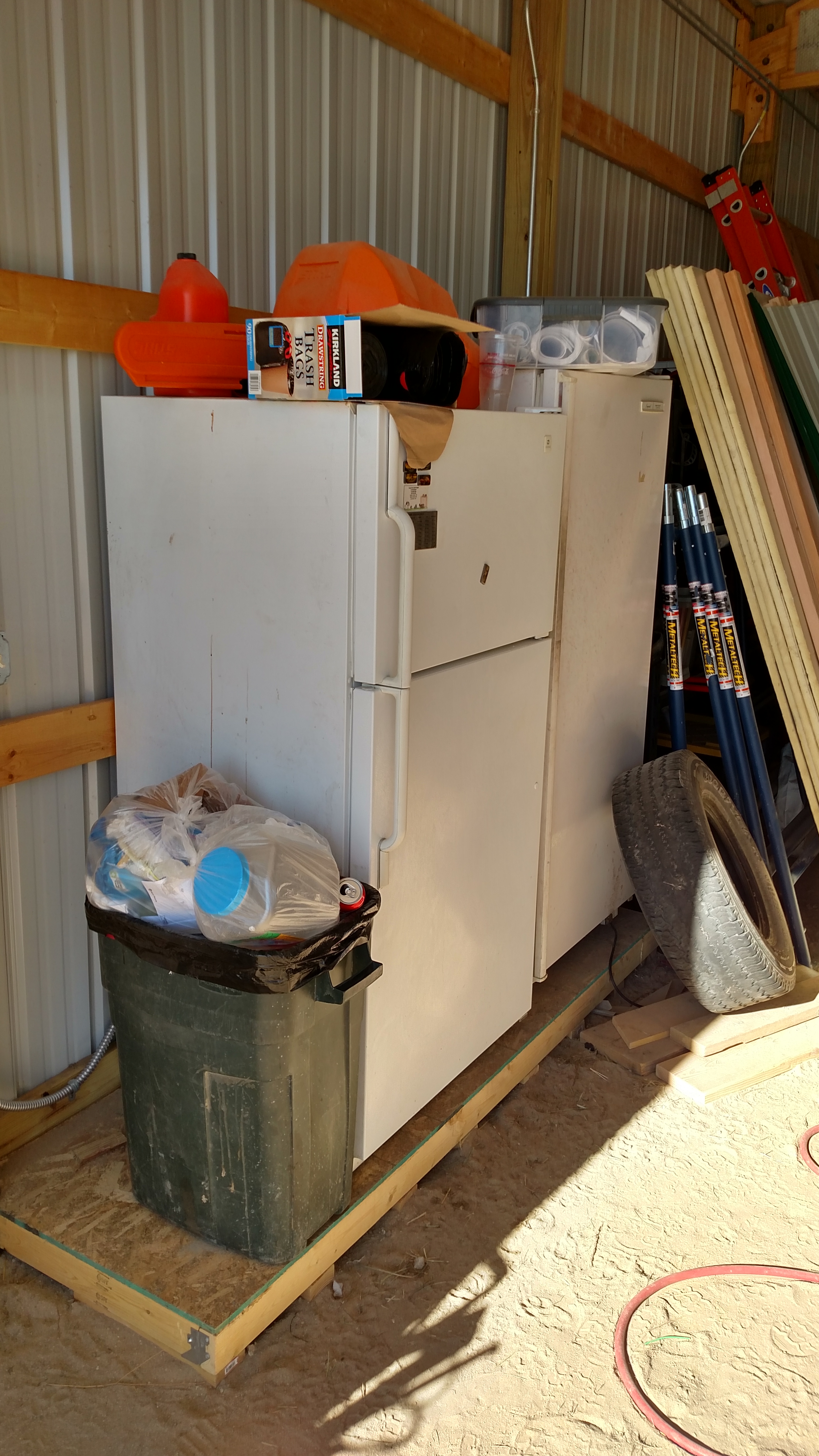

one of the things i did before the electricians came out again was to build what i call a skid for a freezer and refrigerator that we stuck in the barn. a skid is just a sheet of 1/2” osb on a pressure treated 2 x 4 frame. the frame is leveled on the uneven dirt floor (i’ll add some gravel here and there if necessary to speed up the process) so i end up with a level, stable platform. this is necessary for fridges and freezers.
i realized that part of what made the barn such a mess was that with the uneven dirt floor, it was pretty hard to stack things securely so stuff was spread out everywhere. so if i made another skid and stacked stuff on it, i could a) get things up of the dirt floor and b) consolidate things by stacking them on an even, level surface.
so i made another skid. and then another. and now i’m working on the third. it has helped quite a bit.

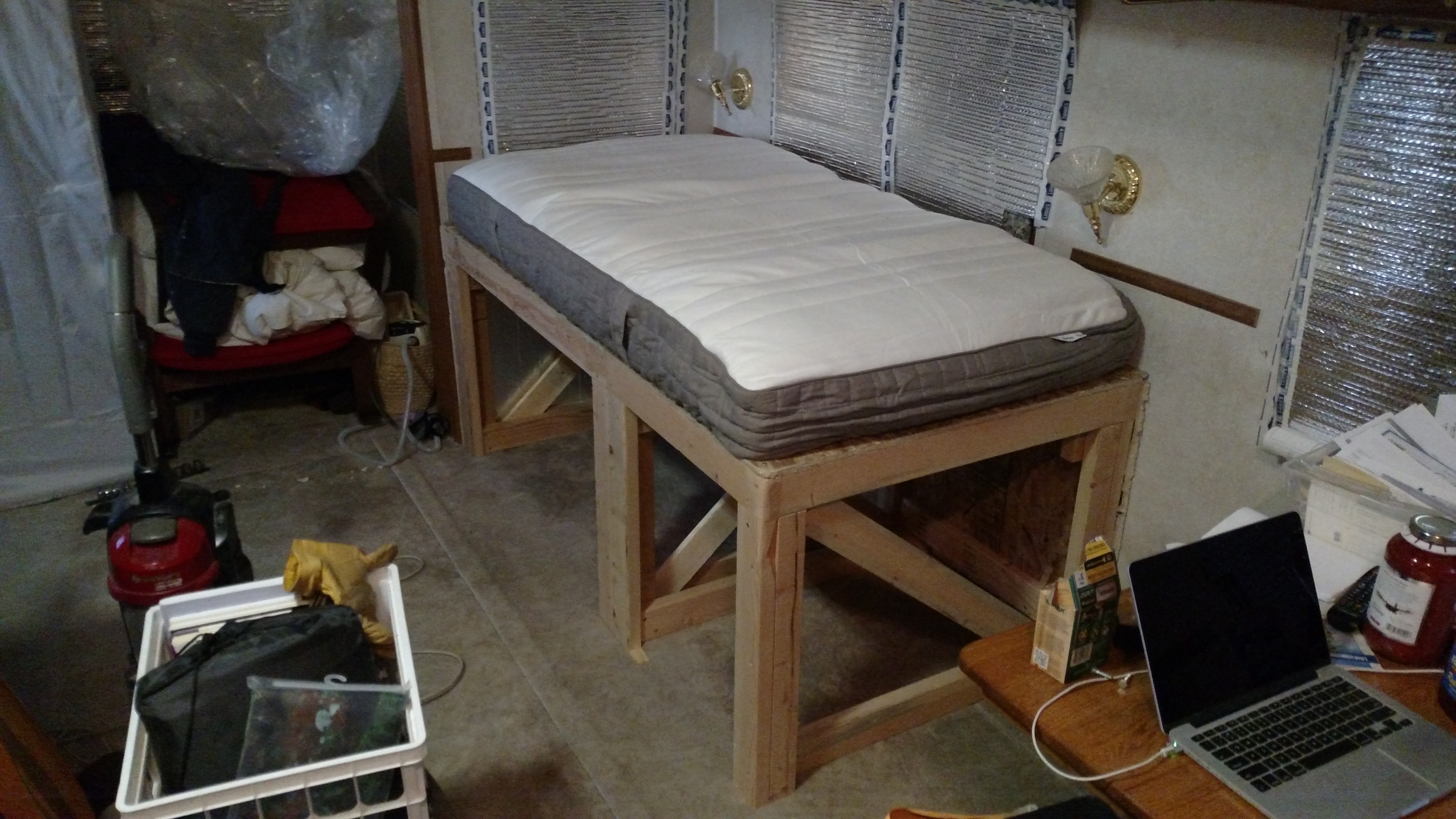

i got my wife’s bed done. it’s pretty tall, but that was done on purpose. the big section underneath will hold 6 double stacked large plastic bins where we will store food and kitchen ware. the small section underneath is for the dog.

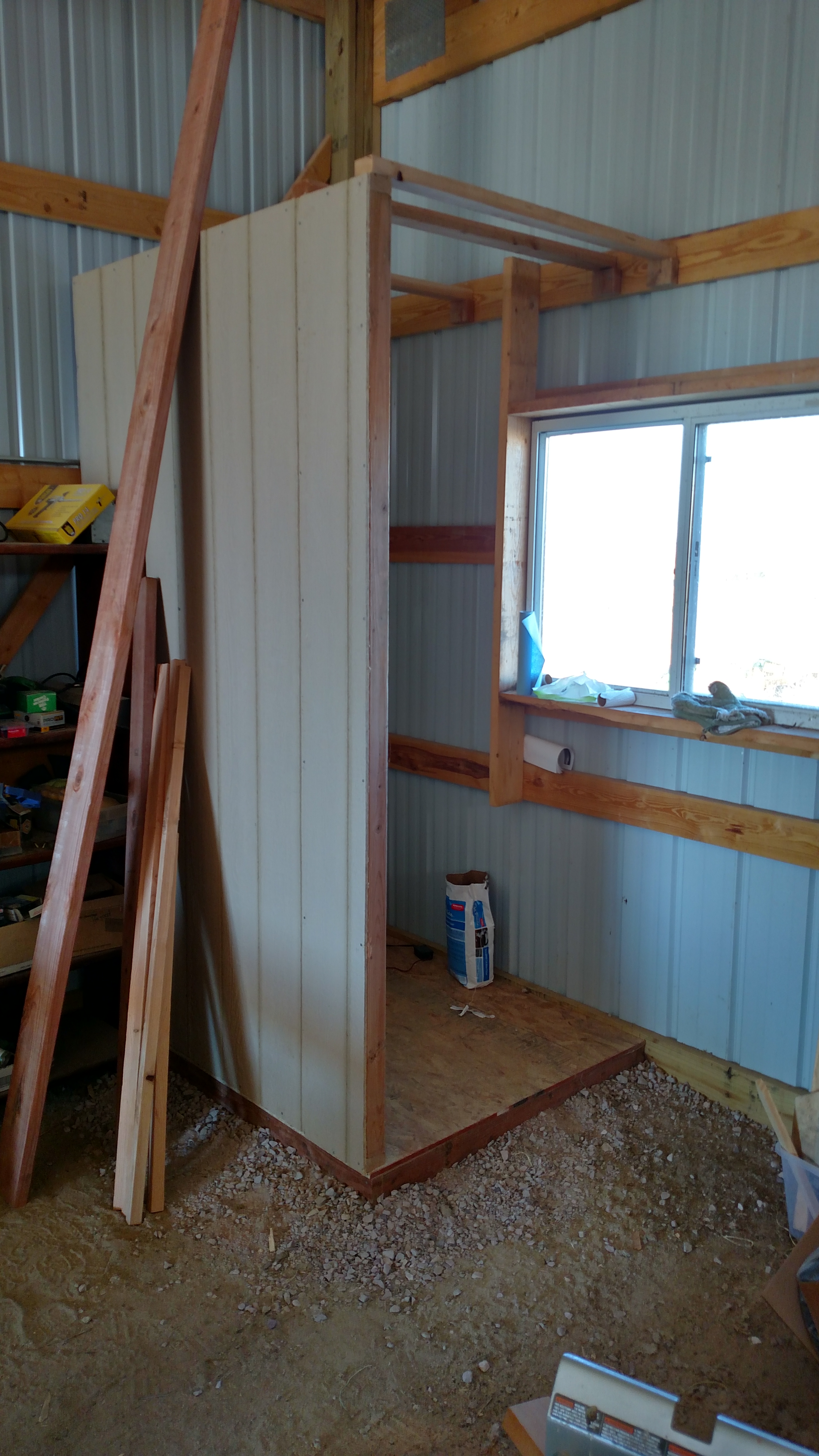

i also made a skid for the flushless toilet we've been using. i added a wall for a little privacy, and voila! a bathroom.

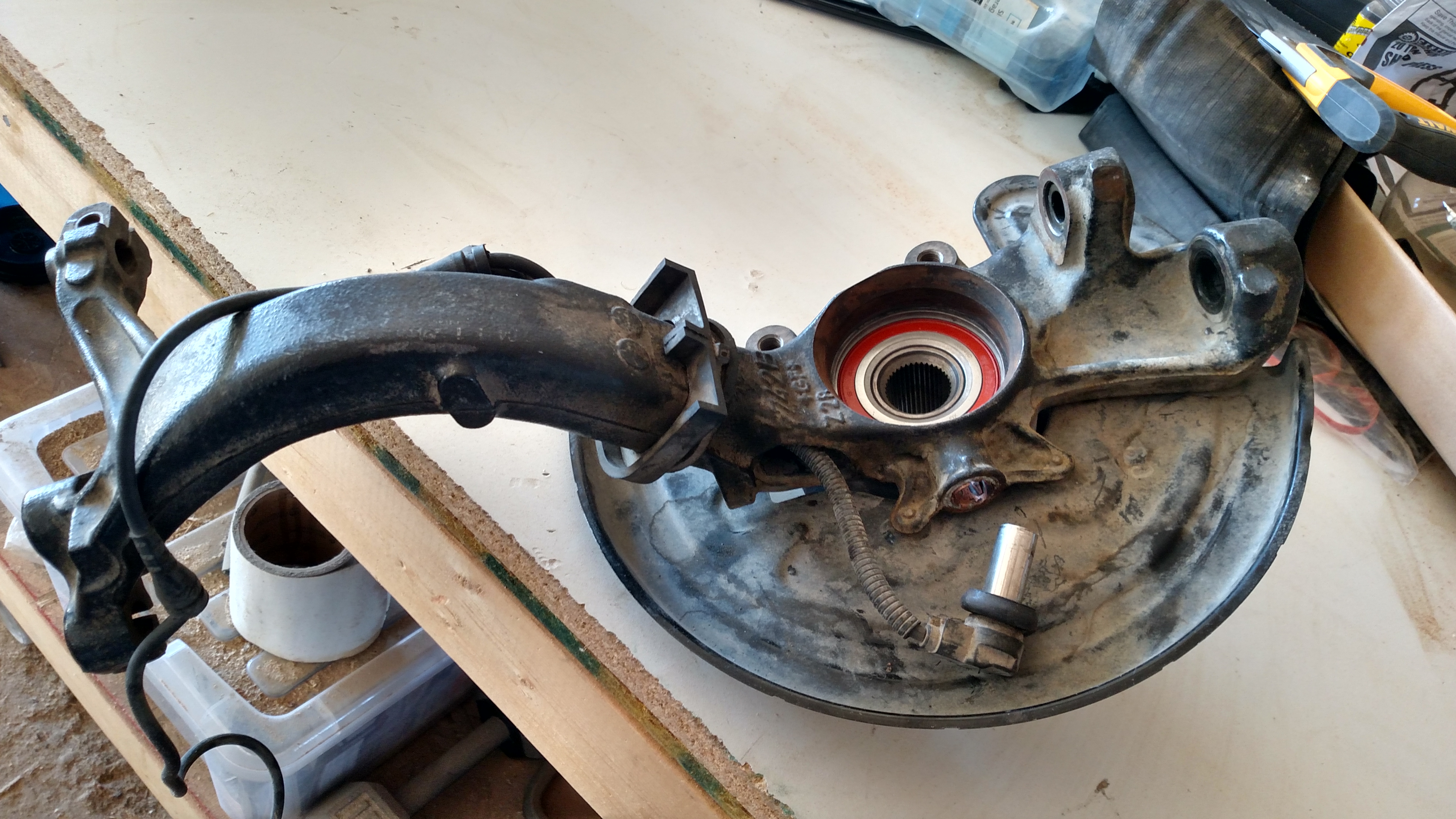

i’m working on the passat again. a year and a half ago i hit a curb hard enough to destroy the wheel and tire, and the wheel bearing started to make noise. while i was in there, i replaced the driveshaft and the front lower control arm.

another thing i've been up to is organizing the barn. originally i had almost everything laid out horizontally (ie, on the dirt floor). recently i've been working on going vertical.
and i'm getting a lot of the floor space emptied. this is good, because i've got another car i need to stuff into the barn.
GO VERTICAL!!
I wrote before about your need for pallet rack. If you lined the back wall with 12' tall pallet rack and the side wall with 10' tall rack you could get EVERYTHING off the floor and work in a lot of table space.

but, but, i did. i have. i am. while i don't have pallet racks i do have their little brother. my racks, bought at costco, are 6.5 feet long by 2 feet deep and have four shelves configurable over a seven foot range. i have 6 of these rascals which gives me 312 square feet of storage with a footprint of 78 square feet. and every one of them is full.
i have three other dissimilar racks of storage, one large tool box, and one small toolbox. my barn is 48 feet long with posts every 8 feet. the front section (between the first two posts) have the man door on the west side and the electrical junction box on the east side. all the other sections along both walls have racked storage, all of which are full.
