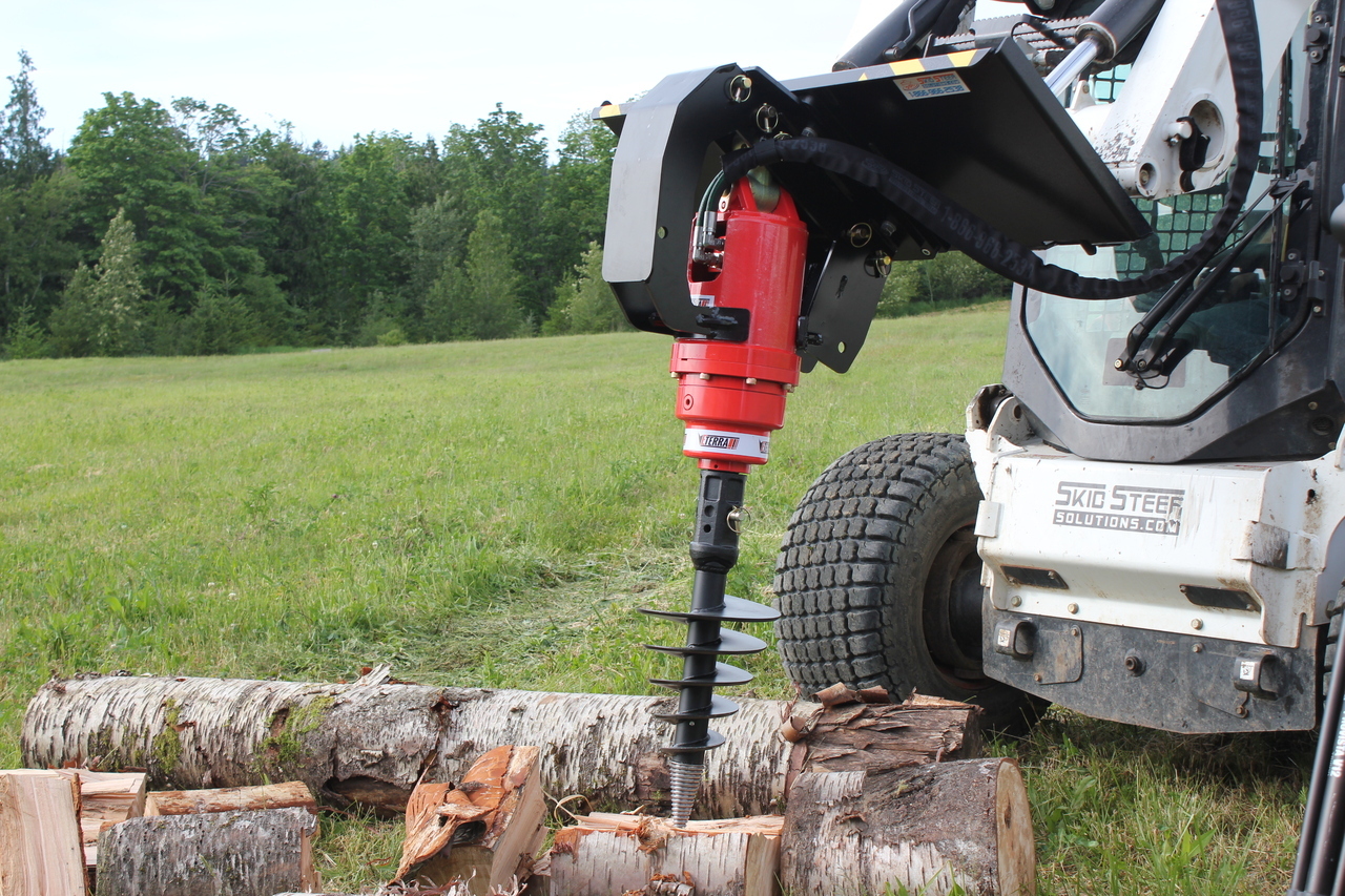

Here is one for a Skid Steer if anyone is looking for a similar device. 2" HEX with adapters available.
Eterra Screw Splitter Attachment for Skid Steer Loader | Skid Steer Solutions
   / The screw log spitter hunt! #38
How do you keep the log from spinning, and if it gets stuck ( like they skipped in the video), how do you back it out. PTO's do not have a reverse. Looks like a PITA. I too have gotten the tree buts, and just use the chain saw to chunk it apart. Cut slits in the butt end vertically about 2" narrower the the bar length, then did the side cuts working trough the trunk at the lengths that fit my wood stove - then split the slabs to the desired size
