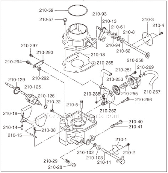

My PT425 had same symptoms you describe. A bunch of times! Dirty fuel system. A fuel filter coming apart faked me out.
Anyhow same fix every time.
Pull the top off the carb. May have to remove one thru bolt to get the top off. Take the slo jet out. (part # 210-5 in the diagram) Get a strong magnifying glass and look at the hole. I betcha a six pack of my suds of choice you will find blockage of some sort. Blow it out and blow out the hole it came out of. Keep your face and eyes out of the way when you do that. Don't ask my how I know to not do that. Blowing out the hole should blow out the main jet in the process. Have a look down in the float bowl for any crud that came out or was already there. Mop it out.
As for that pile of gorilla crap they call a muffler. I pulled the whole mess out of there and made up a duel exhaust out of u-bends and some cheap shorty craigslist mufflers. Works slick and no heating problems anymore unless I lug it at slow engine speed. Sounds like an old BSA spitfire race motorcycle. Close to a Triumph but no quite the same. Way the heck better than that hugely restrictive way to small pipe crap they put on there. You listening Terry?
Also electric fuel pump etc. All good advice others have posted.
One more thing. If the accelerator diaphragm (part # 210-253) ruptures it will drain the fuel bowl through the vacumn line right into the cylinders and on into the oil. Without a shutoff all your gas is in the oil. Do not buy the expensive replacement from Suburu. Fifty some bucks or more. Go to the Harley Davidson dealer and get one that fits the big oinker hog motorcycles for way cheaper. It's the same part! Buy one for the Suburu off ebay and you will probably find its a hog part complete with the unnecessary extra gismo for hog carbs.
Edit this - the way to check for a ruptured diaphragm is - run engine to have carb full of gas. Shut off and pull the vacuum line (part# 210-267). If gas runs out the diaphragm is ruptured. Easy check.

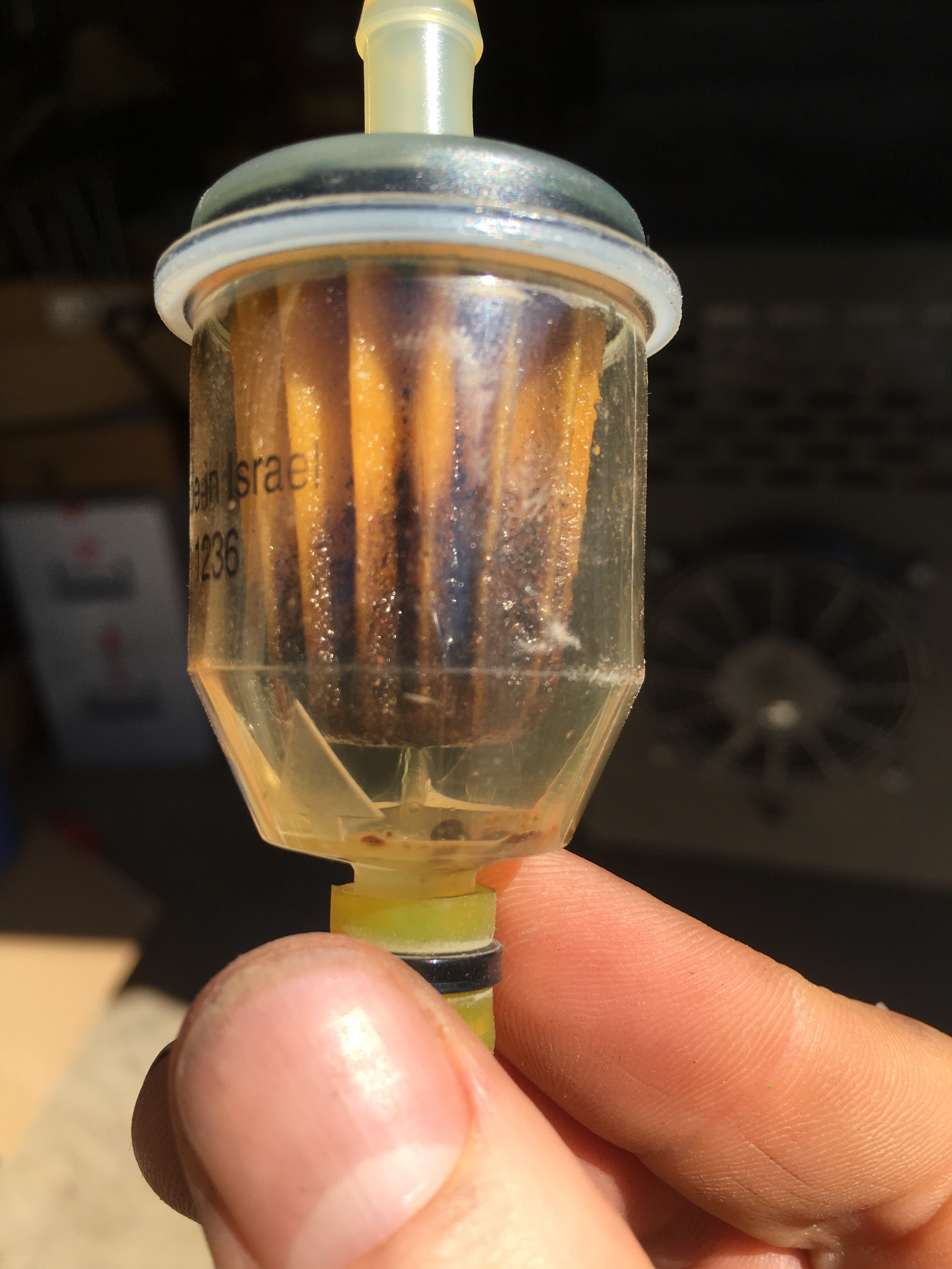

So far I've replaced the fuel filter. It was pretty nasty (see photo). Don't know if the trash was already in the new tank or if I wasn't careful enough when transferring gas from old tank to new.
That didn't work so I took KentT's suggestion and blew air through fuel line from in front of filter back towards tank.
That also didn't work so only thing I know to do is take apart carb. Not really looking forward to that.

Slow and easy on unfamiliar stuff. Pay attention and you will be fine. I probably left out several little steps. If something confuses you to much stop and ask. We all been there.
Have to remove the float and needle to get at any crud in the float bowl. Be careful to not drop the needle down the carb throat. Don't bend the tab the needle sits in. (That is how you adjust fuel level in the carb- I'm sure it is adjusted correctly as is)
Be careful when you lift the top of the carb off. Kinda swing it around to accommodate the linkage rods so you don't bend them. Don't get all ham fisted.
Might pull the fuel line off the carb and make sure gas will flow to be sure any blockage from the tank is gone for sure. Or just observe flow into float bowl with float depressed. Whatever works.

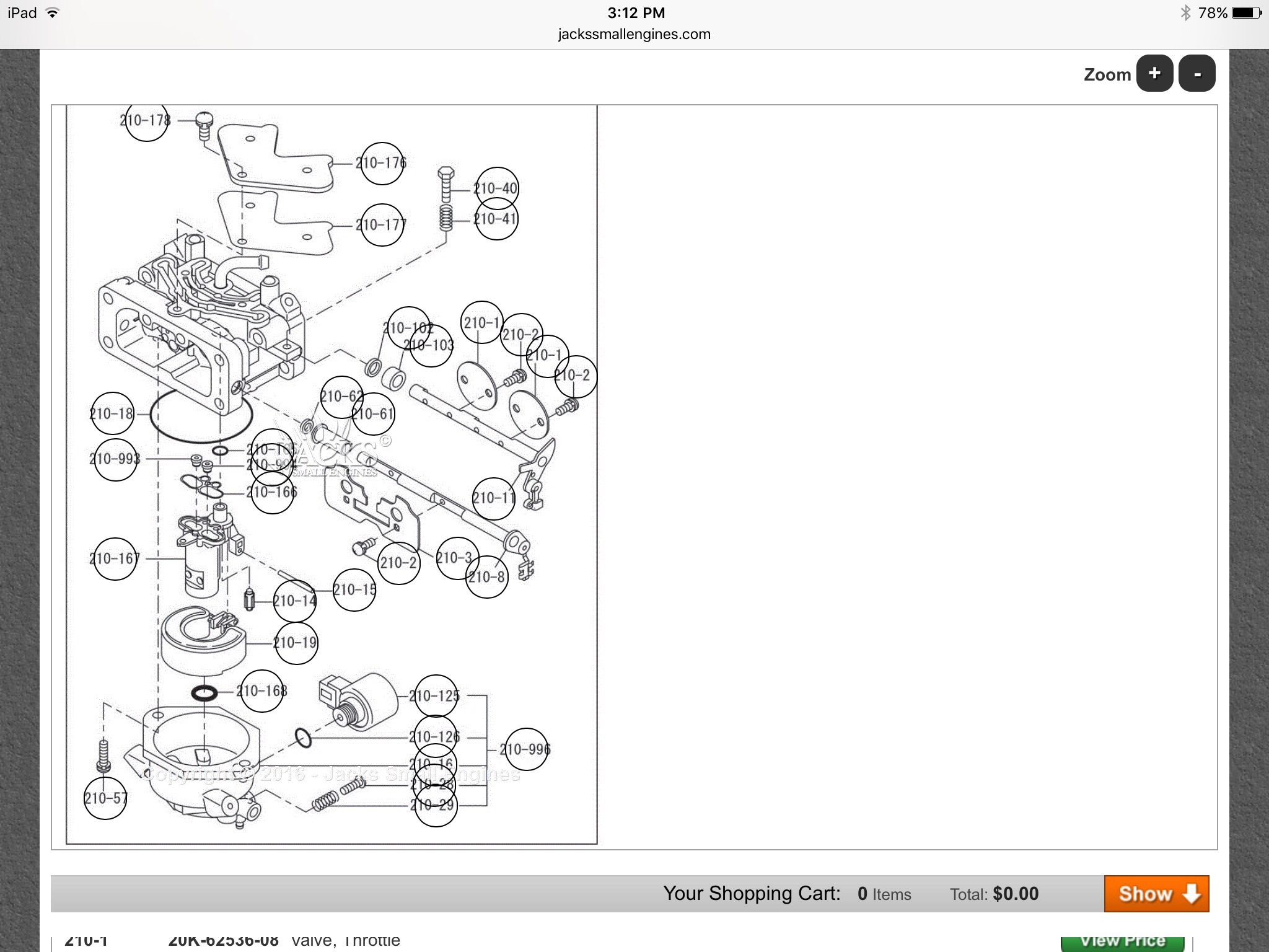

I finally figured out that my carb is not the one posted on Subaru Robin site or the diagram here. It is configured similarly to the EH90/EH99. Only correct diagram I found was on jackssmallengines:
   / the saga continues... PT-425 engine problem at 10 hours? #20
Well now, big help I am.
Seen that carb before but not familiar with it at all.
Maybe Subura decided its a better carb than that overly sensitive thin I'm talking about.
Looks like a guy could drop that float bowl and have a look.
