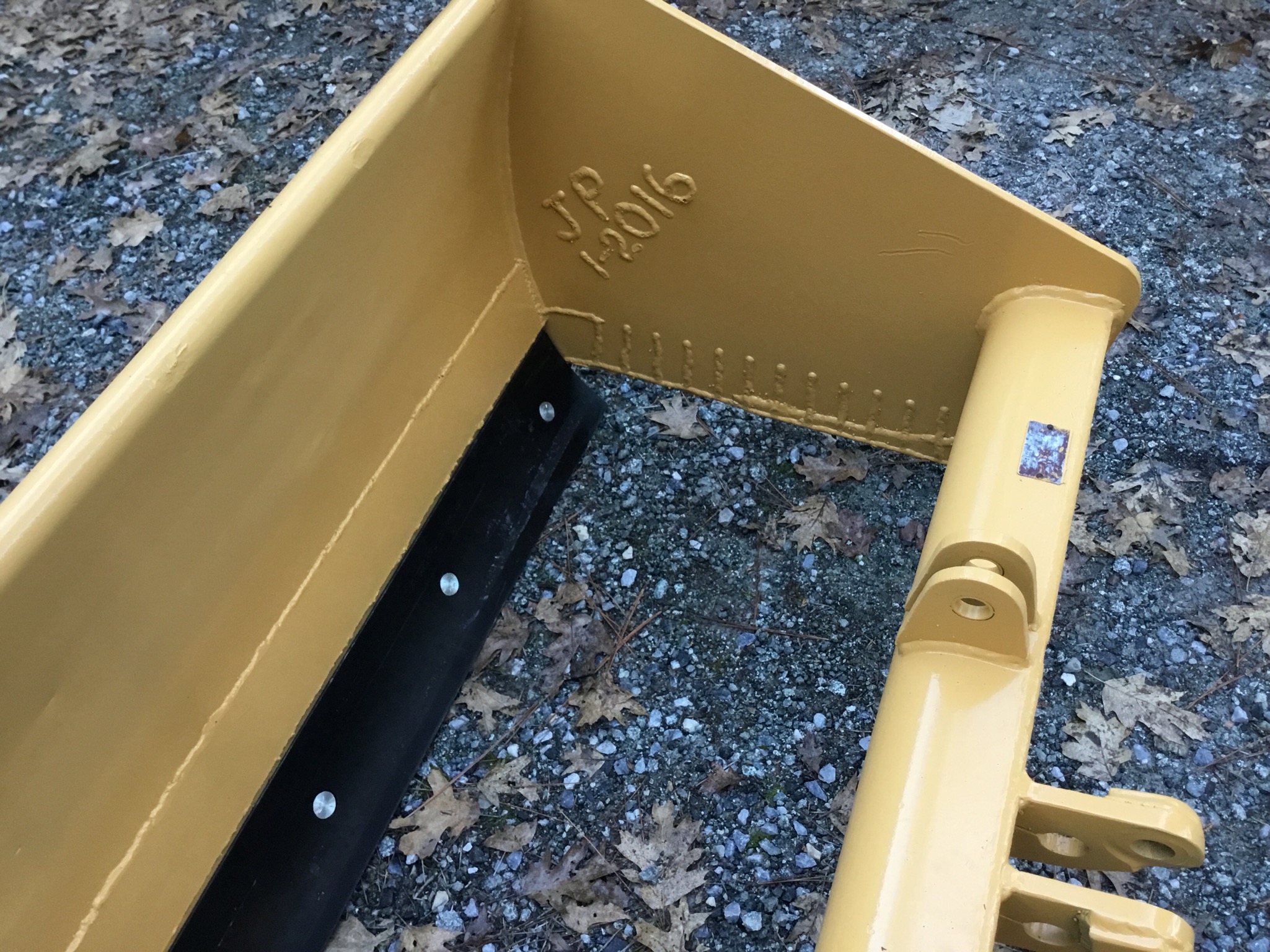

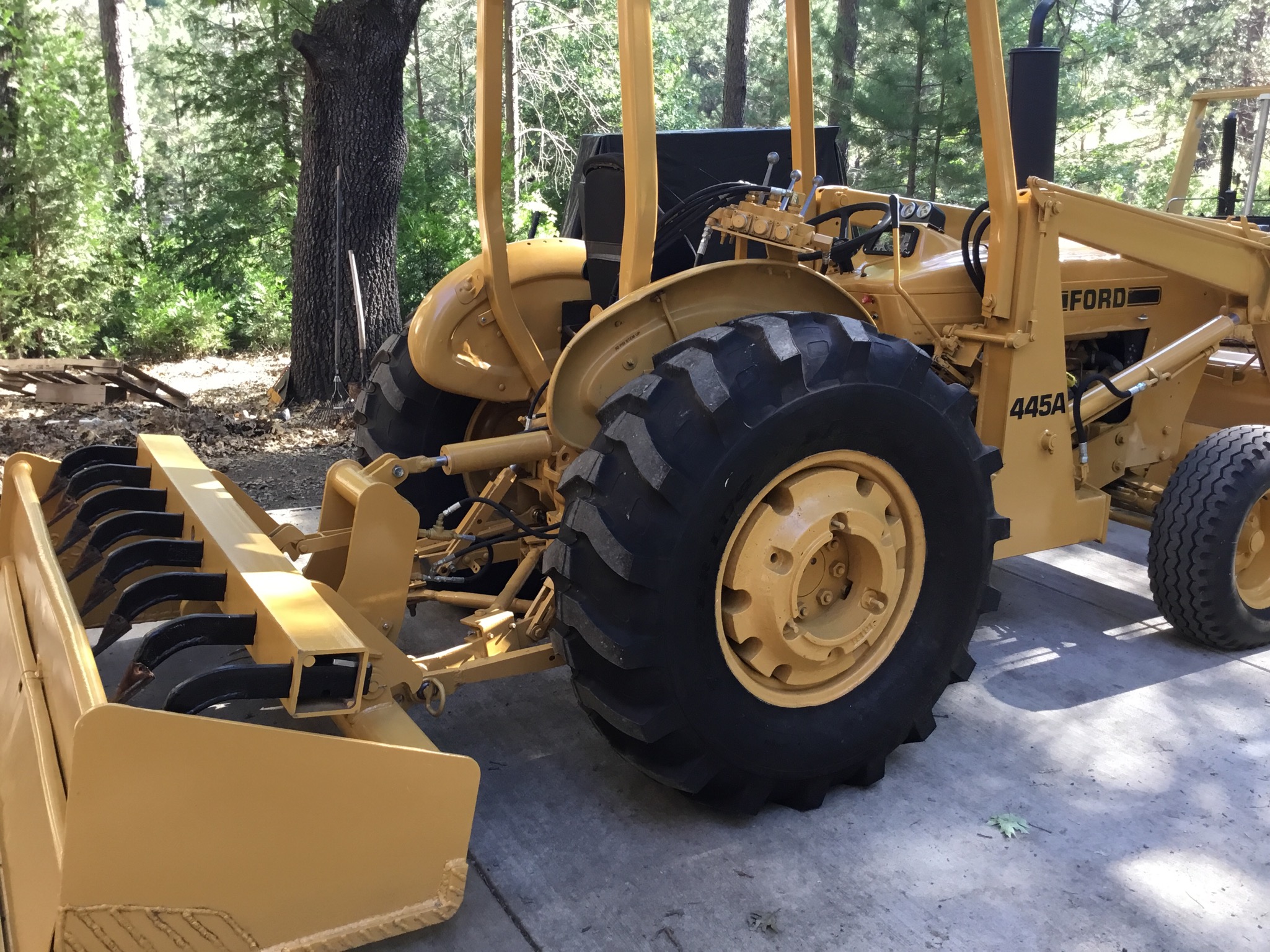

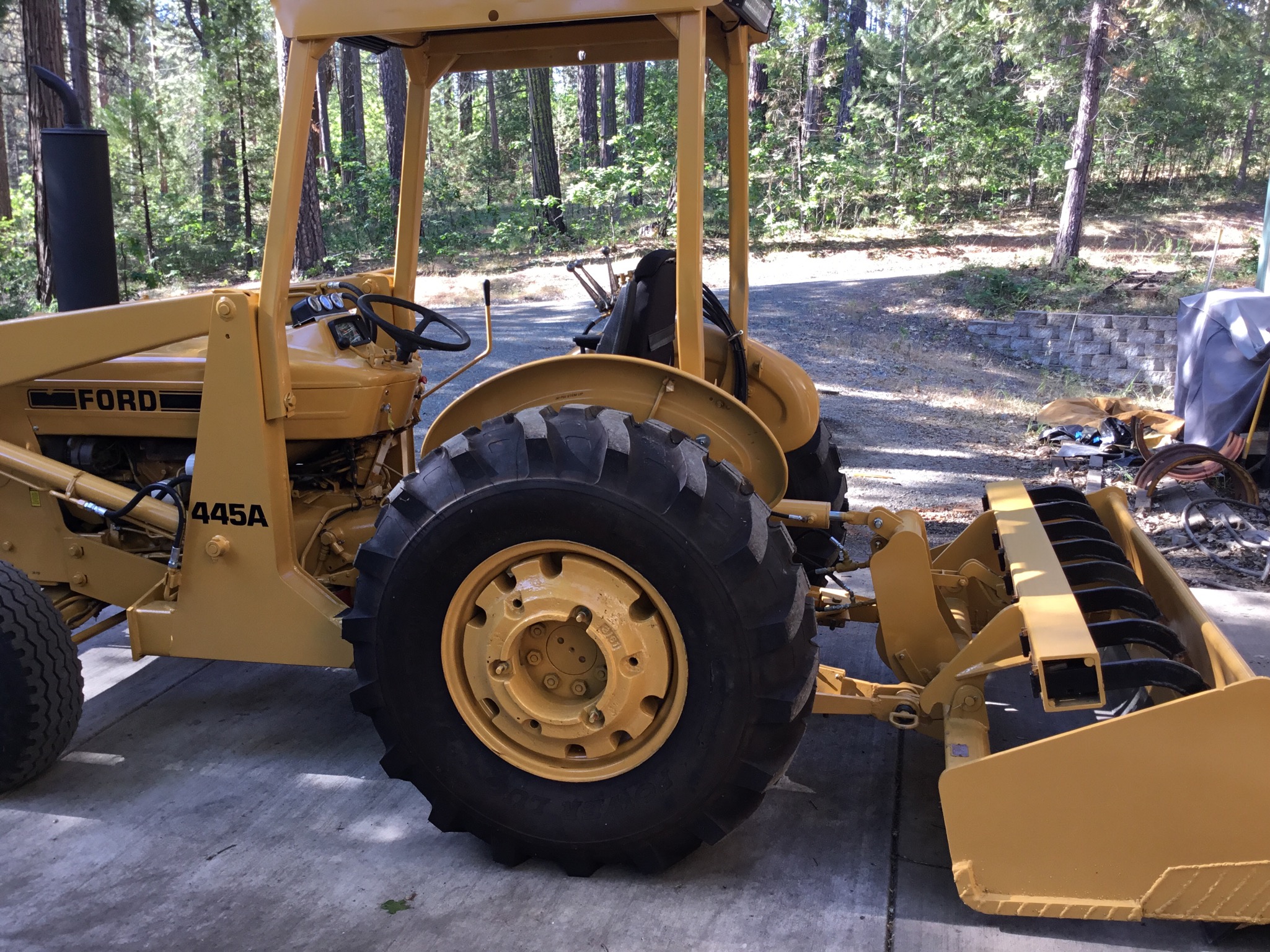

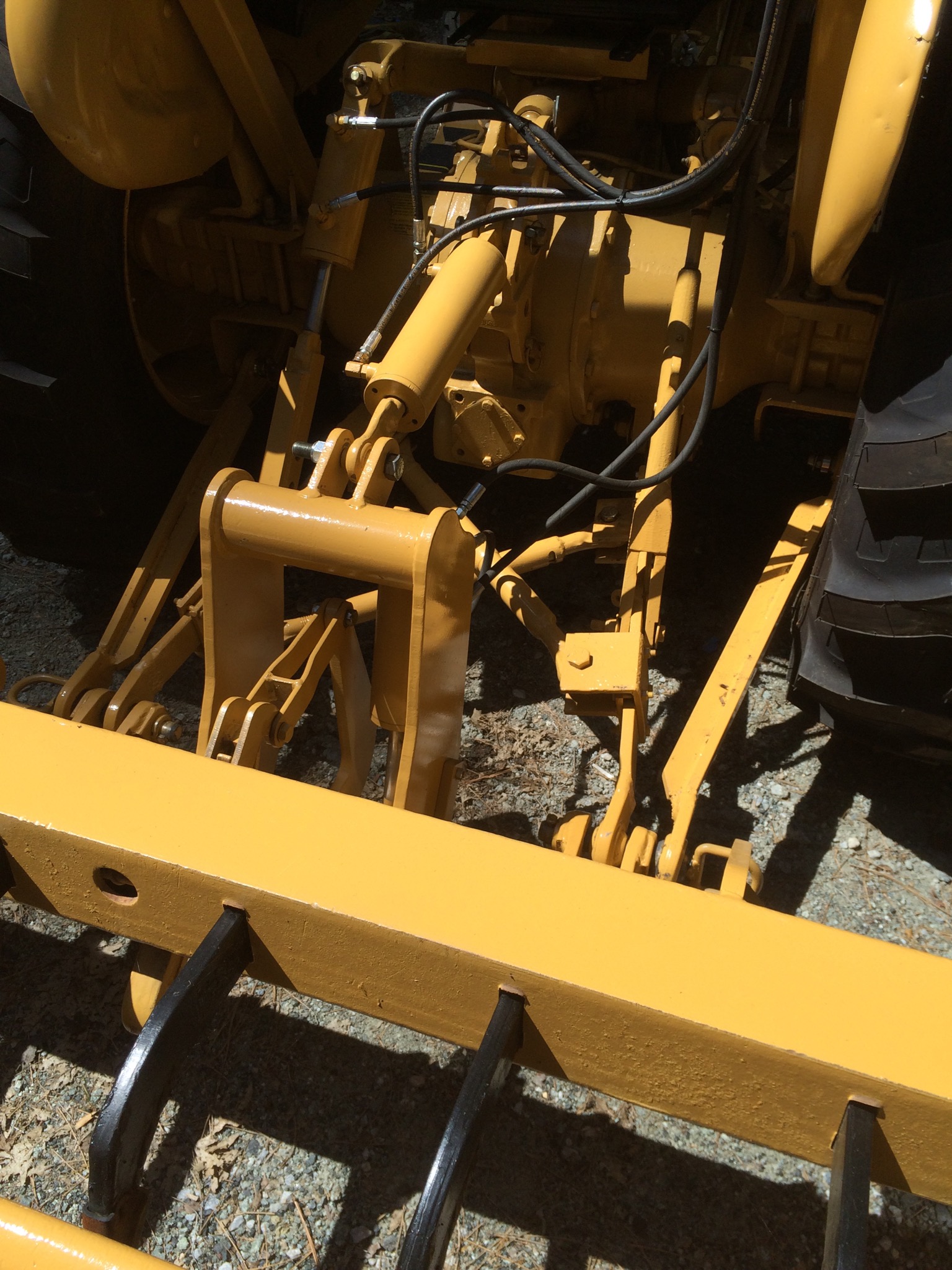

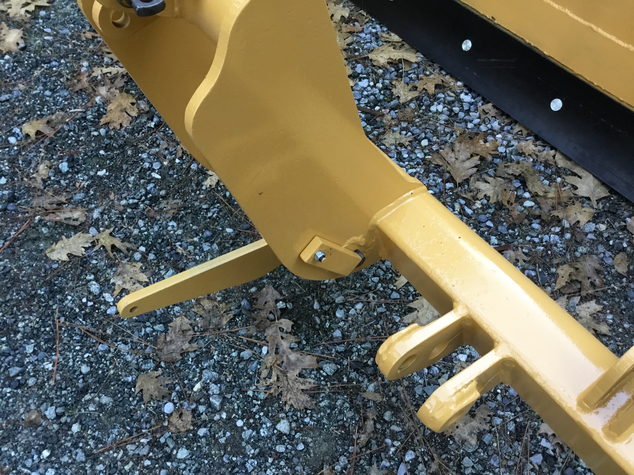

I bought this used 445A to have around the property, I hauled it out from OK. Tractors with hydraulic scraper boxes are hard to find for a decent price. I decided to start at the scraper box and work forward, rebuilding and painting as I went. The box had a lot of loose pin holes and worn pins. I cut out holes that were egged out and made new pieces and welded them back in. I made some custom pins from 4140 steel and added extra bracing on the box. I rebuilt all the cylinders on the tractor (7) and put on all new hoses. The box had a lot of wear on the front edge which is normal, I built it up and hard faced it. These boxes are known for the rippers leaking down and one has to keep raising them up, I installed a holding valve. I doubled the mounting ears also and welded on all new swivel ends.
This rebuild is too much for one post so this is a start with some pictures.

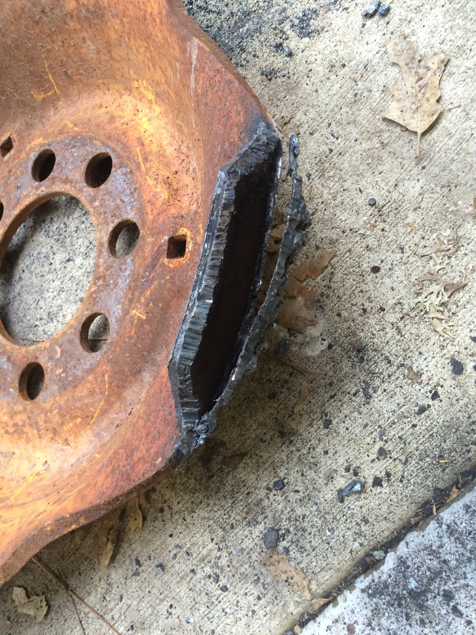

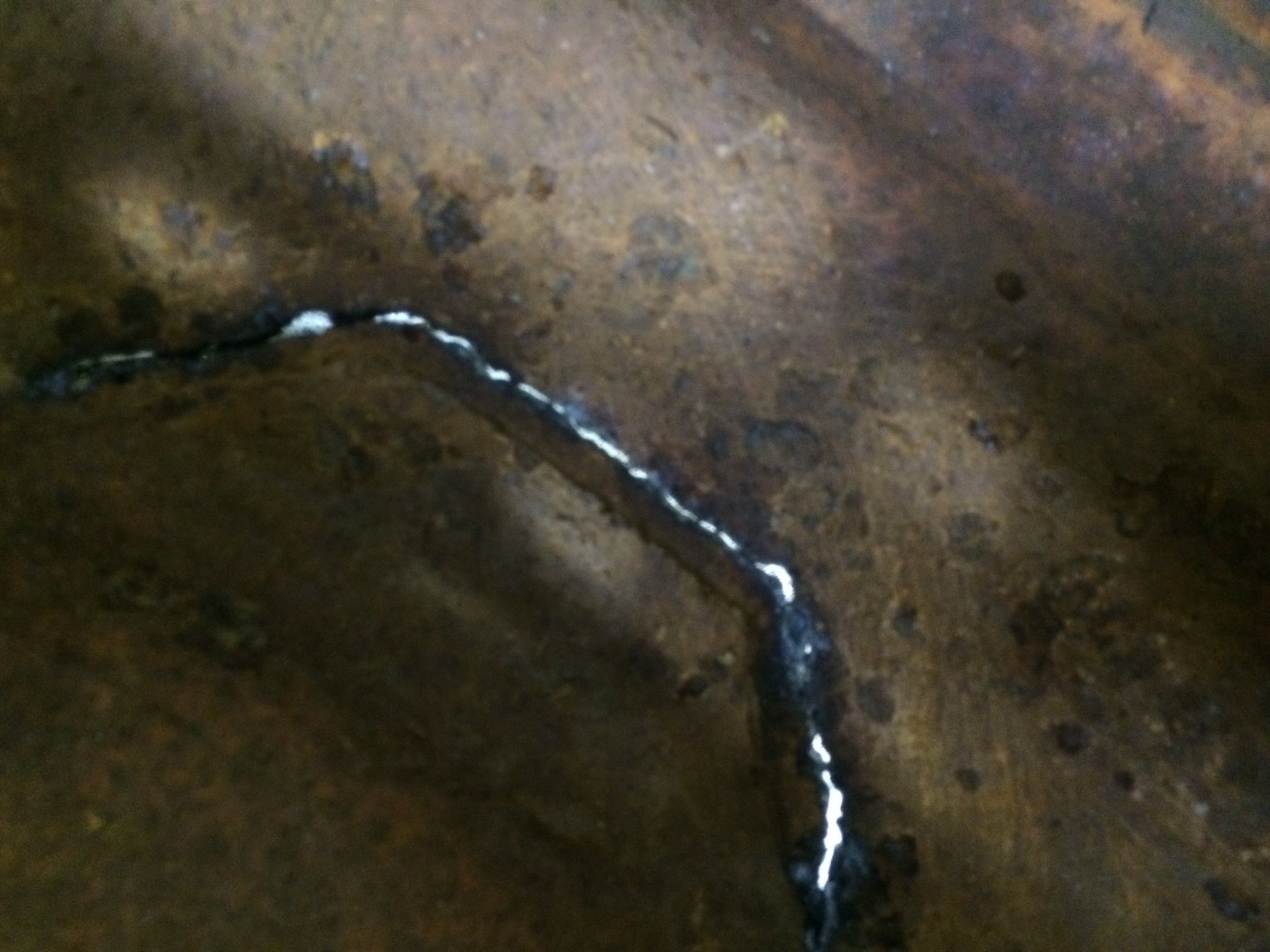

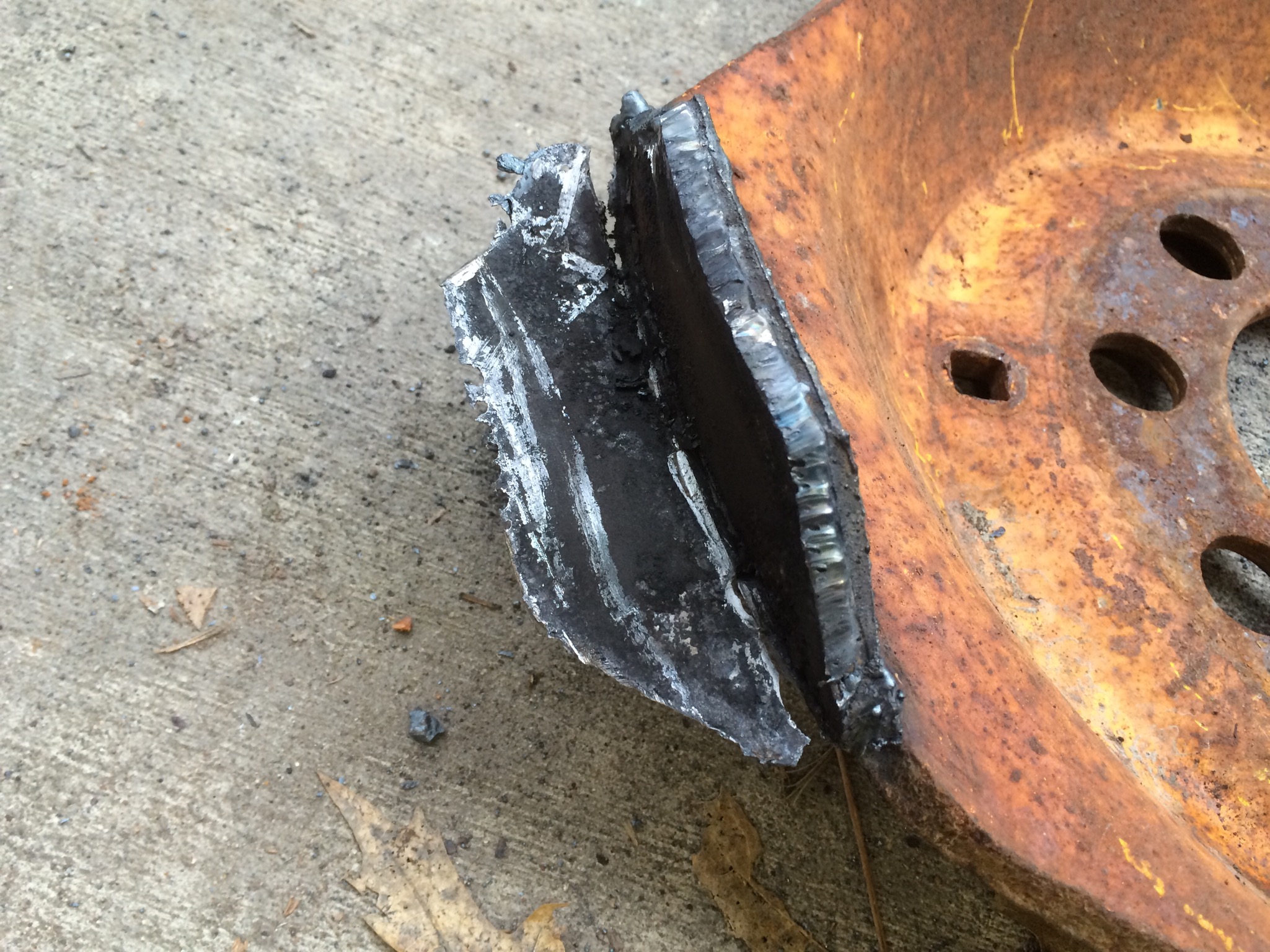

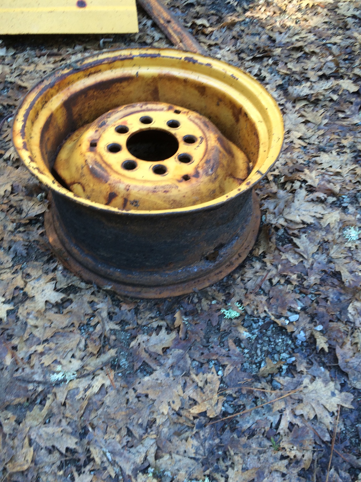

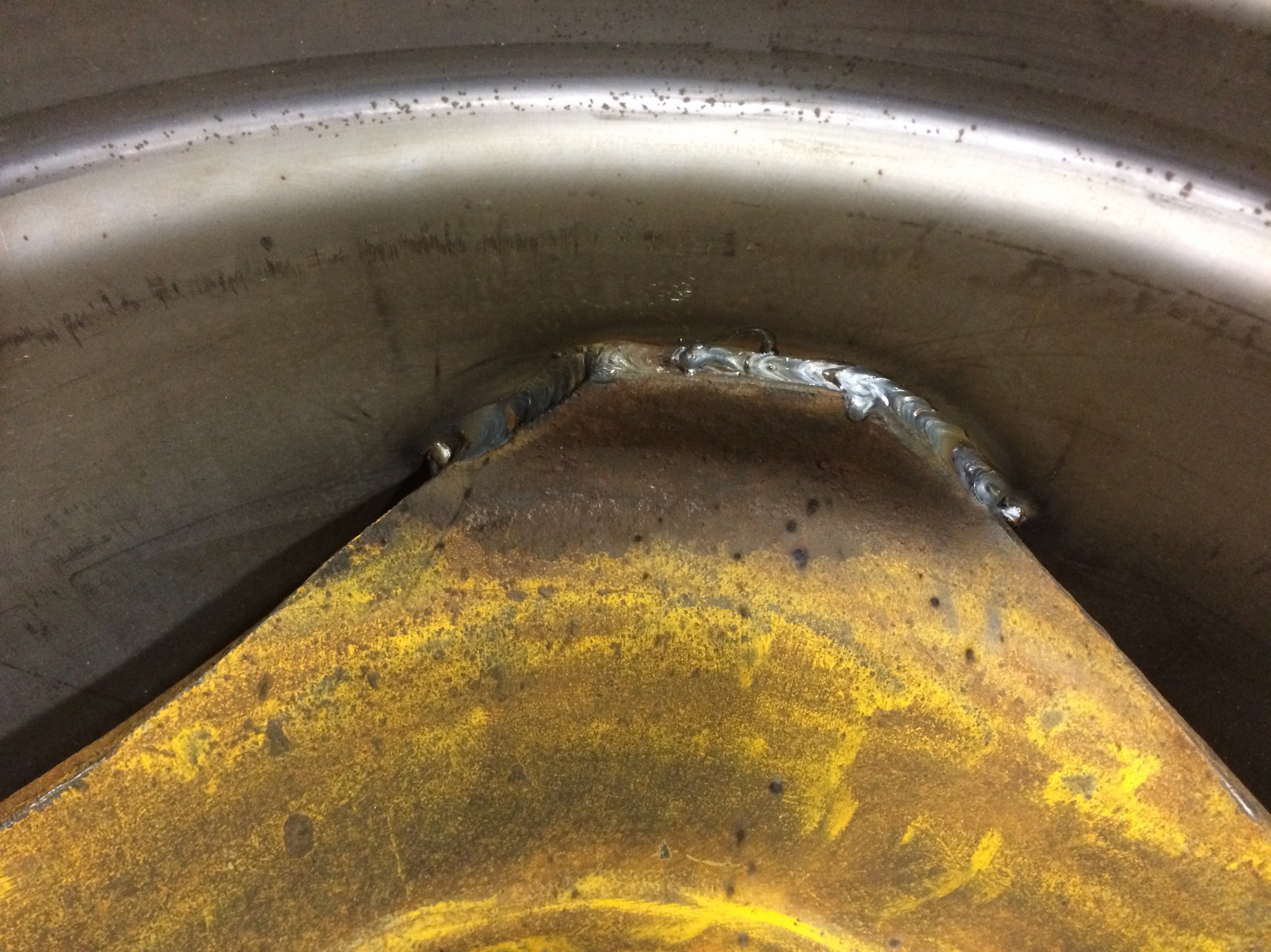

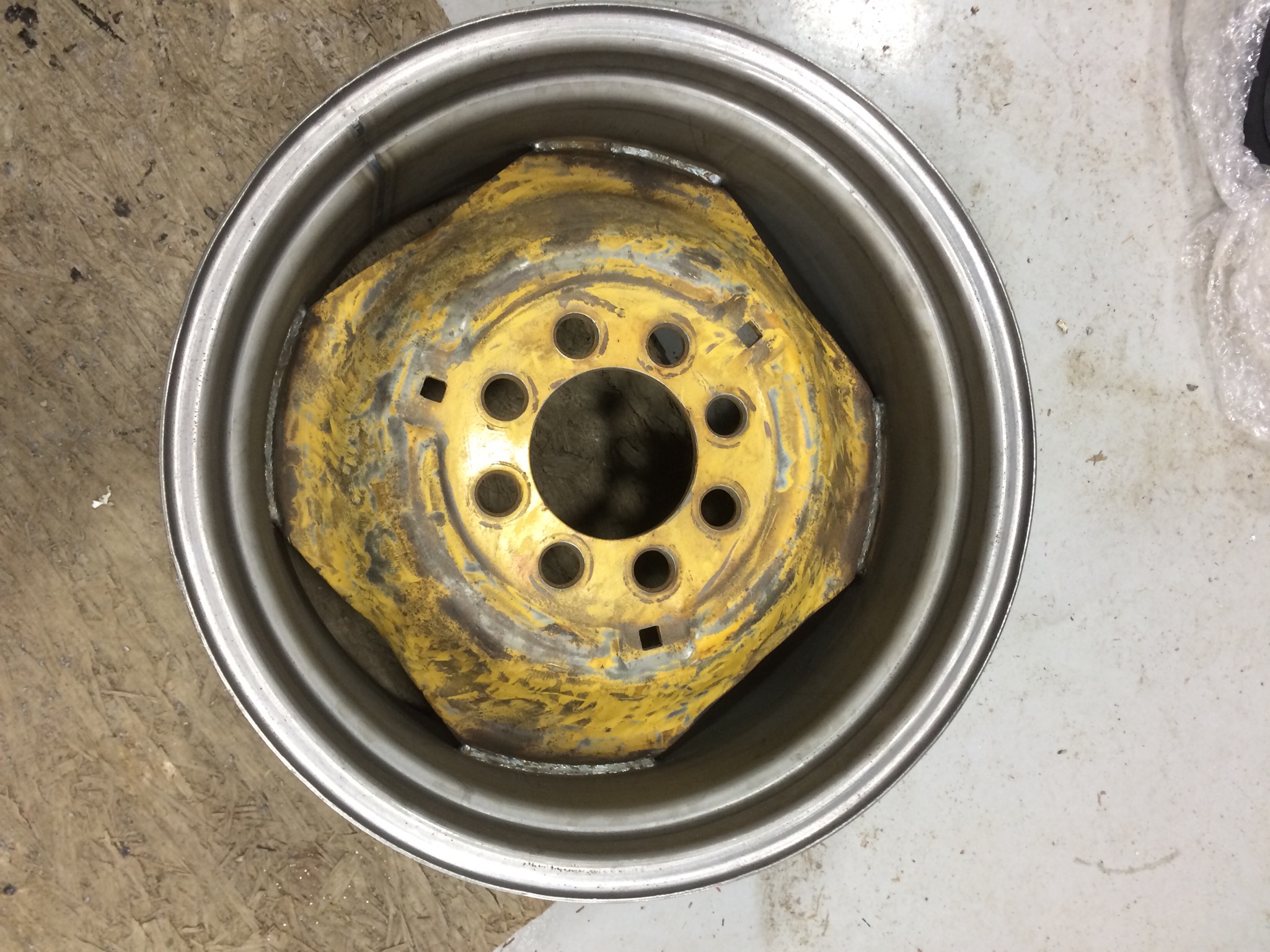

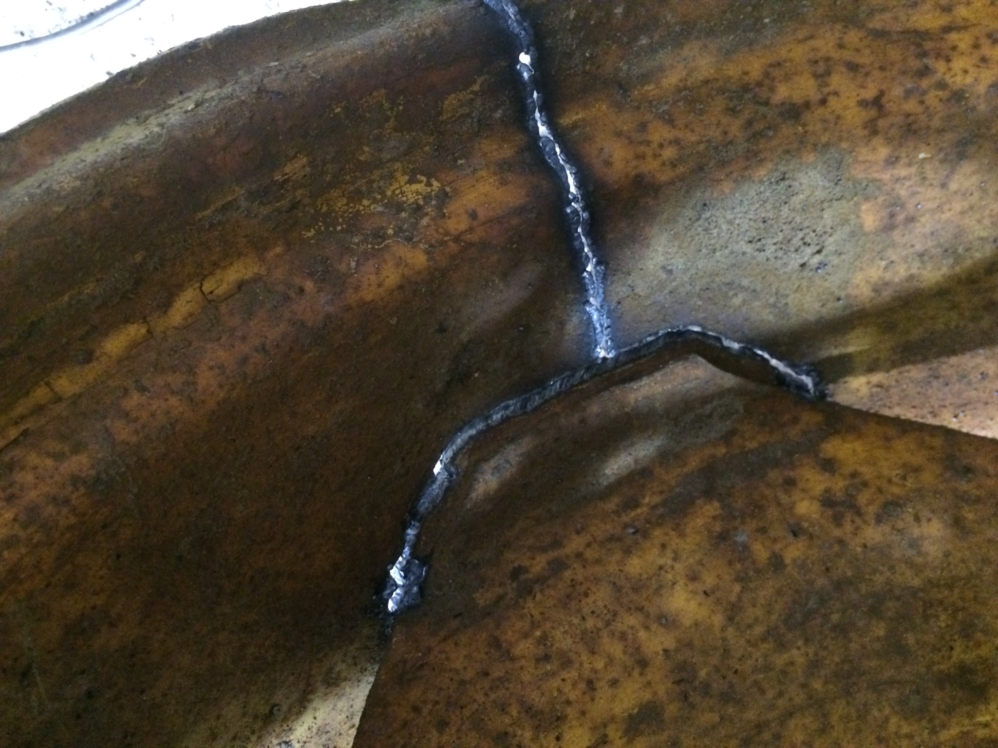

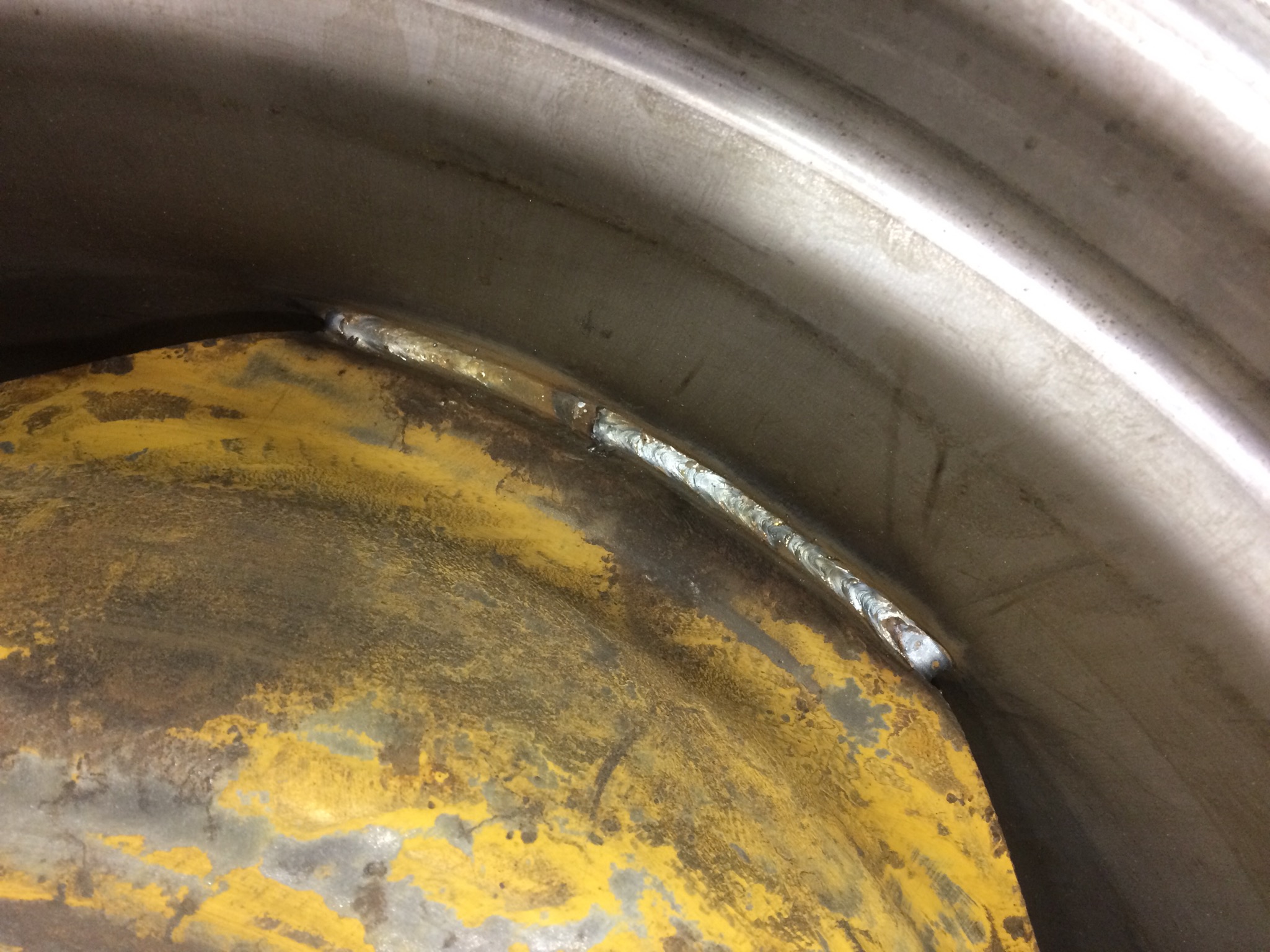

image.jpegimage.jpegimage.jpegimage.jpegOne of things that came up in the restoration was a badly rusted rear wheel. I had put on one new rear tire but the second one was too rusted to save. I found a place that made the rims so I cut the hub out and welded a new rim onto my hub.
The next thing was replacing all the fluids and filters.

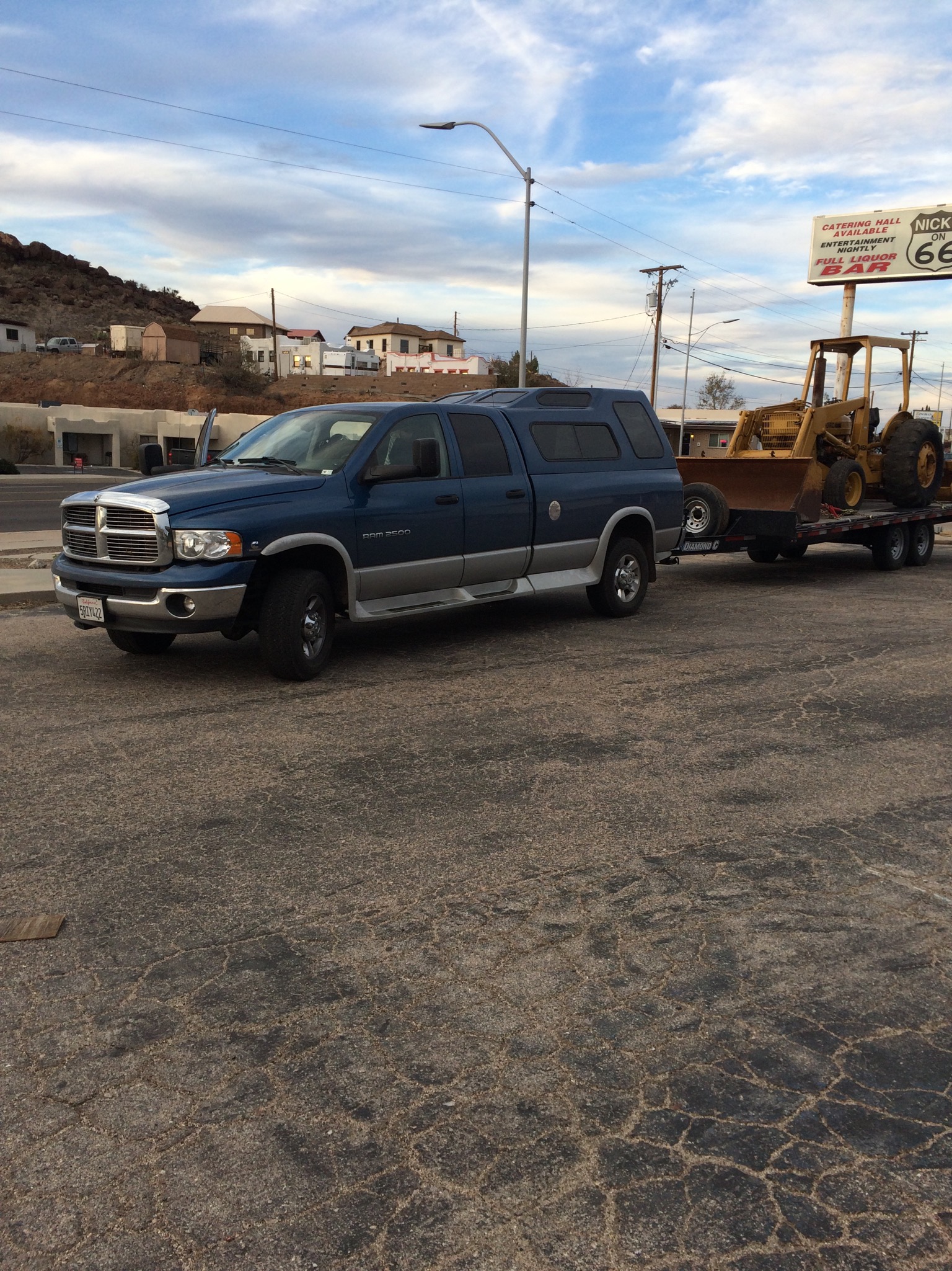

Any "before" pics?
What brand tires did you go with?
   / The restoration of a Ford 445A w/ Gannon Scraper box
I am looking to see if I have any, when I started I was not thinking too much about keeping track, there is the one on my trailer but it doesn't show much. The new post I did shows the old wheel. The rears are Speedways 12 P.R. R-4, the fronts are Regency 10 P.R. I filled the rears with 60 gallons of windshield washer fluid giving me 500 lbs. in each plus the 300 lb. weights.

Is that unusual for these rigs to have the tilt cylinder on the left side, and the diagonal brace links on the 3- point arms? Looks ready for tough work. Nice updates!
Jim
I have seen them with tilt cylinder on the right also. I looked at it closely when I was building it and the geometry was the same either way. I braced instead of the chains because
I don't like sideplay when I am next to curbs, fences and the like.
