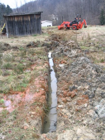

The backhoe on the BX23 is amazingly strong for its size. It should do all you want on 8 lots. I use mine on 20 acres and its done all i've needed. It will dig in places bigger hoes won't.

I have had my BX22 for almost two years. It has 290 hours on it. I do not think you will have any problems digging in LA. I do have trouble somtimes just because the ground out here is very hard. Actually the back hoe is stronger than the tractor and if the ground is too hard to dig it will drag the tractor rather than dig. I do not think you will have that problem once you learn how big a bite you can take with the bucket. The loader will only lift around 600 lbs. I think it is limited by the factory to keep people from lifting so much the tractor comes off of the ground. It might not lift your big tree stumps /logs but it will push or drag them. I have dug about 1000 ft of trench with mine. It is slow but beats going and renting and returning a larger machine plus I can dig when I want to for as long or short a time as I want. If you are going to dig much with the loader i suggest that you try to get a tooth bar with the deal.
