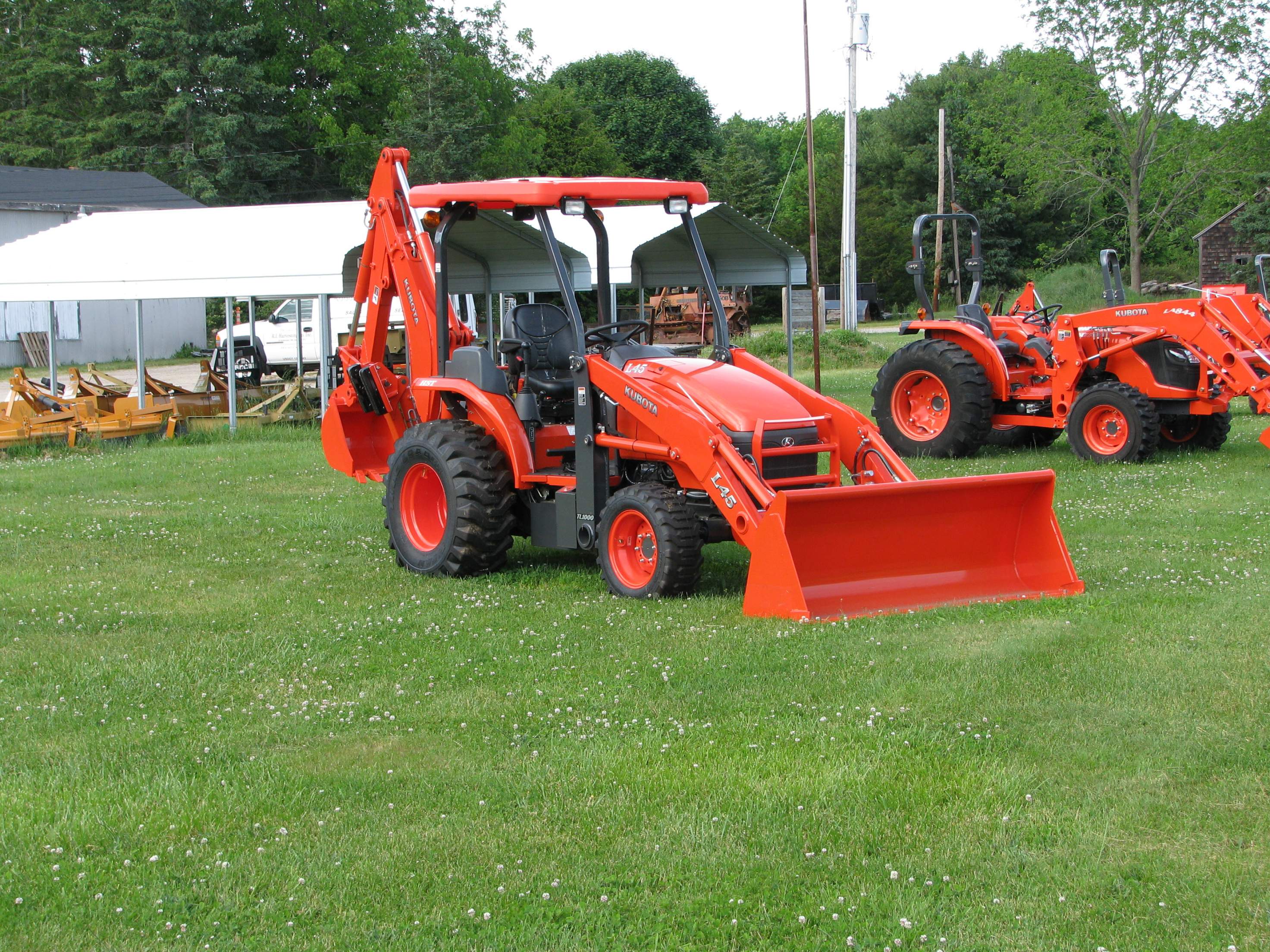

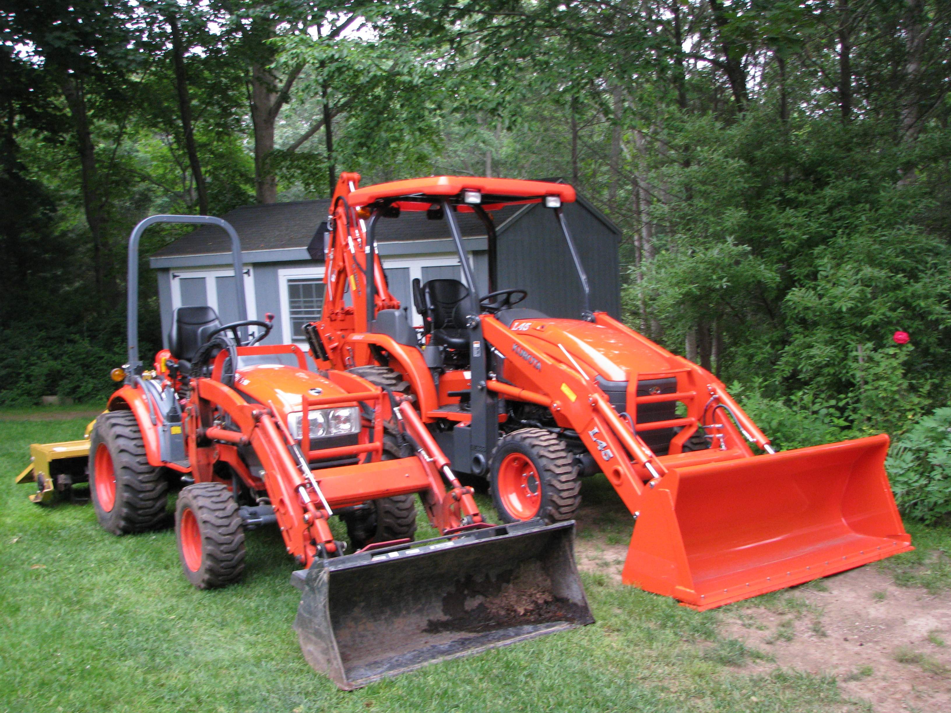

Well I have had the new tractor for a few weeks now and really like it. When ever I put that monster on my 18' beaver tail 10,0000 pound trailer the day i picked it up, I said to myself what the heck did i just buy, am I crazy??. Then I get it home and drive it into the driveway and it takes up the hole width, and i said to myself yup I think I may have over did it this time.
But as I was hoping once I got it up and in the yard and looked at it, and drove it for a couple days I got very comfortable with it, and it actually seems more stable than my CK20 Kioti. Love all the features on it very very nice, The creeping function is so nice to have, so you don't have to keep turning around to move up or back up, when useing the backhoe. The hydro thumb is just amazing and so useful as I new it would be. I bought the tool box, and the drawbar hitch for it. Got the tool box on, but not the draw bar hitch yet. The only real complaint that i have is that no where in the book does it say what points to use to tie it down, or at least i have not found it in the book yet. The dealer said that it did not qualify as a four point tie down, but I use four points even on the little Kioti when I trailer it, just seems so much more solid and stable. You can see where it was tied down when it was delivered to the dealer, they had one trough the tube on the loader and one over the back of the back hoe. I just don't like the idea of that way. To me it could still shift side to side if I were ever in an accident. I work for the local town highway dept, and have gone trough the DMV testing to get my class b licence and then a couple years ago to get my A licence. Seems most of those DOT inspectors are a-holes. You do find a fair one here and there. So anyways I want to do over kill tying it down so there are no issues with them, but probably no matter how I do it they will find something to get me on. Also I do not understand why kubota does not have loops on it to tie it down, especially being a construction model, you would think they would assume it would be getting hauled all the time. I saw a pic on here when someone had gotten a M 59, and it looked like they had tie down loops on that model. So anyway I plan to tie down on each side of the brush guard and on each side of where the stabilizers pin on to the back hoe frame, I may also do one over each the back hoe and front bucket.
