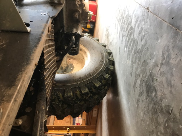

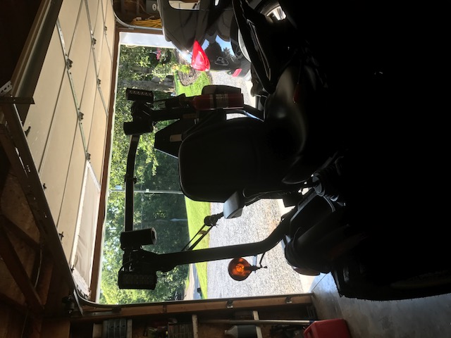

I added D rings on the front frame and top of the FEL. i use them all the time. I also added LED lights on the ROPS pointing front and back as the headlights reflect off the bucket at night. Consider adding a piece of expanded metal to the under carriage to protect the plastic fan cooling the hydro pump.
Thanks! I'd love to see some pictures of your D-rings and lights. I had the dealer install the stock ROPS worklights, but that was admittedly more for the wiring than the lights themselves. I'm thinking I need to get some LED's as you say. Thanks for the tip about protecting the undercarriage.

IMG_0450.JPGIMG_0452.JPGIMG_0455.JPGVeRV77 here are some quick pics.
I added the lights to the ROPS in the down position as I have a garage with a 7' height and a flat property. One set point forward and other side point back and all are adjustable.

VeRV77, I bought them from Harbor Freight. link: 1/2 in. Forged Cargo D-Ring Anchor
I like D-Rings vs bolt on hooks as I double back the chain to adjust the length (hook the chain to itself).
Securing the expanded metal with more screws today. On my first project with the tractor I was using a middle buster to pull up some old drain tile, it bundled up and as luck would have it found the fan blades and ripped them all off before I had the chance to know what was going on. rather than splitting the tractor to replace the fan I split the new fan in half, glued and screwed it in place and then laced single strand copper wire around each fin to hold it in place. 180 hours later and no issues.

If your ever planning to work it in the woods I would definitely do something to protect that Hyd filter it is just asking to be sheared off in the position near the rear tire.

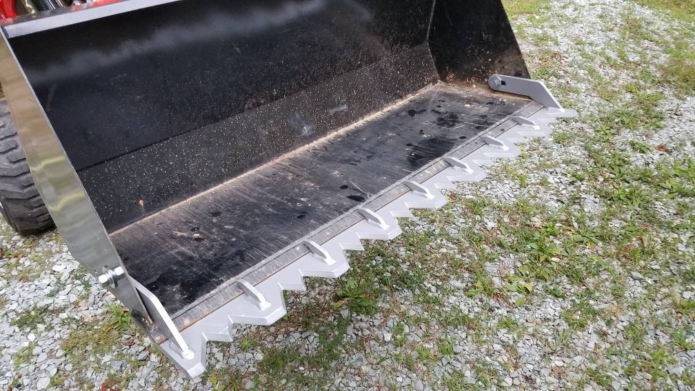

I'm going to take the advice and put some expanded metal on to protect the fan and filter. My first addition was a piranha tooth bar, just added the other day. I was kind of surprised by how much easier it was to fill a bucket when digging with this thing.
