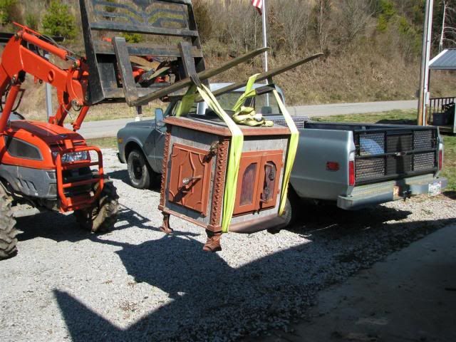

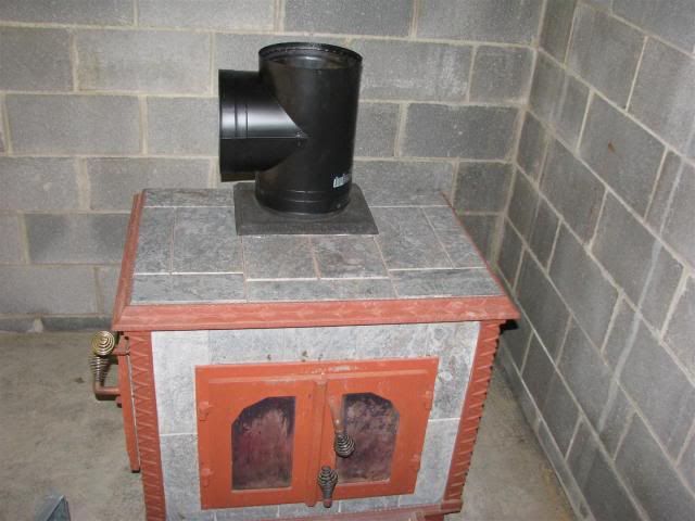

So, no rain today. I disconnected my big stove, slung it on the forks and transported it up to the basement:

I have it in the corner of the basement. I had initially planned on running the flue up behind the stove than 90 degree-ing up to it. I was playing around and was wondering why I could not just put the "T" on top of the stove? For clean out, I can just stuff something(rag) into the side of the "T", brush the flue, vacuum out the creosote, then pull out the rag.
Opinions?

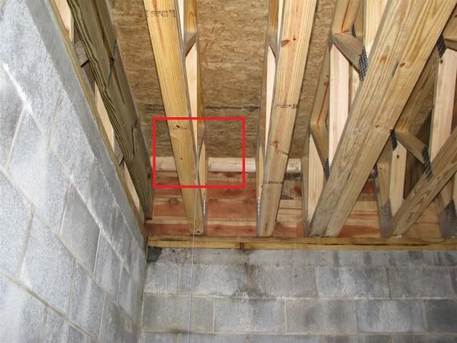

I emailed the stove guy I bought all the fittings from. He said that there is no problem with putting a clean out "T" right on top of the stove. It won't look as cool as a 90, but the "T" is way more accessible than if I ran it behind the stove, so I think I am going to go ahead and start cutting the main floor. Also, a straight run flue with no turns is always better than anything else as far as draft goes.
I have to cut away a section of one of the floor trusses, then reinforce it, so more pic's to follow. The area that gets cut is outlined in red:

Motor Seven - Instead of the "T" right on top of the stove why not a draft balancer? I have one on my stoker stove and on windy days you can hear it closing due to the wind blowing across the top of the chimney. Technically you can use it to clean just by disconncting the flapper. I'm just sayin'. More 2¢. :)

PA, I'll look at that, do you have a picture of one?
One of the sections of the pipe I am using is a section of extendable Duravent DVL 48- 68" pipe. I had a suggestion on the Hearth forum to use that on top of the stove. To clean, just slide the pipe up, stick a bucket under it, brush, then remove the bucket.

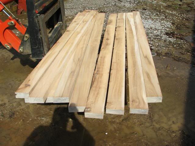

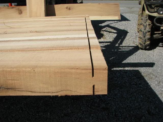

While waiting for the glass, I decided to start on the front door build. Opening is 80"x42". I had Hickory stash that had been in the shed for about a year:

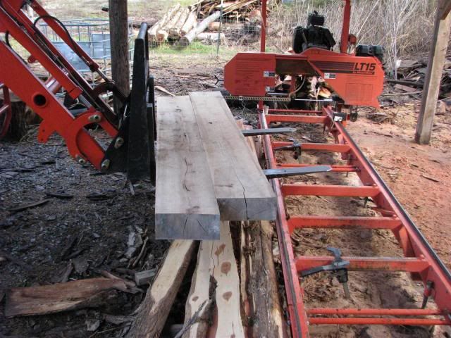

On the mill:
I milled the boards at 8/4:

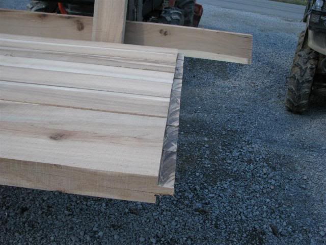

I checked the moisture and it was between 14 and 15...ok for air dried, but it really needs to be down around 8 or I will experience "shrinkage" It should be minimal, so I am going to try and plan for it.

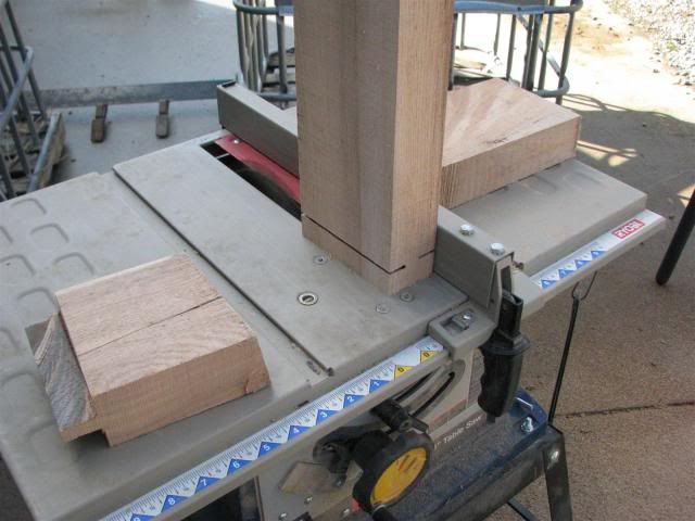

I cut them to length, then made a tongue:
