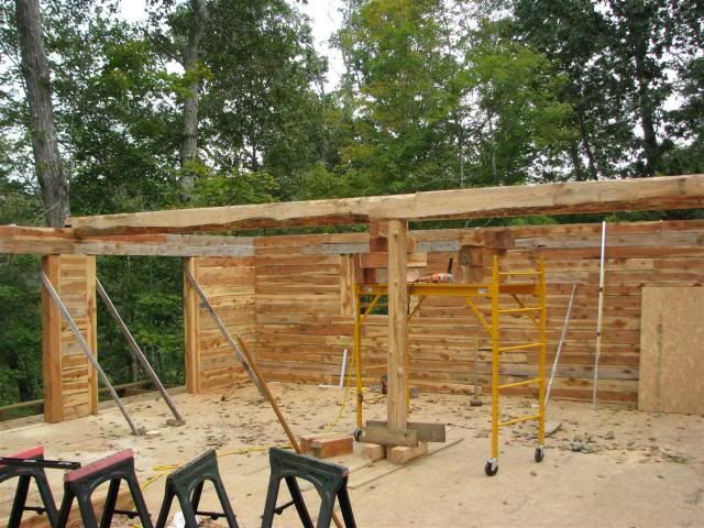

I got the Loft Beam up today and another row of logs. Someone{cough} mis-measured the notch so we had to take one side back down and re-cut it. Thank goodness it was measured wrong on the fat side:laughing:
Anyway, tomorrow I am cutting Poplars for the tie poles and peeling them. Once they are up I have only the last row of logs to go and the walls are done:thumbsup:
Beam up/two rows to go this morning:
Yes, I did put a 12' 6x6 pole down in the basement under this pole to support the weight.

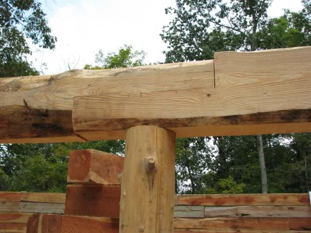

Temp base for the support pole(Poplar):
The top pic shows the metal strap that reinforces the beam, it goes around the beam and will be hidden in the wall.

#359
I have to brag a little. Keep in mind every log is a little different, most 6 to 6-1/8" wide on one side and up to 6-3/16's on the other. Before we set the loft beam it I measured around the house from the sub-floor up...it was all within 1/4". My other log house did not turn out that way and the last course of logs were off by over 1" in places. The last course of logs had to be fitted without spiking them down, a measurment taken up each corner and a line popped all the way around the inside of the house that was level. Then all the logs were taken down, loaded on a trailer and taken to the mill where they were milled on the line. Once back up the wall height was perfect. I was kinda expecting to do this on this house, so far so good.
