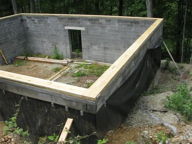

Double sill plate completed:
Floor trusses are enroute today.......!

Hey, you have weeds growing in your basement. The local sheriff takes issue with that.
Wait... That's only if you have weed growing. Nevermind. I think you'll be fine.
   / The Log house Project begins........
#213
That there is two years worth of weeds.....

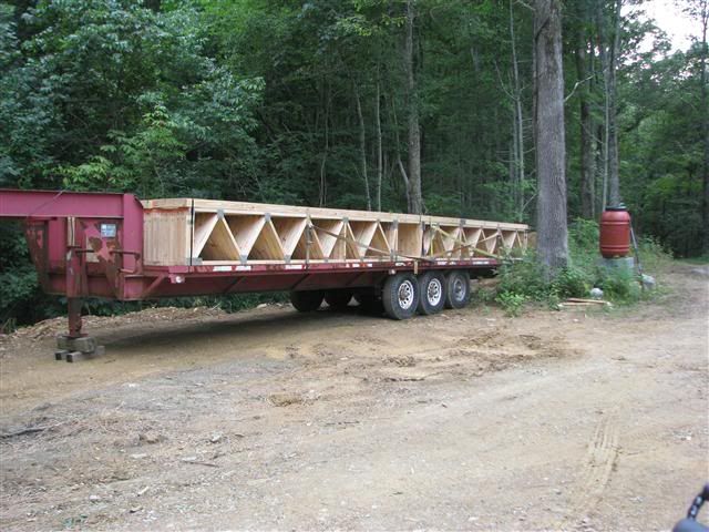

Trusses are on site:
The truck driver just called and we pick up the logs tomorrow.....all 33,000 lbs worth.

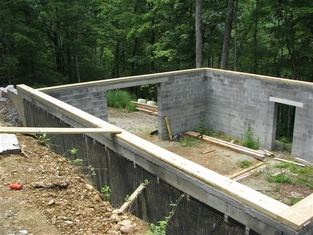

Lookin good. I cannot see the bow on the back wall with the sills on.
I don't know what your plans are for the interior block walls but consider thoroughseal on them . Works great
#217
It's still there, although it can only whisper at me instead of yell like it was before;)

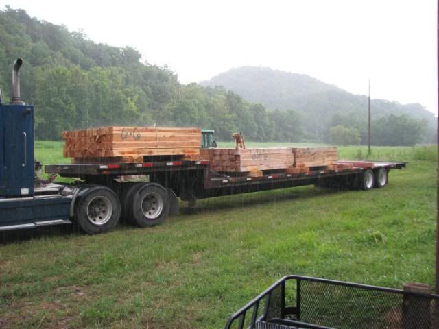

LOGS:
Grant Cedar Mill was a pretty big well run operation. They are buying cedar for $75 a ton & I watched them unload 4 trucks while I was there. They are cutting cedar into ever size imaginable and their prices are very reasonable for the quality cedar they sell. My logs looked real good. Checking them with a tape measure they were all within a 16'th of an inch- 6 1/8 X 6 1/8 x 8'.
#219
One bundle of 28 logs was all that my neighbors 65 horse JD wanted:
Now I will shuttle them up to the house site on the Kioti forks....20 at a time. I am going to drag the bathroom scale out today and weigh a couple of the logs...I am guessing they are more in the 80lb range than 110lbs.
#220
As soon as the truck pulled in to unload my logs it started raining....:
