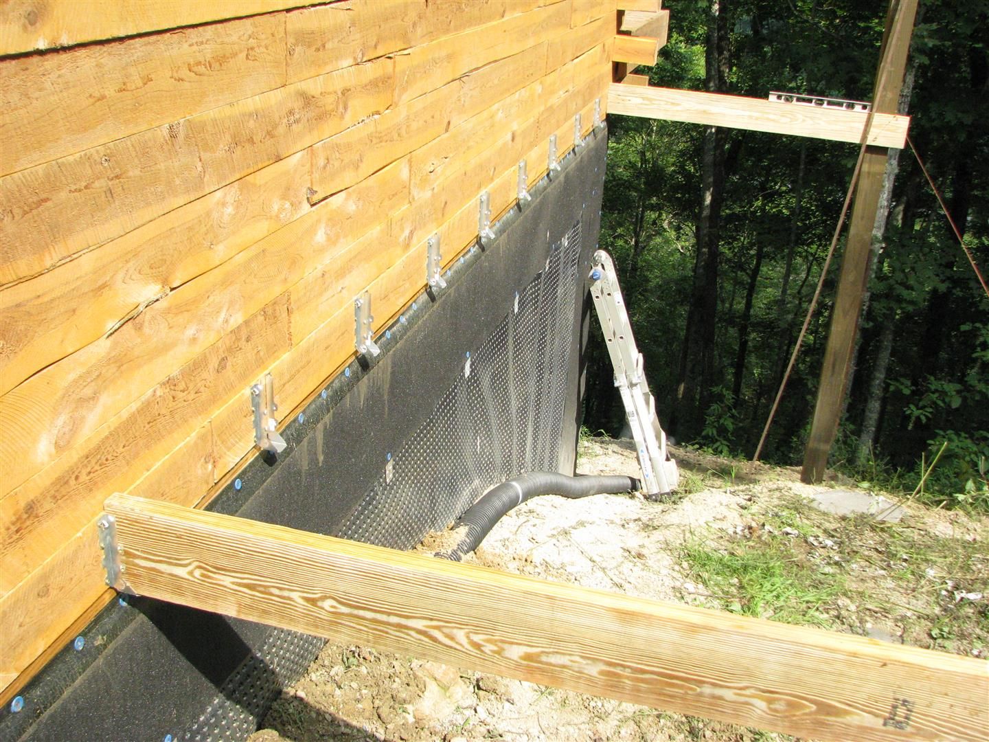

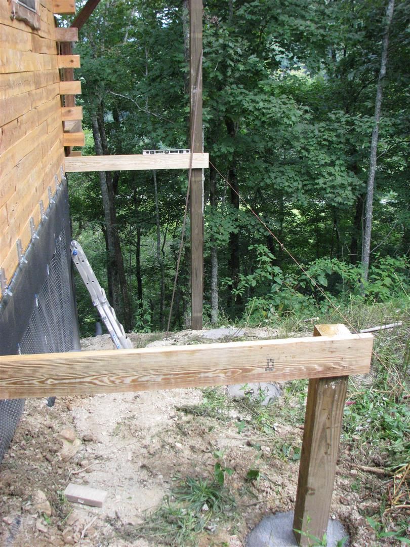

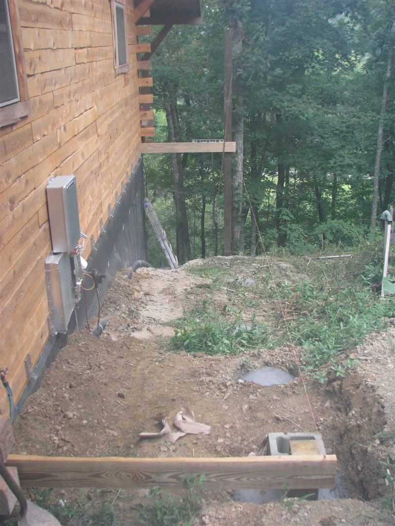

A quick update. I needed to get scaffolding up on the East side to pressure wash, then re-seal the gable & logs. Hard to do with a very uneven ground sloping from level to a 12' drop in 30'. The solution was to build a deck, so I opted for a six footer. U usually don't like 6' wide decks because they are just too small to have a table and chair, but since we already have plenty of larger decks I figure this is ok.
I know many will cringe, but the fill dirt on this side has only settled for less then a year. So, I dug 2' in diameter x 1.5' deep bowl shaped holes which I filled with concrete. The 6x6 post will sit right on top of the 'crete. I know this will continue to settle for at least a couple of years, so this way I can jack up the deck and place shims under the posts. I dug the holes and poured 'crete yesterday, then completed 30' of deck today. The end post is 6x6x16' tall(& wet) and was a bear to get in place by myself.
the two ends are up and string line set:

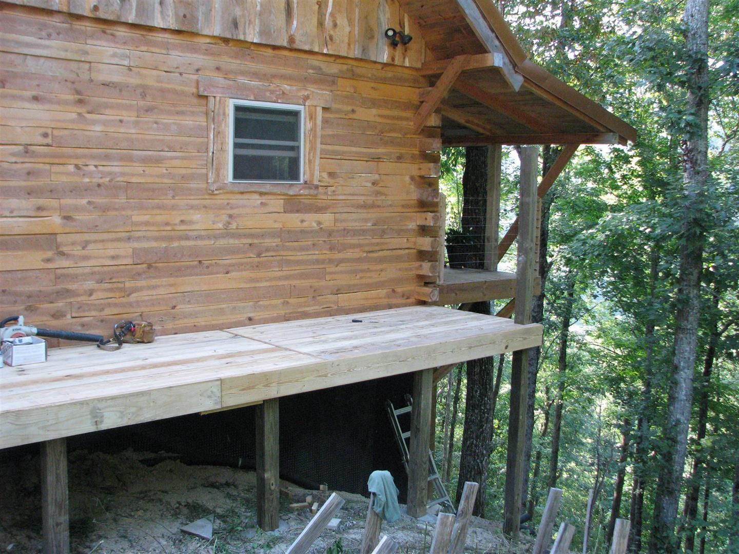

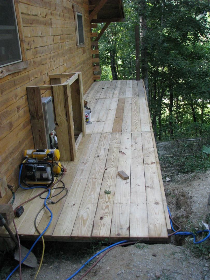

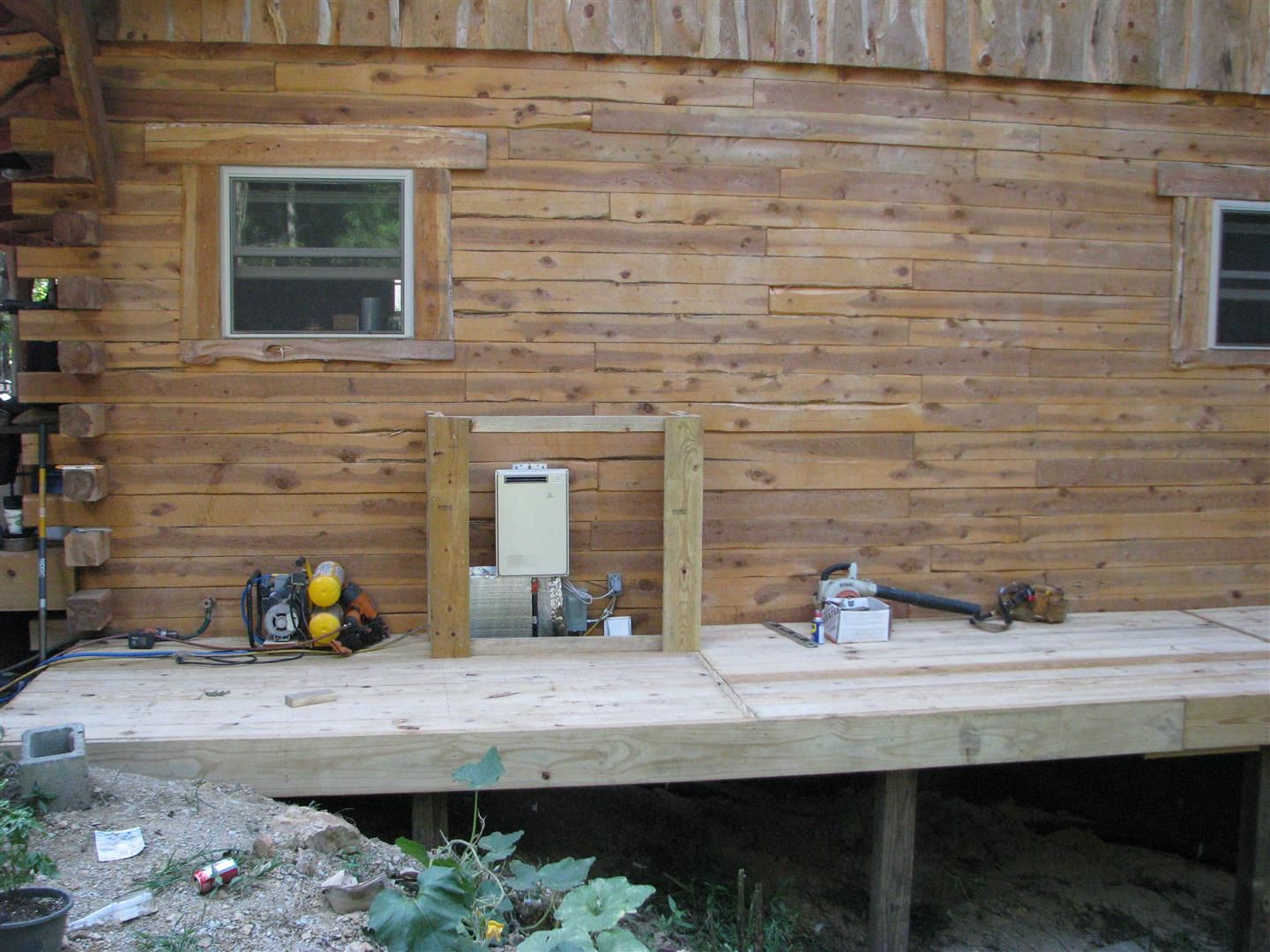

And the deck appears:
I am building a hinged cover for the propane regulator and instant hot water heater. This deck is lower than both the rear & front, so there will be a step down to it. Eventually I will ad a two landing stair case to get to the rear basement walk out door, and a platform for the hot tub.
Next is insulating the two exposed basement walls and stucco-ing them.....more to follow.
