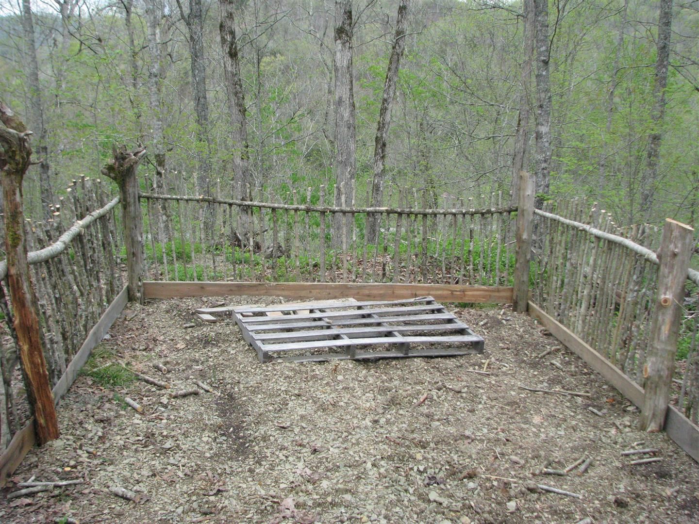

Crap...thanks Obed....the shelves are up but the War Dept has been requesting a set of shelves at the end of the closet in the center. Working on a fence around her garden right now....all free from the land. Cedar posts, 2-3" diameter trees for the rail, then about a million 1" diameter sticks for the balusters. I got the idea from my In-laws in Canada who built a really cool stick fence around the garden to defeat the deer...it works!

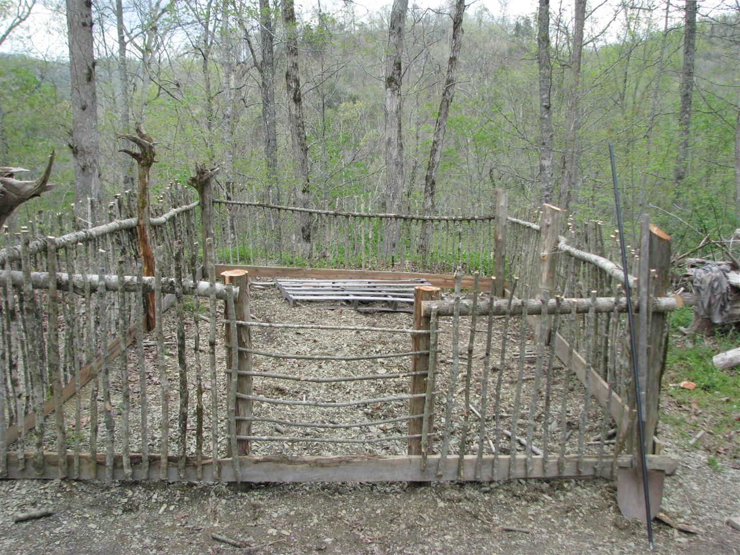

RR. here ya go.......

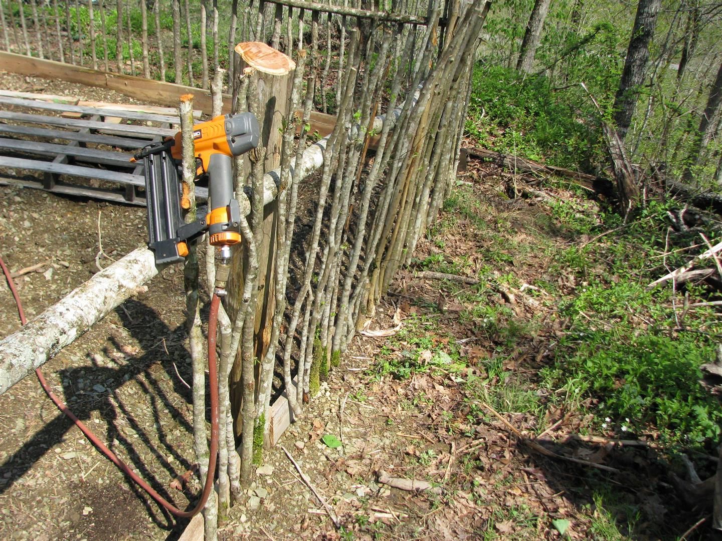

Partially done;
I used 2" finish nails to attach the sticks:

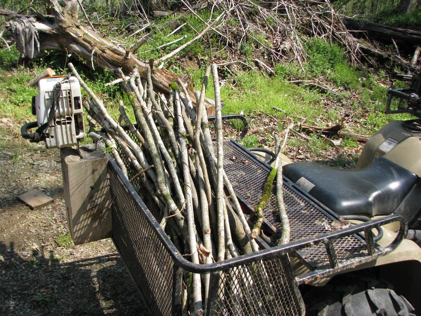

A load of sticks:

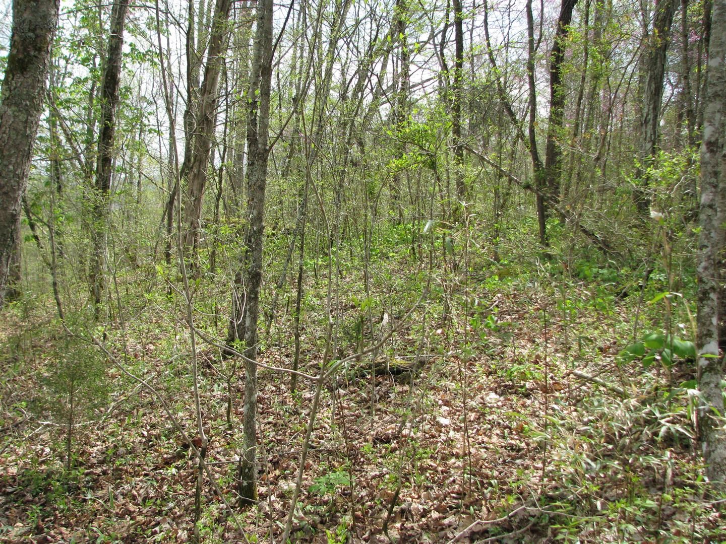

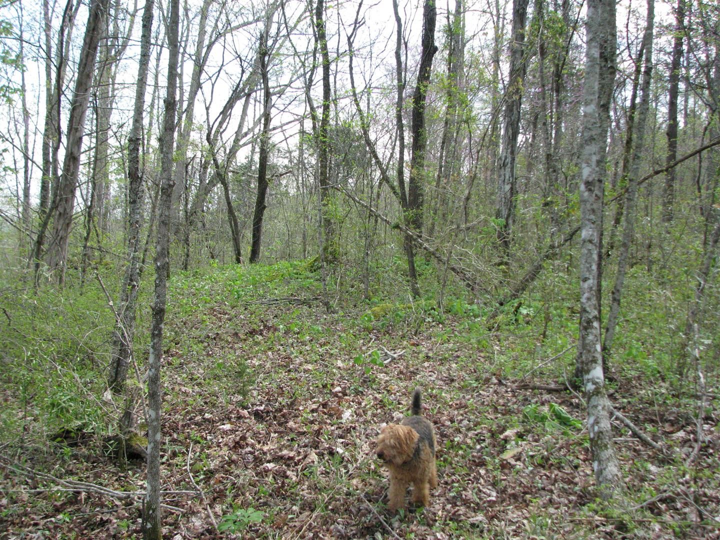

We wanted a trail down to the spring, so I figured this would be a way to clear a path and not wast all the saplings. A before pic:
& after:

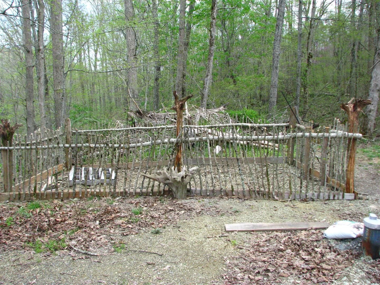

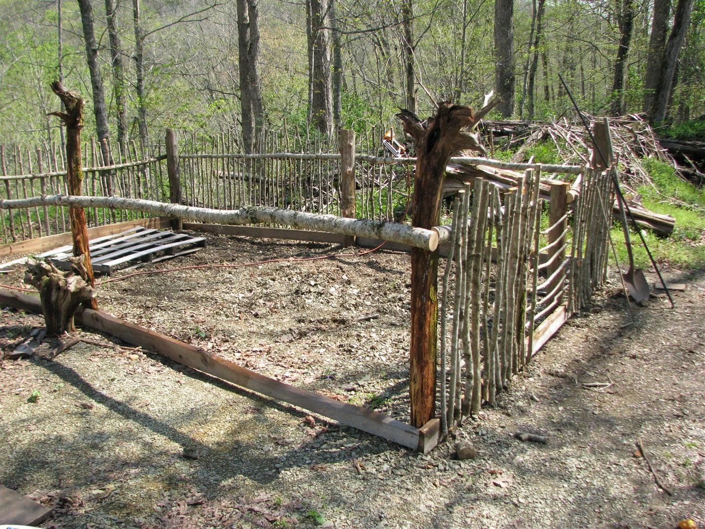

All done:
The horizontal sticks at the gate are removable, they just rest on screws. The entire gate panel is removable so I can till the garden every season with the tractor. Total cost was about $10 in screws, nails & fuel/oil.......
