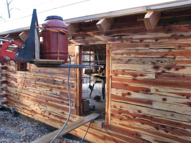

I've read your build from beginning right up to this point... never skipped a word. I'm amazed, and congratulate you on your progress. Regarding your transition point dripping... I think many on here are WAY over complicating it. Moisture is normal... that's why you have a moisture barrier. But, how did you make the transition from roof to overhang with that moisture barrier? It looked to me like you transitioned with the roof metal, but I couldn't see how you could have placed a moisture barrier transition UNDER the roof moisture barrier, and OVER the overhang barrier, to prevent water from getting through there. See the attached pic for an idea what I'm asking. ExteriorStain003.jpgNorthPorch006-2.jpgNorthPorch007-1.jpgPressurewash006.jpgroof leak.png
   / The Log house Project begins........ #2,033
Problem solved by this pic? Except... I seem to remember you saying something about putting the moisture barrier on top of the overhang foam, or not at all (it hand some built in or something?)? In which case, problem is solved by removing overhang metal, foam, loosening roof and tucking moisture barrier transition under existing, then placing moisture barrier on overhang (under transition barrier) then re-installing foam and metal. Hope I'm making at least some small amount of sense. You didn't post pics of the transition while making it, so I may be way off base here. roof leak.png

Okie, no you are correct, I did not put a moisture barrier transition under the metal transition so there is a break there. Also and recently, I now have a full blown leak along the transition when it's raining so I made a mistake there someplace. Racking my pea brain I cannot remember if I caulked the overlapping 10' sections of the 10" transition metal, so water may be finding it's way back under each overlap(there are 4 I think). The leaks seem to correspond with those breaks...about every 9'. The weather is warming up so I will be able to get back up there in a week or so to see what's going on. I kinda hope I did forget the silicone which would explain a lot eh?

It's sounds like you've got the dripping whipped (except for the work part). Unfortunately, I don't see any way around the tin and foam coming off the overhangs to fix it. But, at least you don't have to pull the main roof :) When you go to seal up that gap, I like to think of it like this: you should be able to go through a frog strangler with nothing but the moisture barrier, without a single leak. One seamless barrier, overlapping from top to bottom so water runs down all the way to the eves without being able to find a gap. One other thing... By running the moisture barrier top to bottom (and I completely understand working alone and why you had to do that), if the water hangs up anywhere and goes sideways, it can slip under the seams. If they are taped really really good, then you may be OK. But, the one thing water wont do is travel up-hill (usually), so having the overlaps top over bottom is always preferred. Also, moisture barrier to the warm side in winter on this style of roof.
If you do develop leaks, and have to pull the roof That would be a great time to double up the foam or add some high density. You could most likely do so without having to alter the tin with a little creativity. Up to 85% of the heat in a log cabin is lost through the roof, so insulation there makes a HUGE difference. Especially with open vaulted ceilings where the heat is all gathering way up where you're not. A ceiling fan or two (which I think I saw you purchased) to push the heat back down will really help.
As far as venting the roof... the tin is designed to do that. It looks to me like you installed it exactly like every other tin roof I've seen installed. I wouldn't jump through any hoops to try to make more air move through it. But, that's just me.
