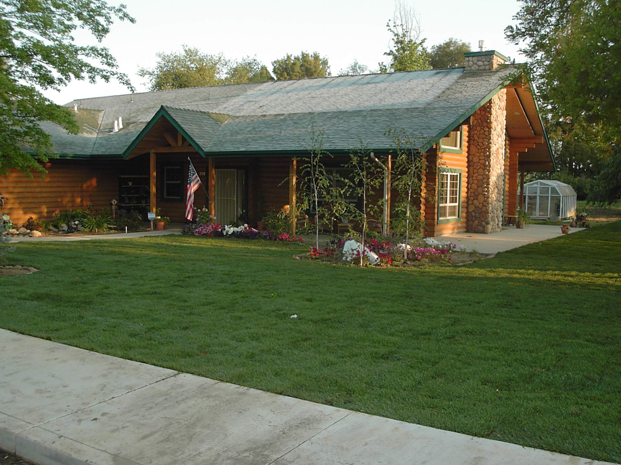

Wow, what a beautiful place to build a log home! You are really going to enjoy your project. In 2003-4 I designed and built my log home. It is made of Engleman spruce with 8" thick logs that were custom milled out of Idaho and shipped to my building site. There were a total of 494 logs in various lengths up to 16'.
My wife and I did much of the work ourselves and completed the project in 11 months. It was a challenge for me because I'd never built a home before, but we thoroughly enjoyed building our log home. So, go after your dream and enjoy it as we did! Mike.

Mike.....11 months?? wow, it took me a year and a half to build the last one & it was 1640sq ft. That one was the first house I built, and the first thing I built if you don't count a pair of speakers in high school. Y'all must have been motivated!

Yeah, I was motivated because the home we were living in sold faster than I had anticipated. I was there 7 days a week working to get the log home done and my wife would show up after work (RN) and we would work into the late evening. Just about wore me out! The home came in at 2057 sq. ft. with 1440 sq ft of porches front and rear.
