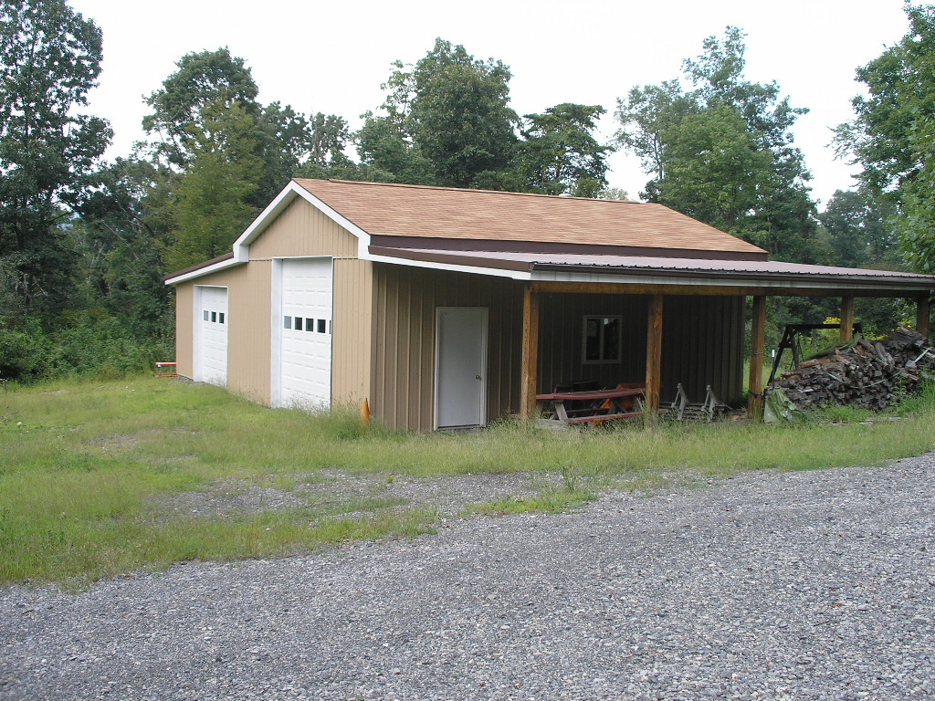

Just thinking about this and looking at my roof. Are the ends of your R panels sealed? Air should be able to get up under the metal through the ridges and flow to the peak. This should be more then plenty air flow to solve your problems, but if the ends are sealed, then nothing is flowing. Same thing if they ends are open, but the peak is sealed. Open the peak and the air will flow.
Eddie
Sorry but my internet has been down for 3 days. I think a power surge interrupted the antenna radios...I had to re-boot and re-configure both of them today. Just ordered another battery back-up surge protector for the satellite and antenna radios.
No, they are all open......here's the ridge cap end:
The drip edge and transition over the porch:
And the top of the ridge:

That was a long wait to hear back from you :) Frankly I can`t believe it is leaking.....as usual to me it looks fine....but you know better...Looking at your first picture, `is it open a little to let the air out on both ends? ` The overhang of the cap appears fine, but if the air can`t escape , then it needs to....I can`t tell by the angle of the shot....
I notice on my own roof that condensation formed more heavily on the totally exposed ( both inside overhang and outside) on the porch...I thought that strange and everything had to be the same temperature all around.....Tony

It looks real good to me too. I'm wondering about the vapor barrier. Does that go out over the wood and under the metal? This just ruined everything I've been saying about venting, since it looks perfect. Something else is going on in there and the only thing that doesn't belong is the vapor barrier. I'm wondering what it's doing?
Eddie
The sandwich looks like this:
-decking
-30 weight tar paper
-3" styrofoam w/taped seams(thinking back I only taped the horizontal seams, not vertical, but the panels were butted tight)
-1x6 purlins
-metal
Tony and 955 it's condensating only over the heated living space, not the overhangs or porches(which btw are insulated with 2" high density foam).
I'm starting to re-think my re-think.....studying ventless propane and y'all are right, at least a half a gallon of water vapor per hr is put into the air when it's running...possibly up to 1 gph:eek: That is a lot of moisture.
Now that company is gone and the "frost in the mornings" returns I will not run the ventless for a few days and see what happens. This week is no help....warming up all week.
   / The Log house Project begins........
#1,838
Now, there is a shadow from the ridge cap overhang in the pic. The end of the ridge cap is sealed at both ends. First order of business is to cut a hole(4x4 or 5x5-ish) in that on both ends and build a screened cover. It certainly can't hurt anything........
   / The Log house Project begins........ #1,839
Hmmm....it doesn't mean that they will stay tight as things move around a lot. Tar paper has a permeability rating of 5 or more so you can't depend on that for your vapor barrier. One or less is considered good.
Nix the ventless and open the ridge cap ends as a start.
