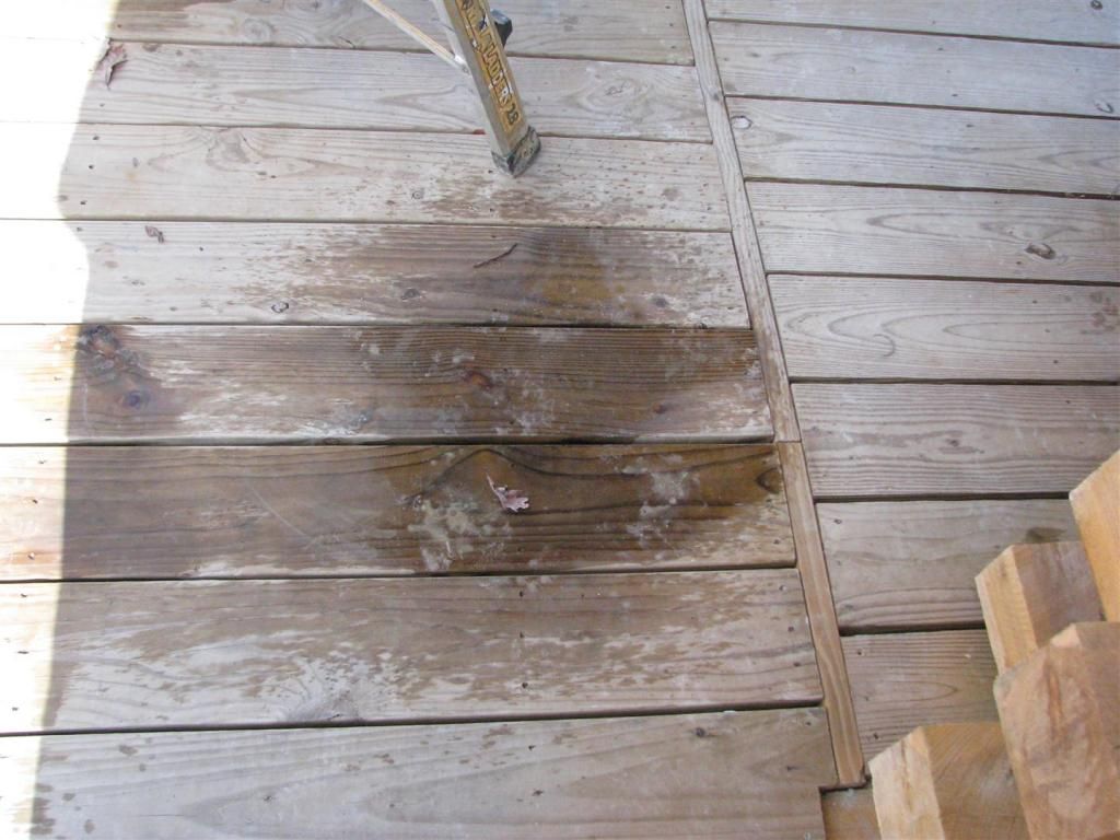

Yesterday I walked around the deck and I see a puddle of water 2' in from the eve under the porch/roof transition line. Looking up there is a pretty steady drip and walking along the back porch(North side of house) I see 4 more smaller spots that are wet. I thought I had a leak, but no, it's apparently water vapor condensation on the underside of the metal roof. It was 28 degrees yesterday morning and there was a frost. At the time I walked around it was 11AM and the sun was full on the South side of the roof. There was no drip/leak on the South side porch which means it must have been burned off by the sun. Here are the pic's:
Puddle:

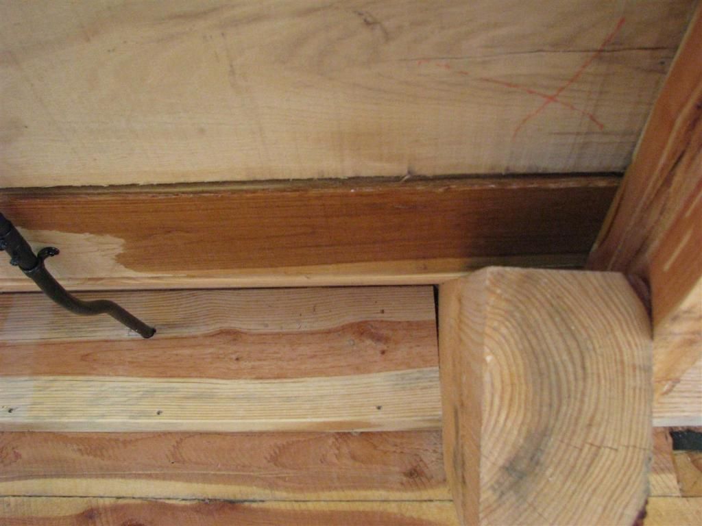

The exit point of the water:

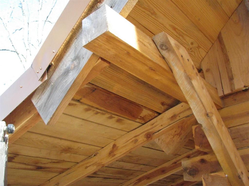

Another spot about 8' in from the eve:
