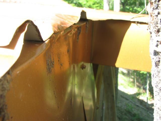

Well, as I suspected, that oak tree is too close to the porch roof....5" is not enough. We had a brief high wind storm and about an inch of rain all in less than an hr. This morning I immediately checked that cut out around the tree on the porch roof and could see marks on the trunk and a "kiss" on the flashing and roof edge. It looks like this tree will have to come down before it does some real damage to my brand new roof. Oh well, I gave it my best shot..........

Here is the mark on the tree:
And the edge of the roof(looks worse than it is, about 1/4" indented):
I am going to have to take care of this before we get a "real" Northerner or it will be able to do some serious damage.

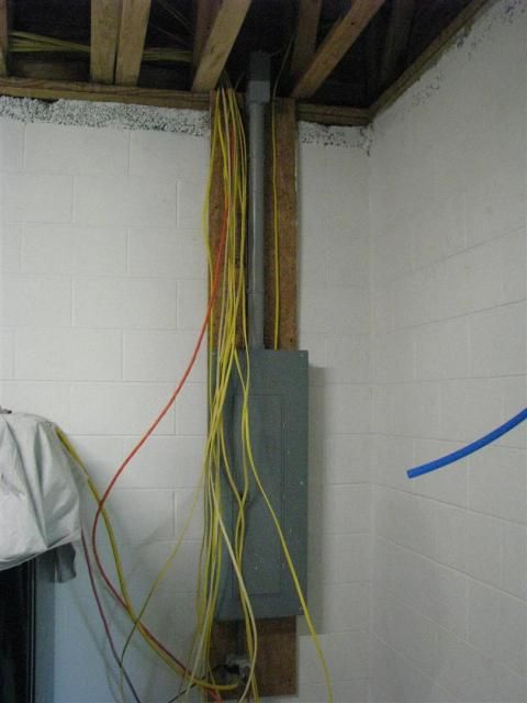

And here are some wiring pic's, we are almost ready for the rough-in inspection:

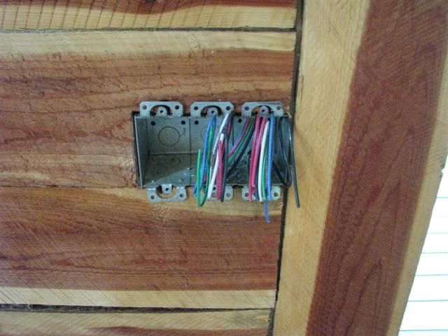

We are running stranded up from a box in the basement to the switches, then on to a box on top of the log walls. This way the 1/2 EMT is not an issue for us:
   / The Log house Project begins........
#1,319
The box on top of the wall:
Yes, everything is labeled:

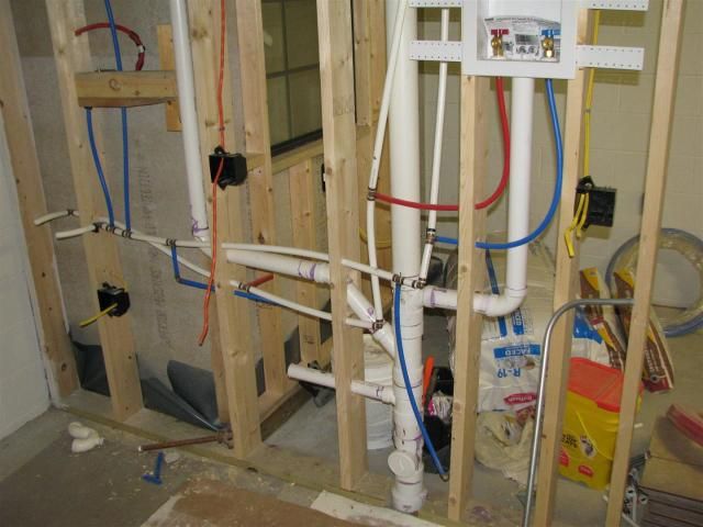

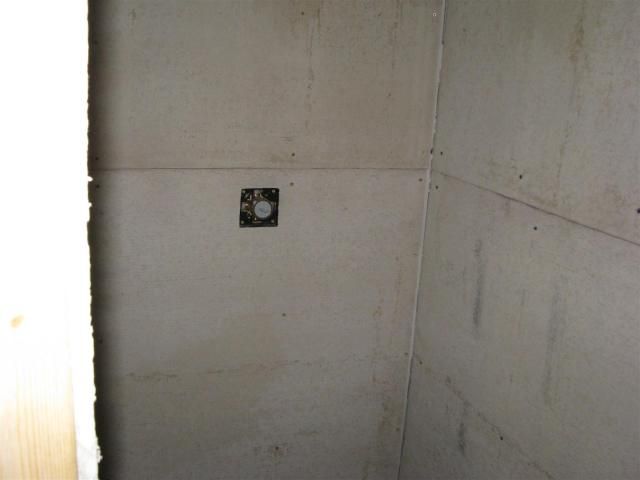

I also started on the shower in the basement. I wanted a glass block wall to let light in with an opening, no door. Well, I almost fainted when I priced out a 80"x54" blocks, mortar and grout.....$$$$500.00. Nope, that is not happening, so I went to a salvage store and bought a single window with divided lights for $20:
