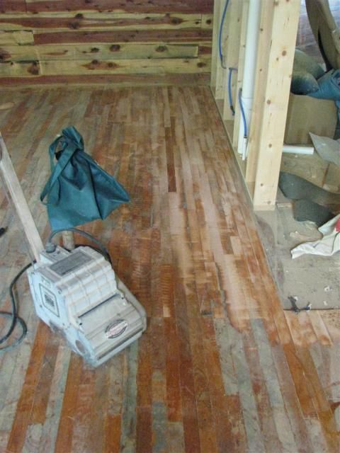

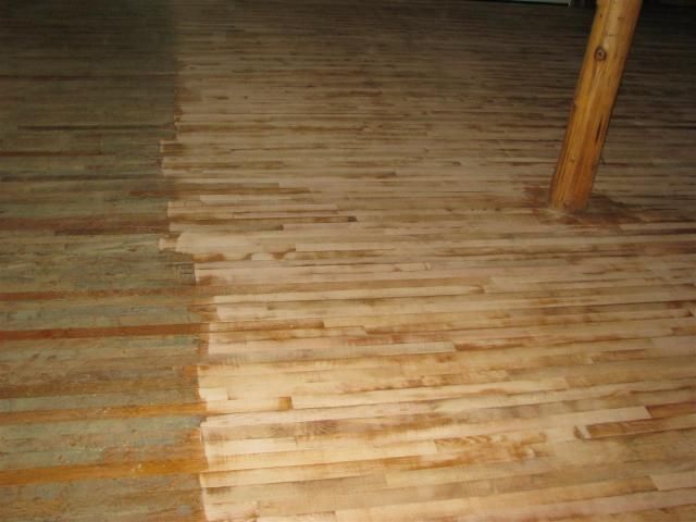

A pic of the edging with a 7" disc sander:
Ready to drum sand w 50 grit:
Halfway with the 50:

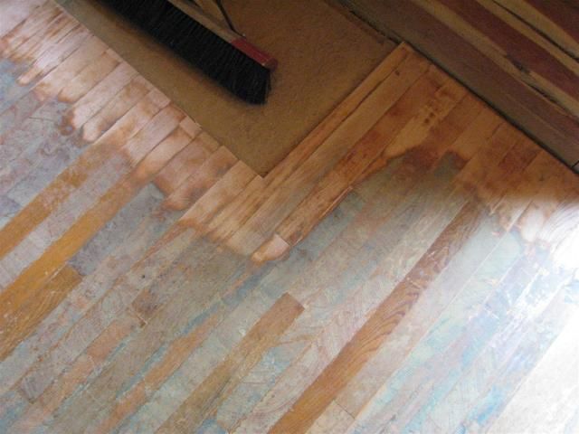

As I figured, the carpet glue was a pain in the arse. I ended up going at 90 degrees to the grain to get it off most efficiently. Even at that it was slow going with many paper changes. After getting the glue off I did one run with the grain....much better.
