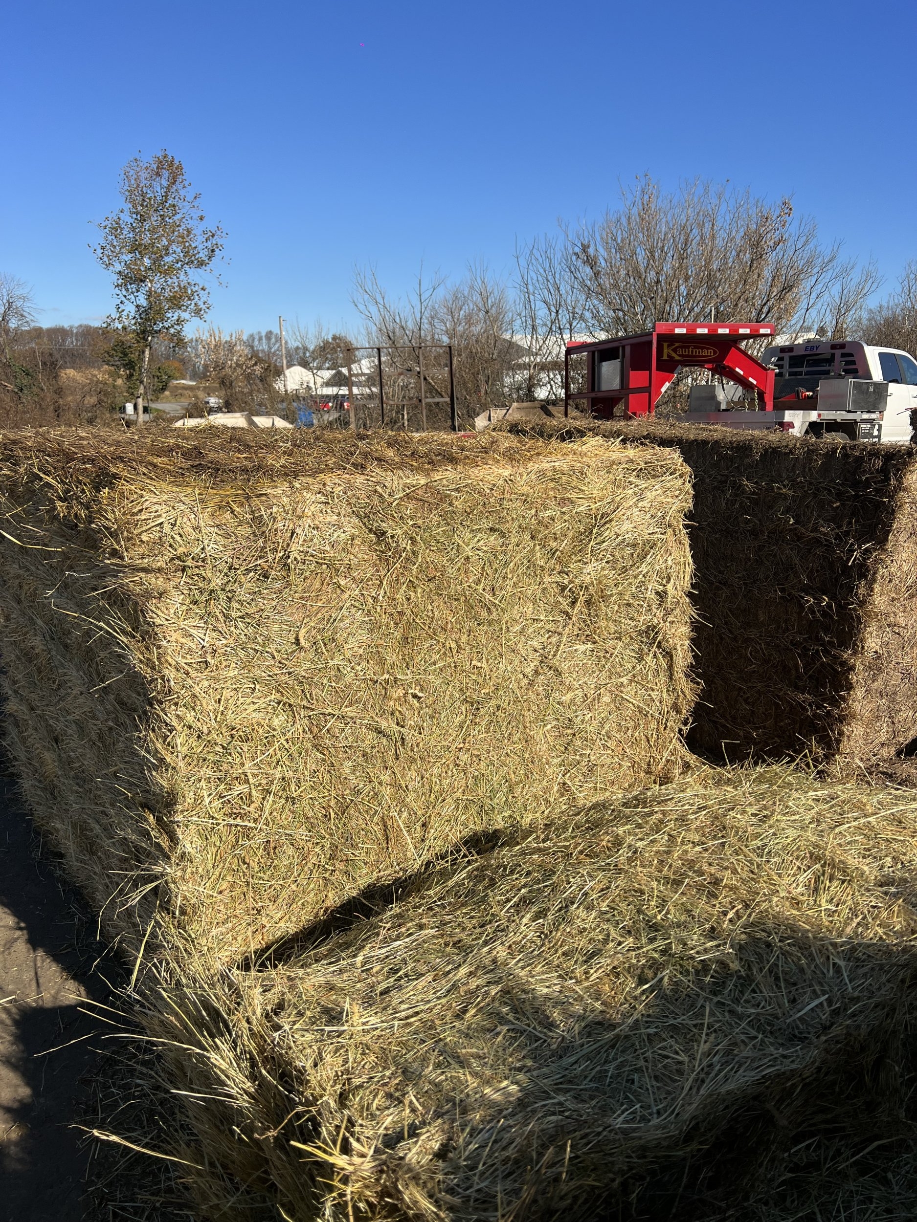

Here’s the inside of a typical outside stored bale I sell to the growers.
In MY area, this would be considered good cow hay.
I sell these bales to beef cattle guys and feed my own this kind of hay all day long.
This bale sat outside in a stack for months.
Looks good to me.
