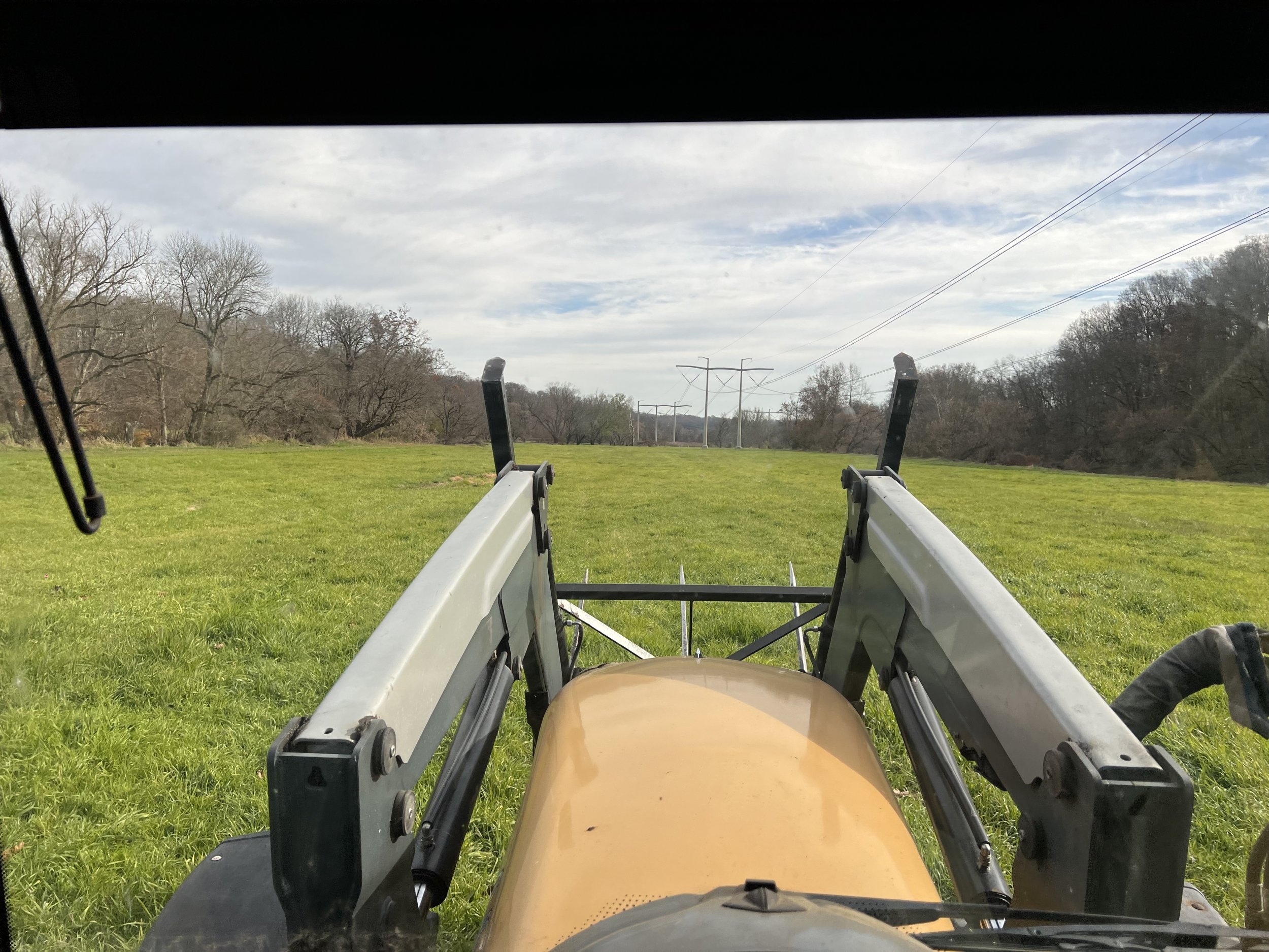

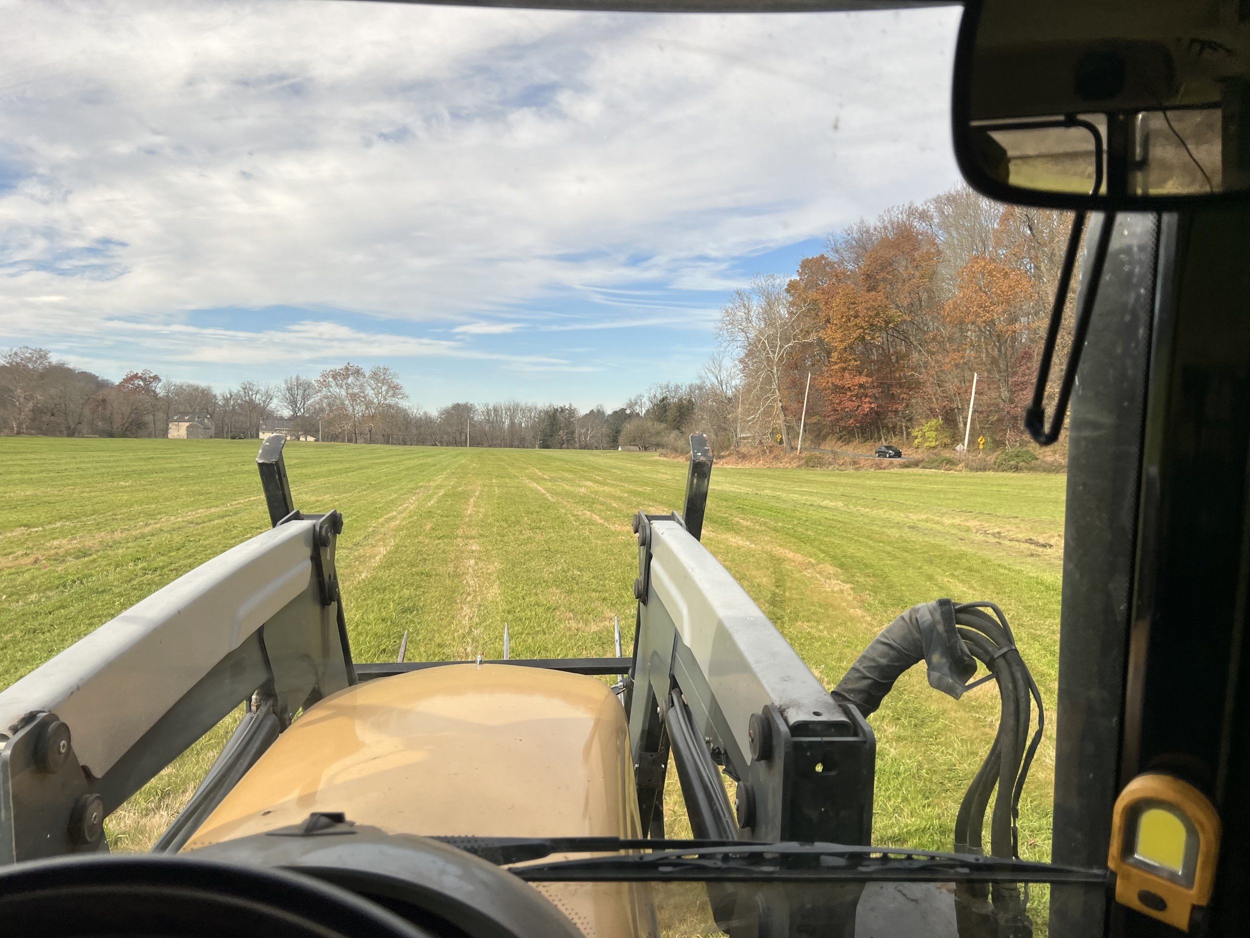

Mowed a 40 acre parcel today. Beautiful, sunny 60* Just perfect.
It’s 3 parcels. One is 3-4 acres. The other 2 are like 35 acres. The customer who owns it has me do 2 hay cuttings, then do a final light mowing before winter sets-in.
This is the front parcel.
And the rear parcel, just getting underway. Sometimes I want to do a 3rd hay cutting, but I have all the feed hay I need. This back field reliably produces beautiful bright green feed hay. Probably my favorite field.

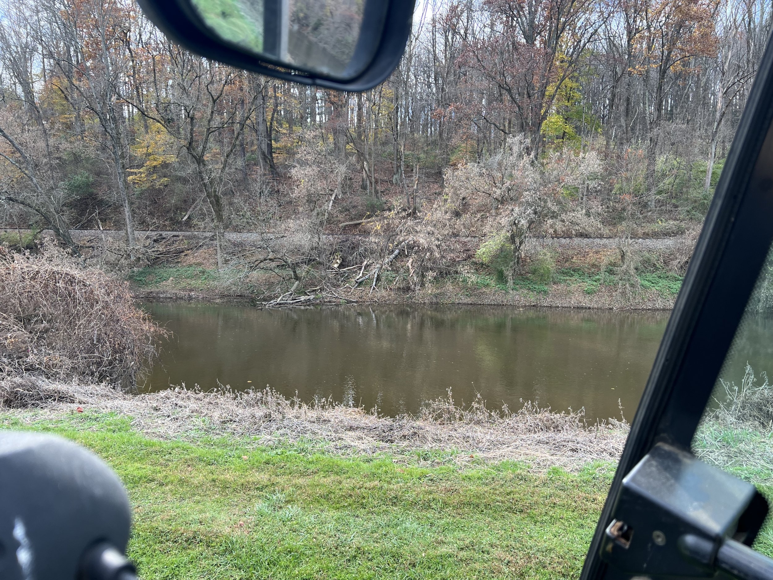

The back edge of the property is flanked by the Brandywine Creek, a beautiful small river that has seen the blood of American Patriots during the Revolutionary War. Across the river, you can see our local RR, East Penn Railroad‘s tracks. They pretty much reliably run freight 2X per day. Looks like a tree fell on the tracks and had to be cleared...

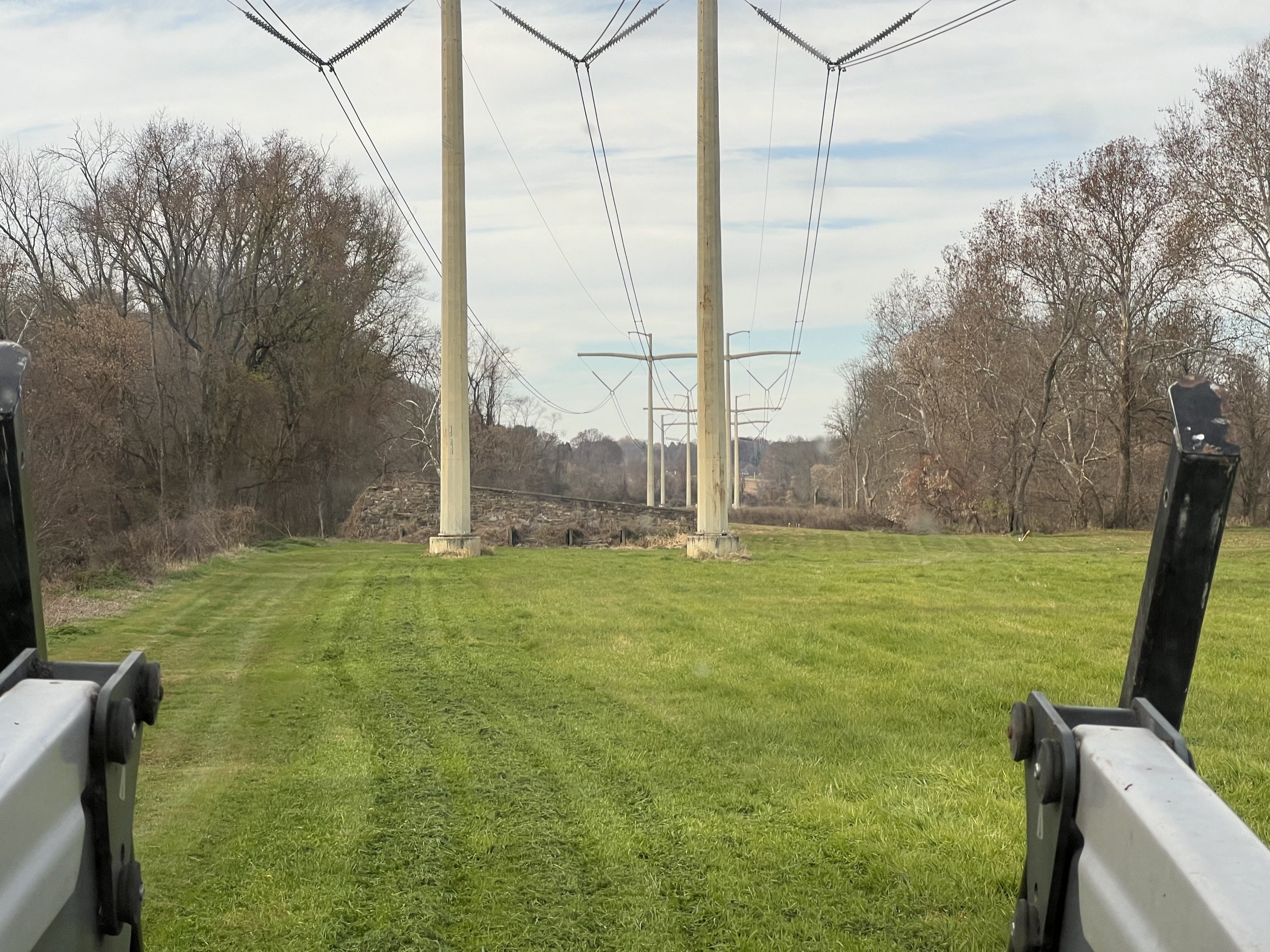

Beyond the bridge approach ramp under the same power lines, is another field which I cut hay from.

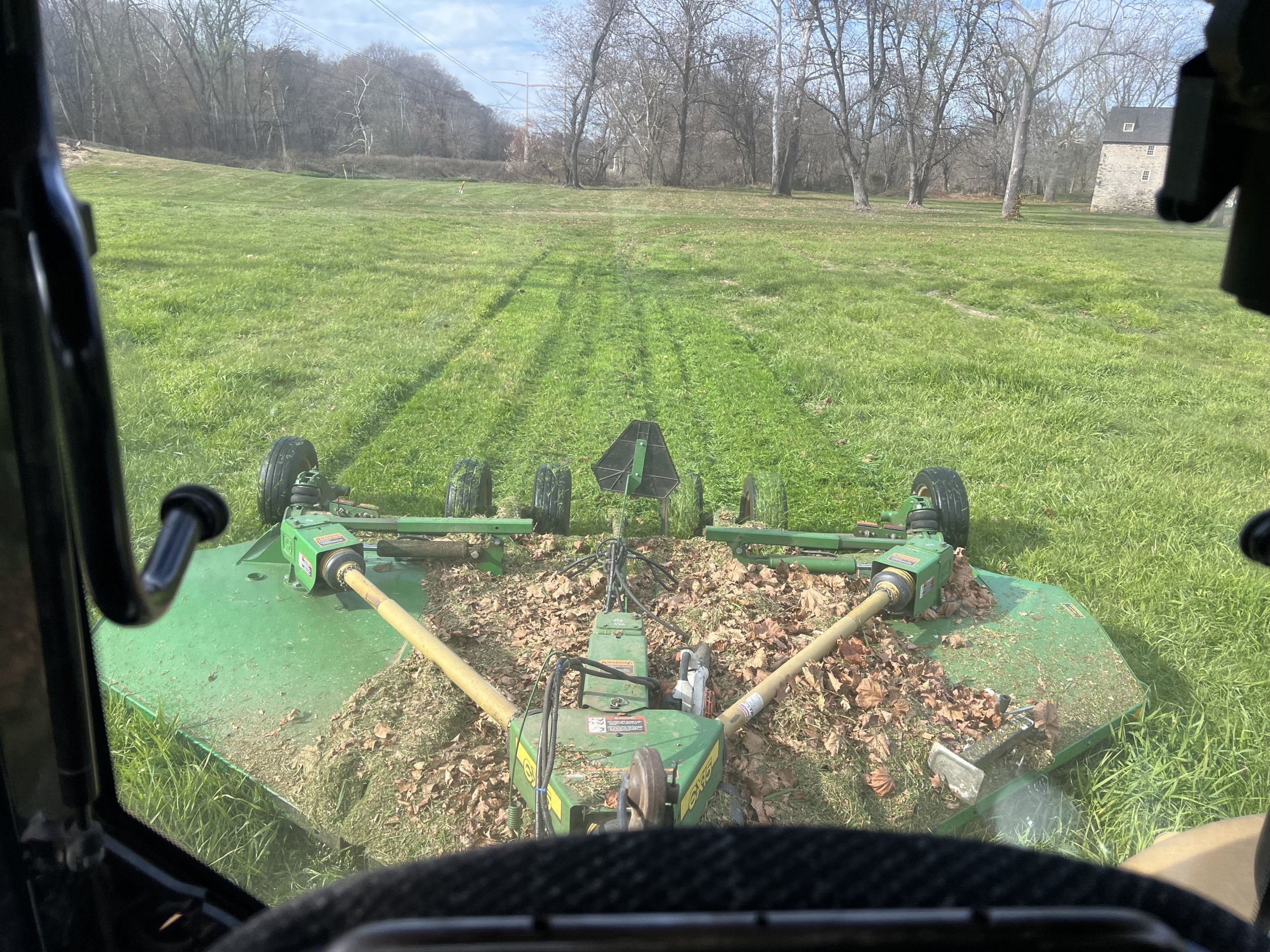

The CX-15 behind me. One of the best pieces of equipment I have ever owned. This mower has cut over $250,000 dollars of fields. My up front cost was $17,000. Only one repair of $1,000. Of course you need a tractor to pull it, too.

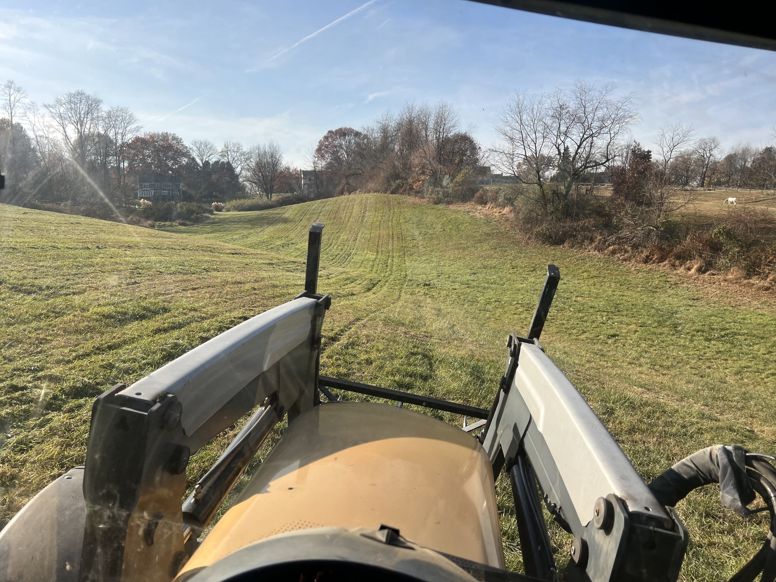

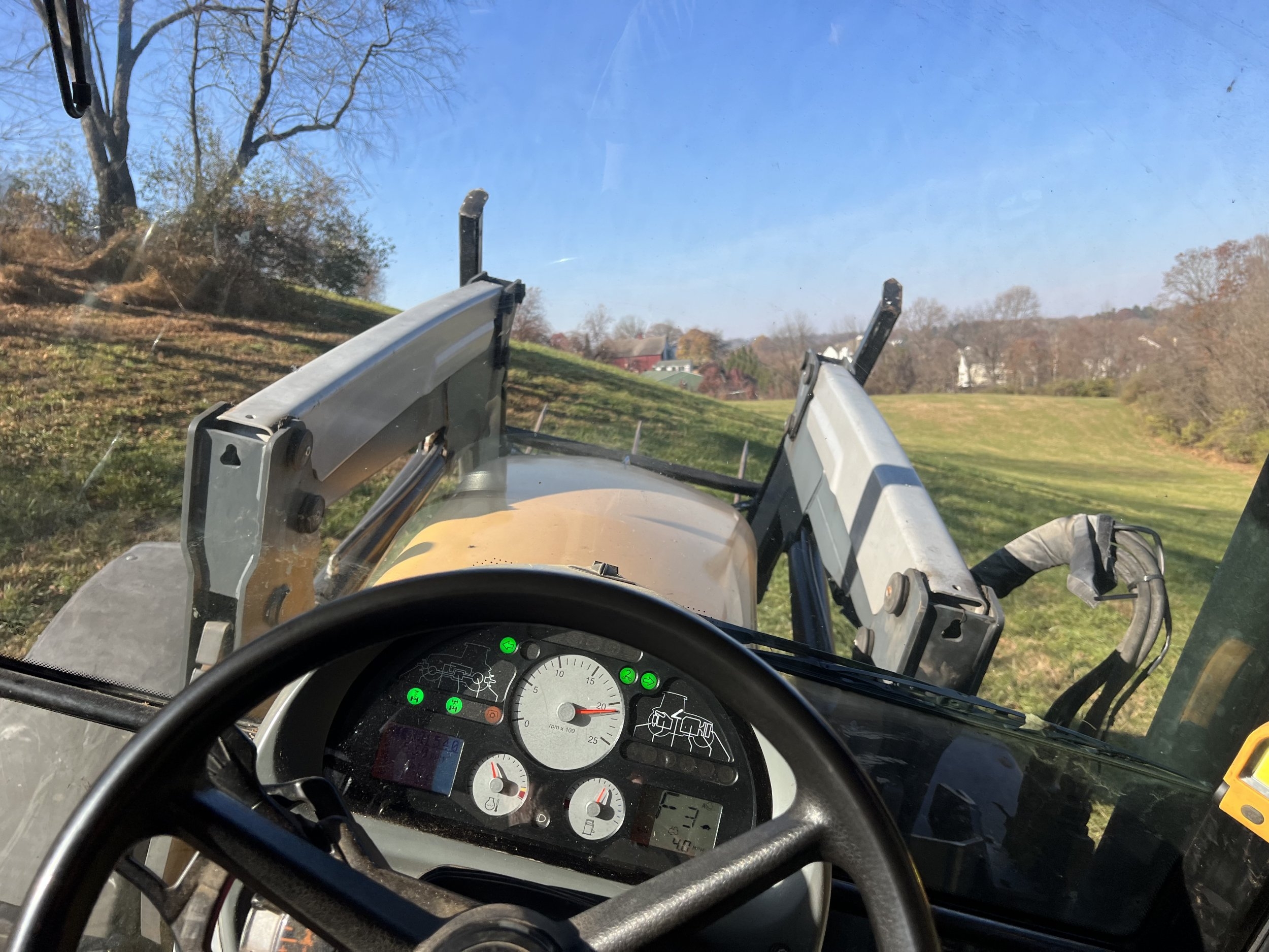

On to my next days of field mowing.
Yesterday I mowed a development with 5 separate parcels.

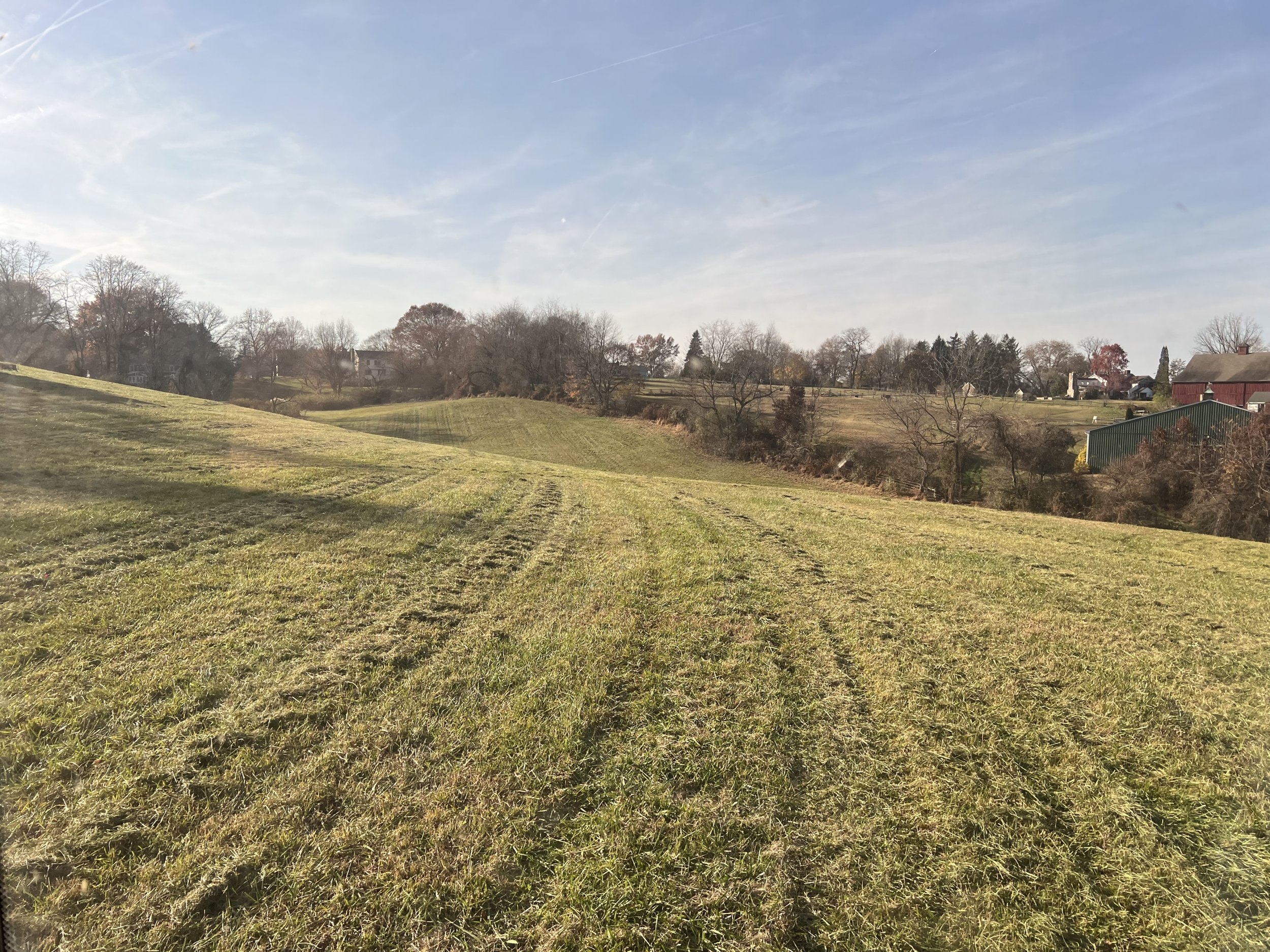

It has some steep spots
Here’s a nice, open area where you can move along with decent pace. I keep thinking to myself how much hay could be made here……what a waste.

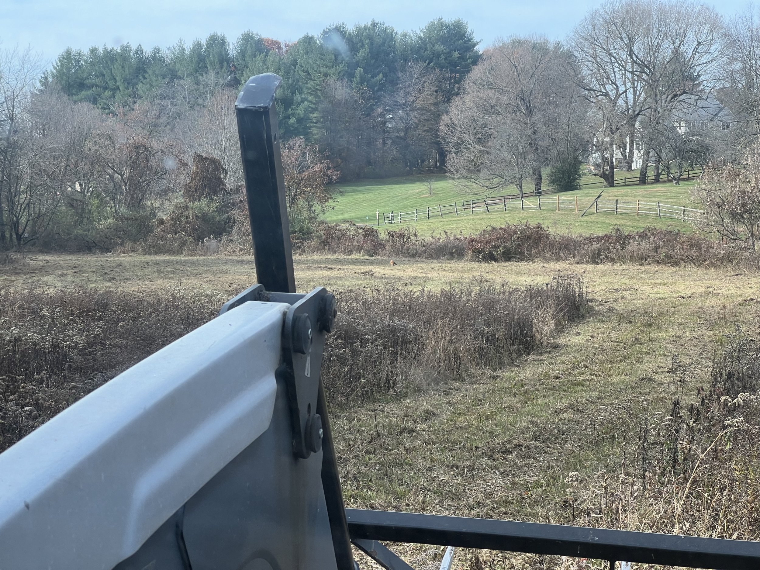

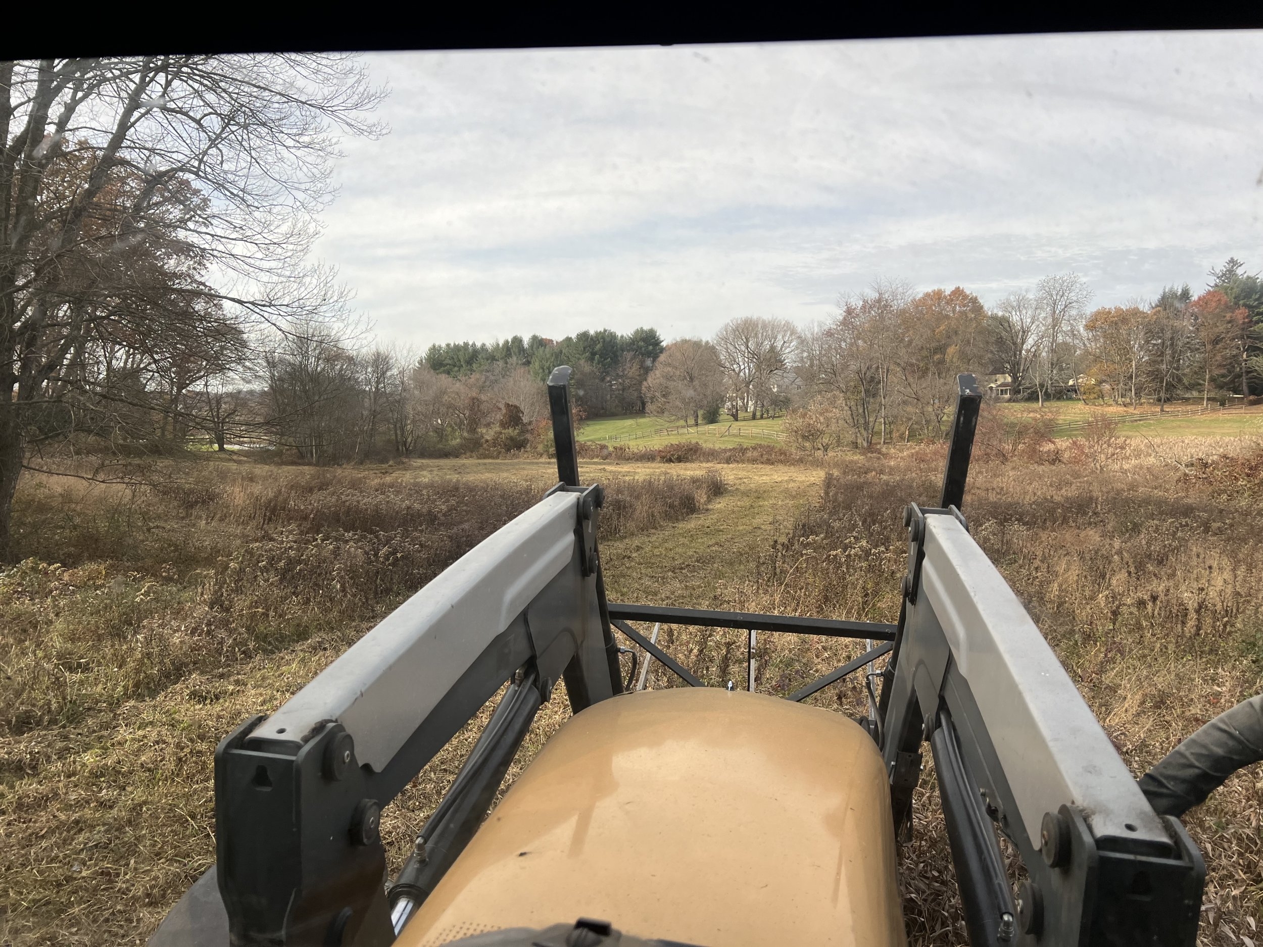

Today was a different kind of cutting. It’s a similar HOA development with fields, but one of their fields is only cut 1 time per year. The HOA members believe there’s small critters, like turtles, frogs etc. that are sensitive to excessive mowing. ”Hey whatever you want” is what I say. This ground is quite damp. They call it the “Winter Wet Meadow”.
To the right up on the rise is the Samual Painter House circa 1757.
If you look closely, you can see a very healthy fox ahead.

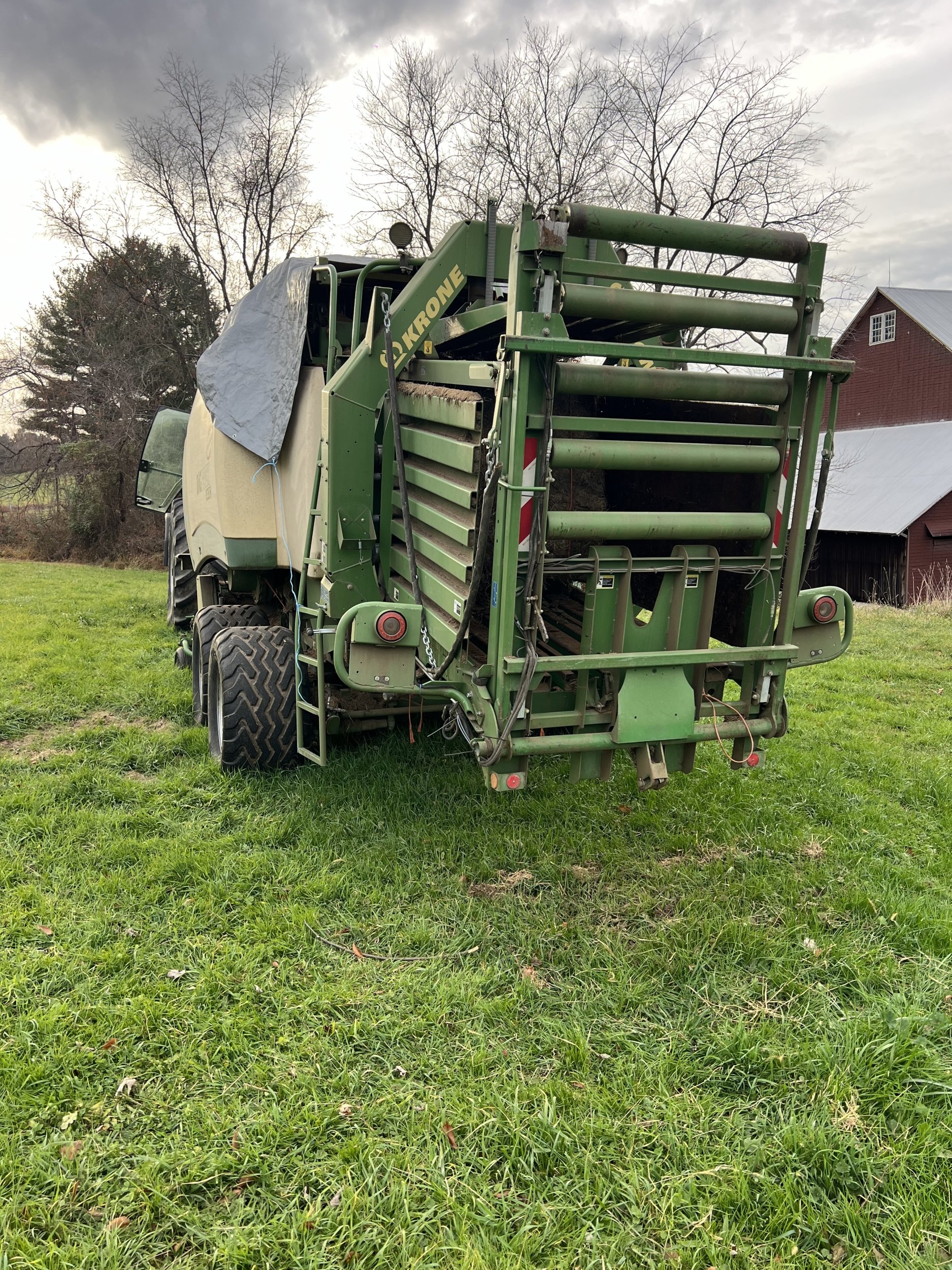

Back at the farm. I have to get the big square baler inside and start cleaning it up.

How many bales would you put on that before you would want to replace it?
Some farmers will let them go after 25,000 bales. Some will hold on to them until 75,000 bales. This one has 24,000 bales through it. I‘m always looking to upgrade, but large square balers are kind of difficult to sell/buy/adapt to tractor.
Does much go wrong with it or need maintenance?
Yes. There’s an unbelievable amount of moving parts, and most all need lubrication. Lots of maintenance is needed, but considering what it is asked to do, it’s understandable. Lots can go wrong, especially if you bale up junk. There’s a lot of electronics in them now, like todays tractors & vehicles and the monitor is $5,000+
Is greasing easy?
There’s an auto lubrication system for about 60 grease points. There’s about 25 that are done with a grease gun.
