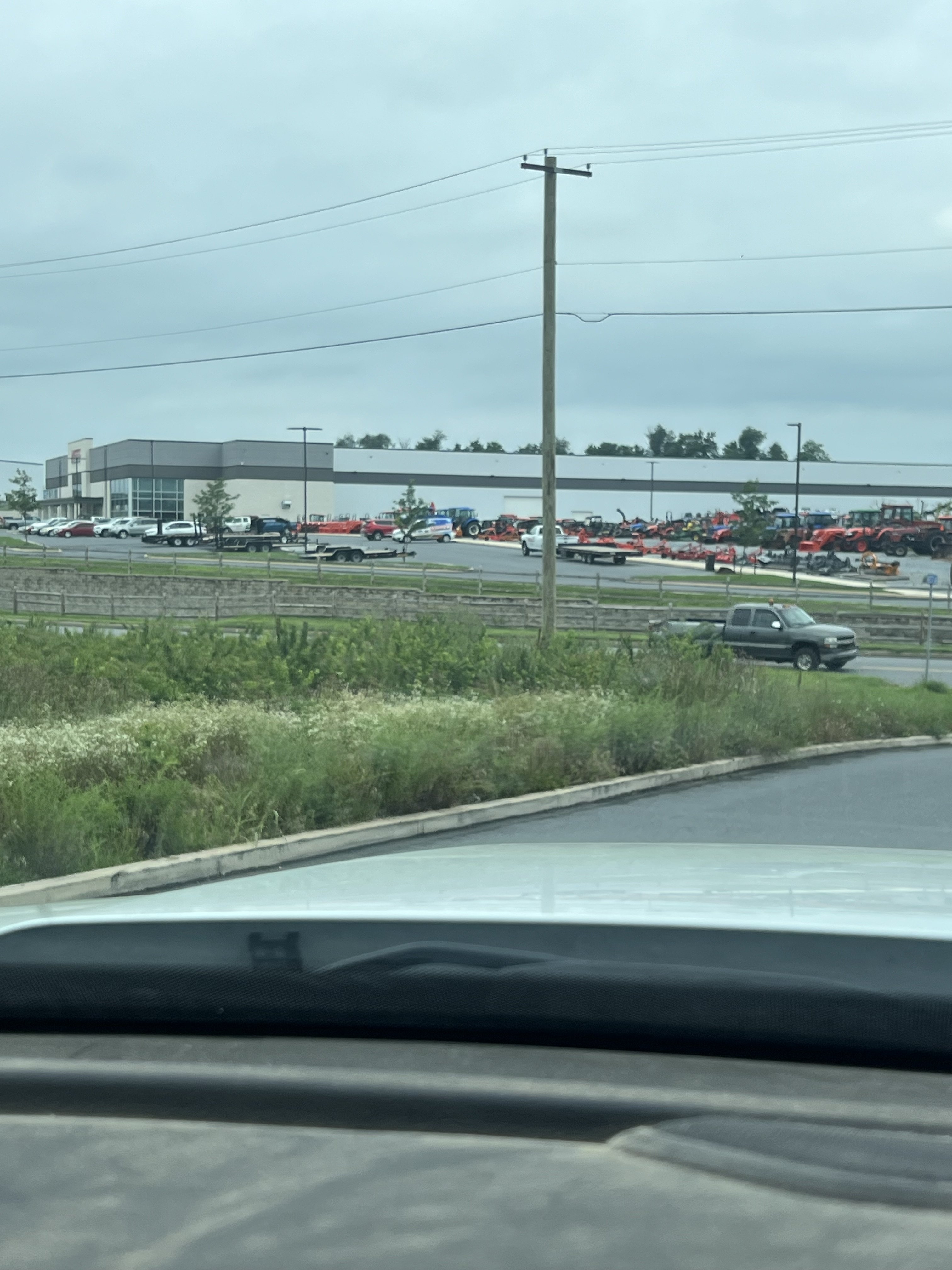

Here I am at Messicks this morning to pick up parts in Mount Joy(less) location.

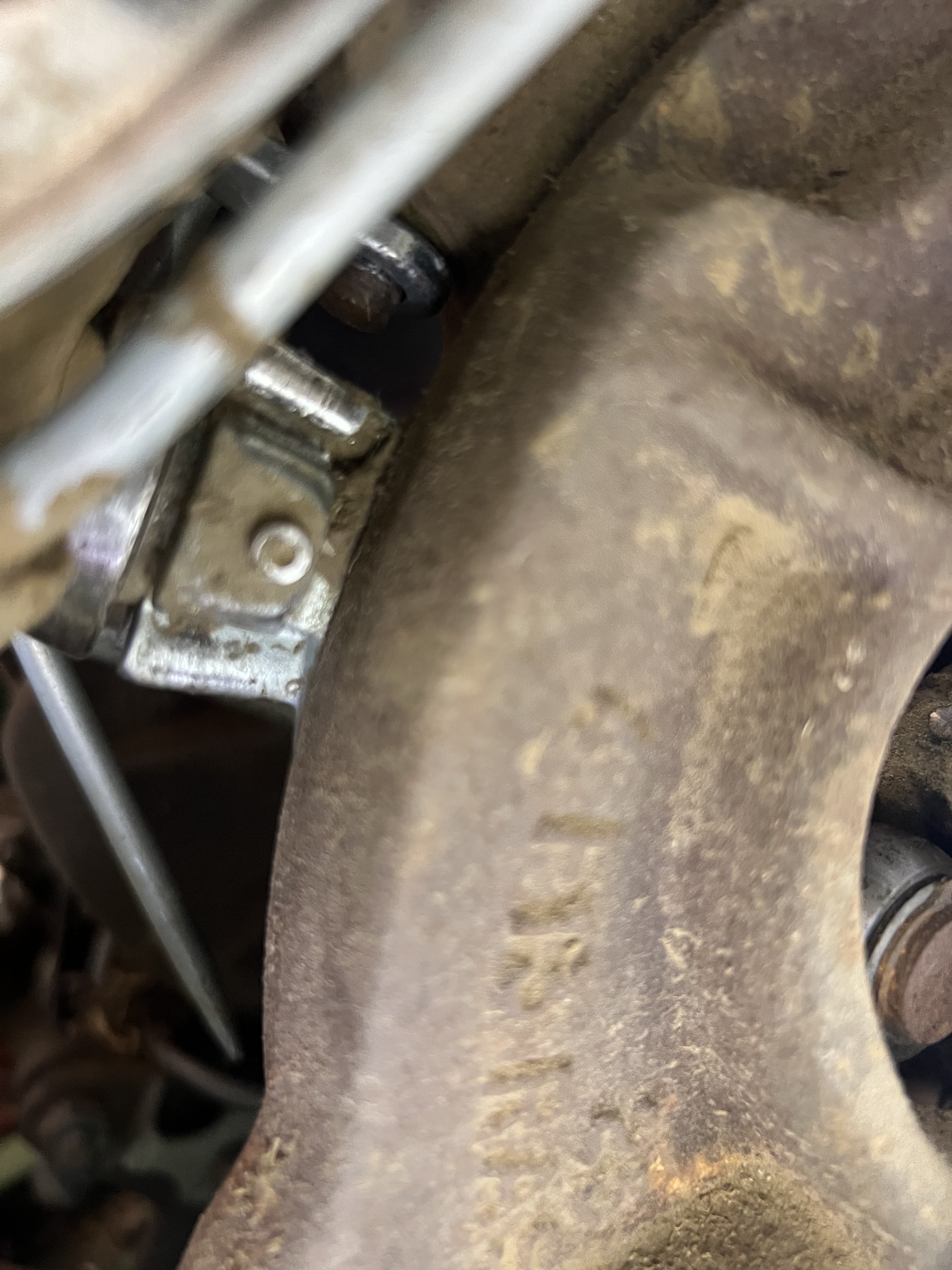

Now back at the shop. I have to drive out this 5/32nds roll pin to extract the billhook assembly. It’s really hard to get to with a pin punch and a hammer.

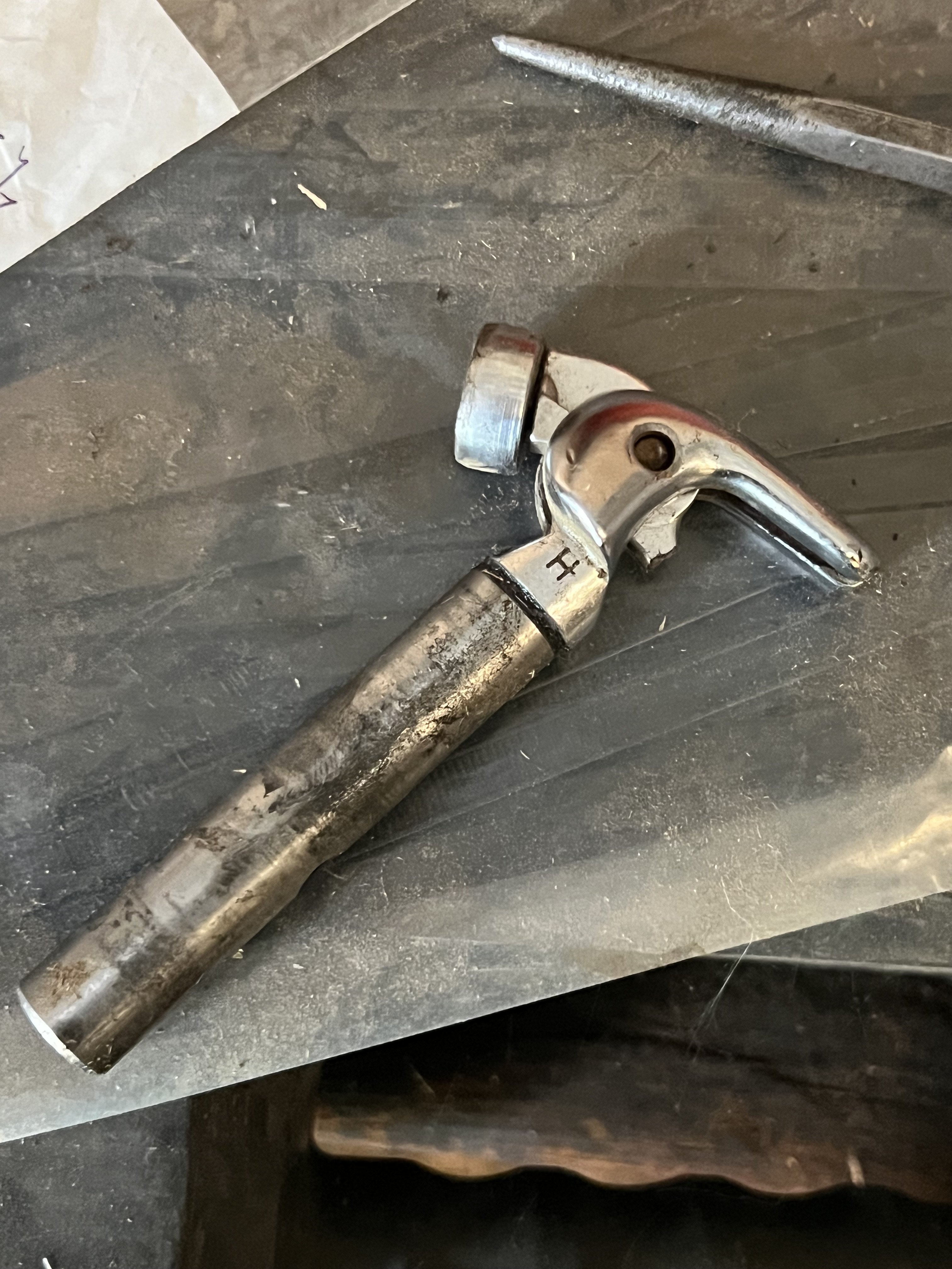

Here’s the broken billhook removed.
All said & done, 3+ hours of driving and 1-2 hours shop time to install.
Parts were $291.

At first on Friday, when all I saw was a broken twine guide, that was true. We replaced the twine guide, fired up tractor and baler and tried to tie a bale. Knotter failed up top. I felt around the back of knotter #4 and felt its billhook tongue was missing.
Thats when I knew I was into more parts and time.
