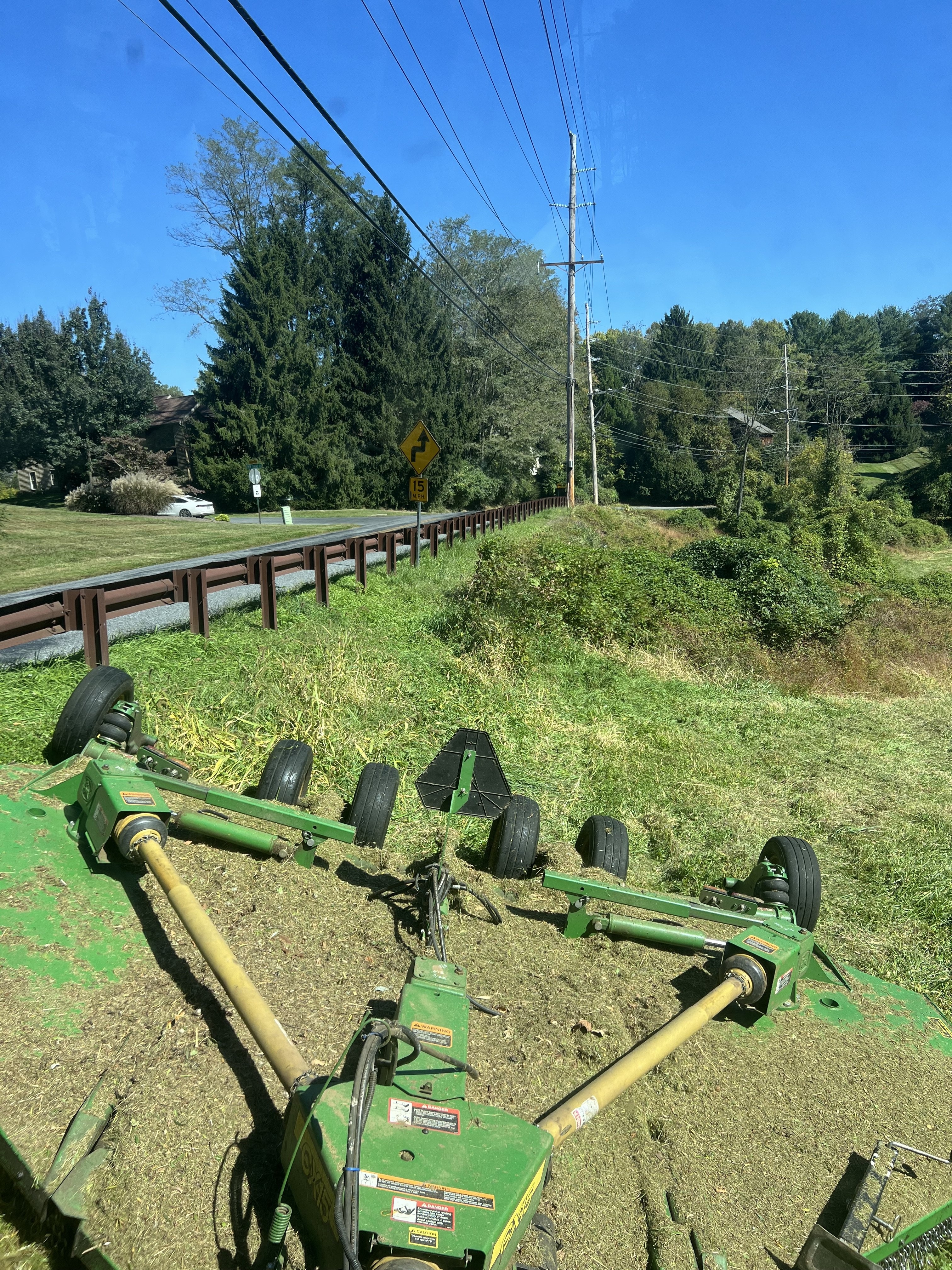

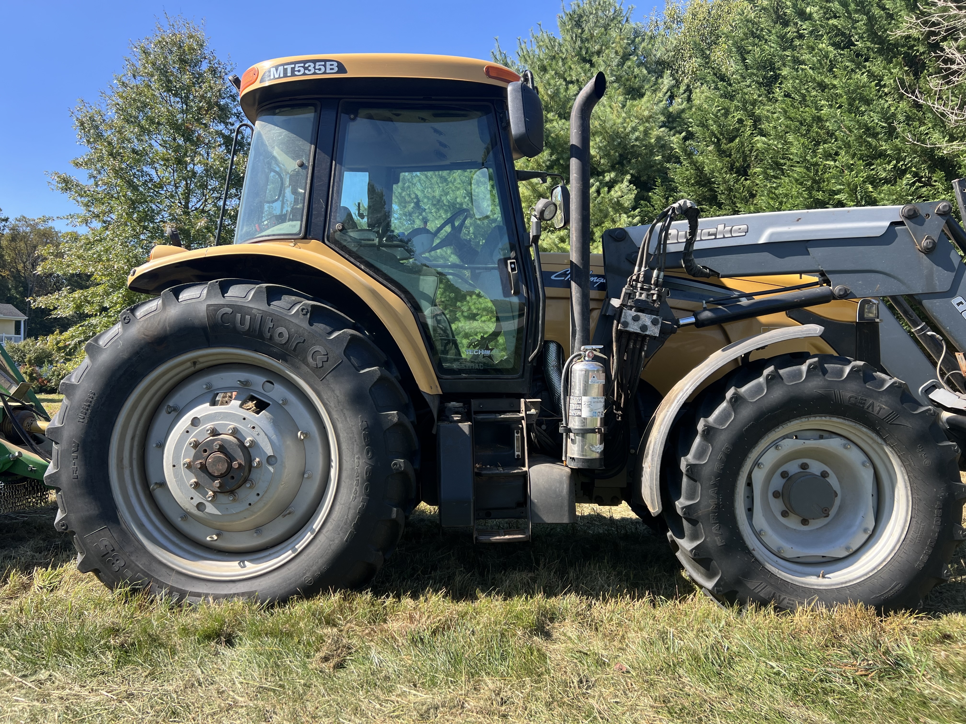

A little more mowing action on Friday. Steep roadside bank. Great supplemental income while waiting for hay to dry. I’ll do $40K in field mowing this year. My goal is to double that in the next 2 years and have a tractor dedicated to just mowing so the challenger I currently use is devoted solely to hay.
I’m really happy with the Challenger. Been a great tractor. Would like to buy another similar loader tractor to cut down on using it for so many tasks. I’d prefer to cut down on the hours it is used and spread the hours out over 2 loader tractors.
Plus it's real handy to have backup for when something goes down for a couple of days.

And the small Challenger is up around 5500 hours. Not exactly a new tractor..
