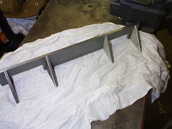

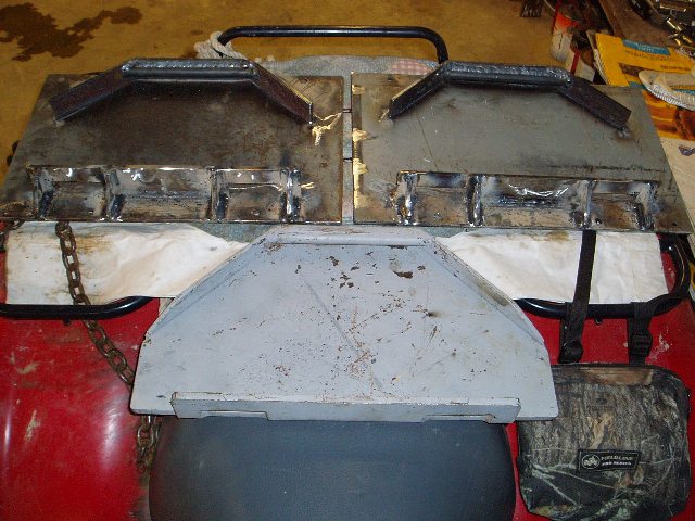

Here are some pics of a new design quick plate that allows one to use 1/4" metal instead of 3/8". I believe it to be as stout and uses a larger plate. If the larger size is needed it works out pretty good.

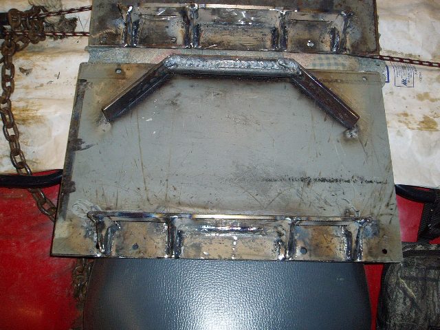

What the top was built of

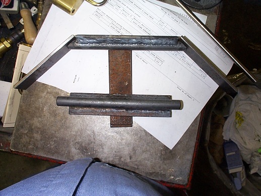

What the bottom was built of.

I have five of these lying around incase an idea or a need pops up. I guess I could part with one or two. Especially for my friends here.

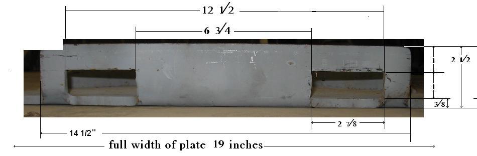

Hate to take up so much room here but if you decide to build your own these dimensions were used.
