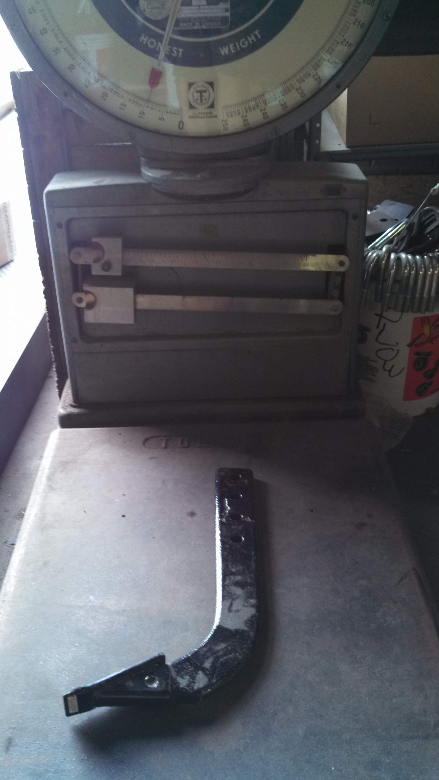

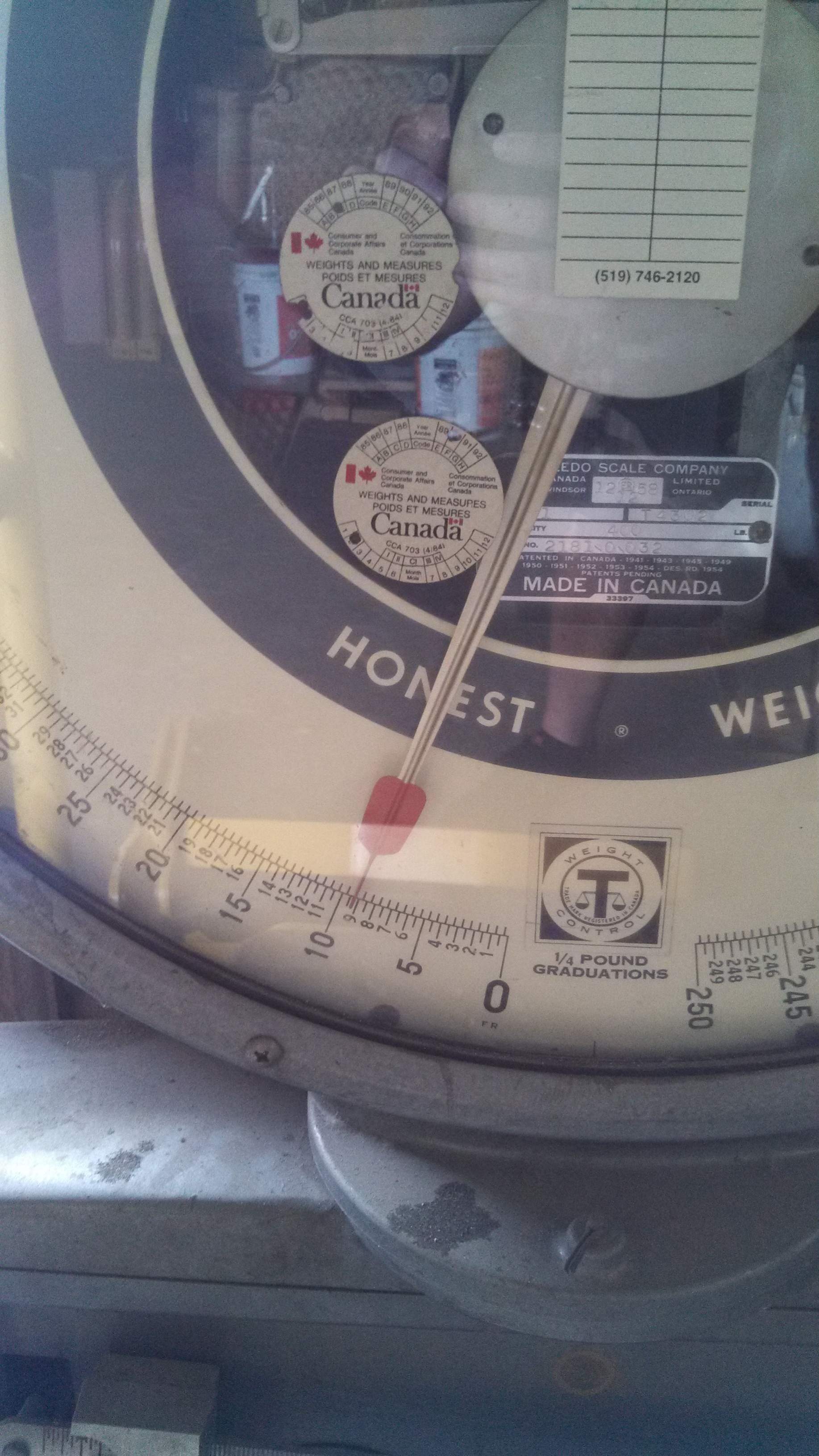

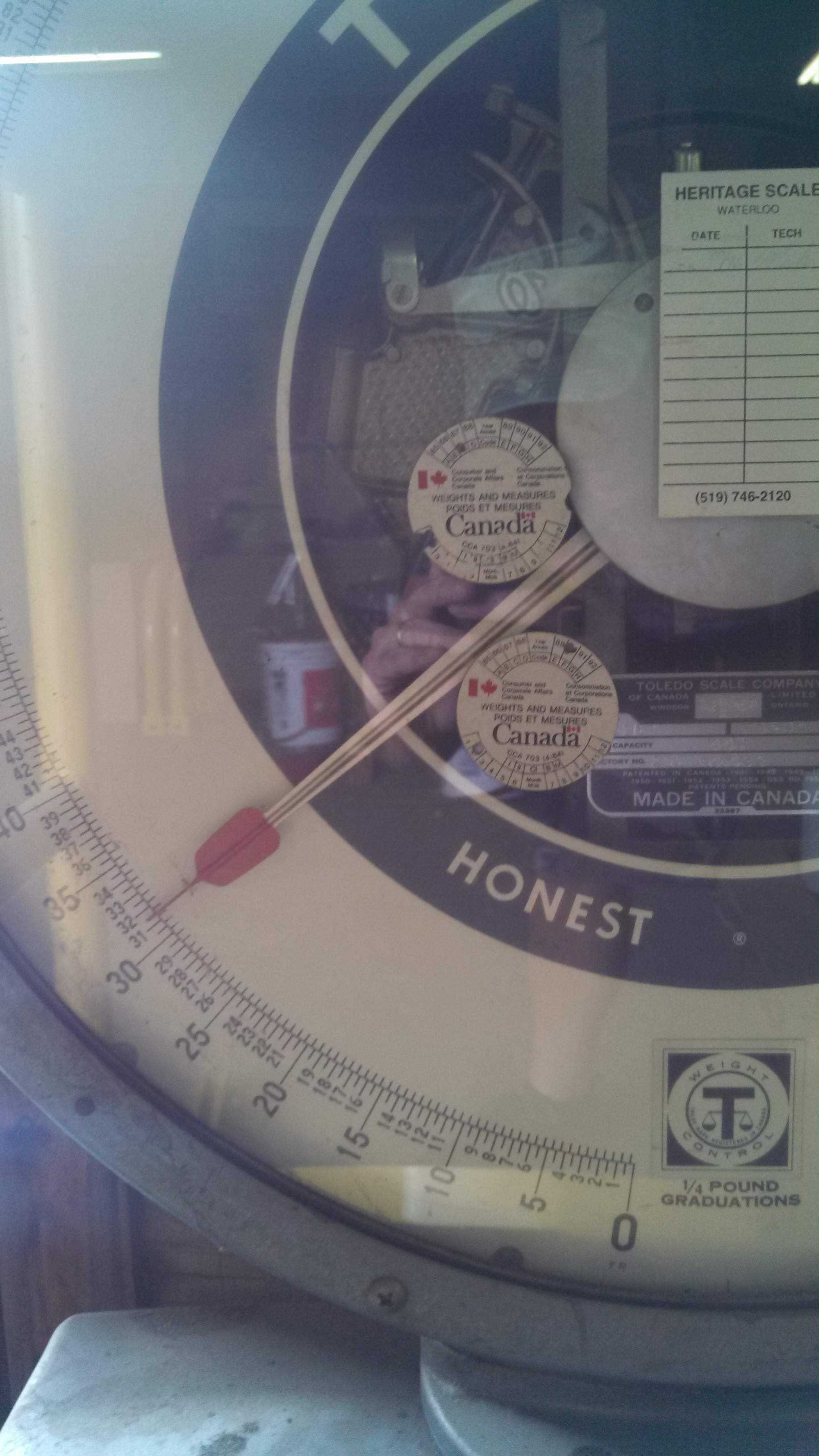

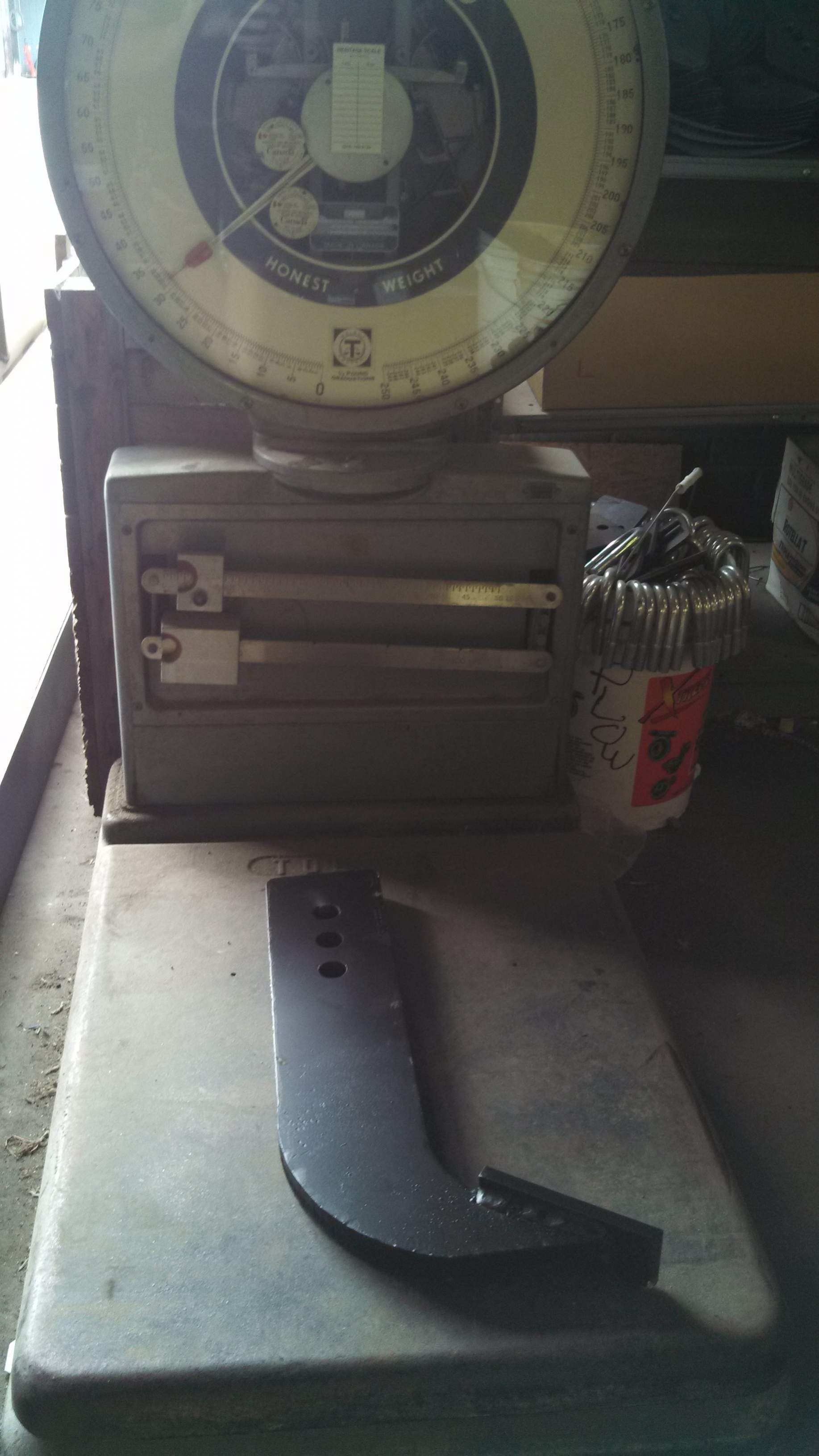

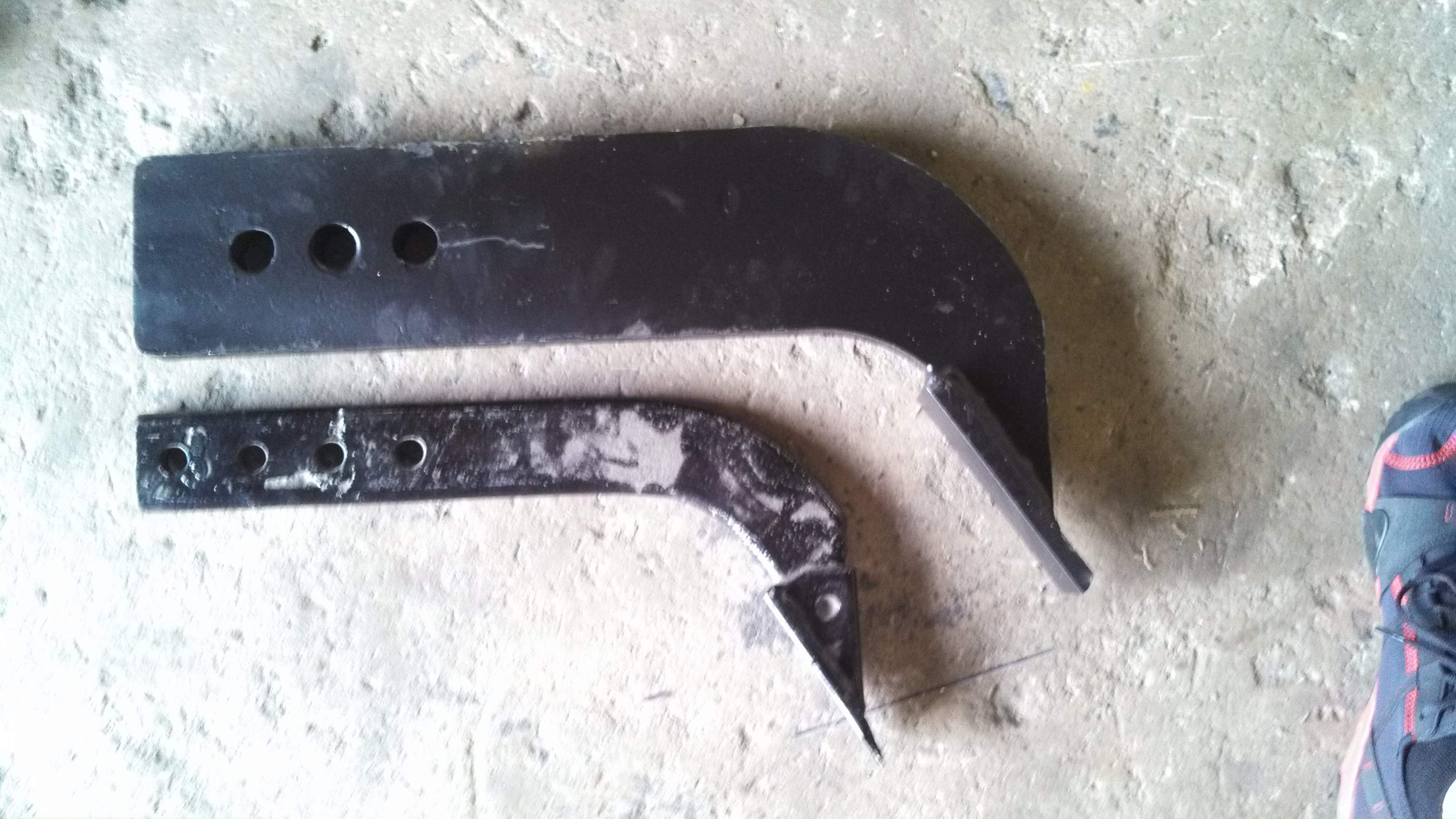

We put it on the scales and it comes in at 2,230 with the pallet.
While I was weighing, I found that the shank weighs 31.5 pounds.
And a normal shank that was nearby weighs 9 pounds.
Quite a difference, huh.
