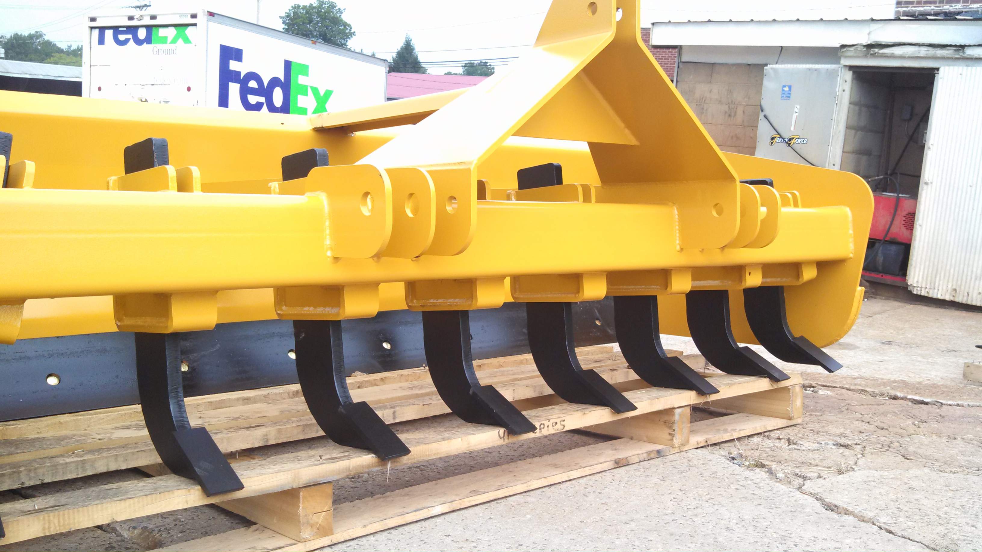

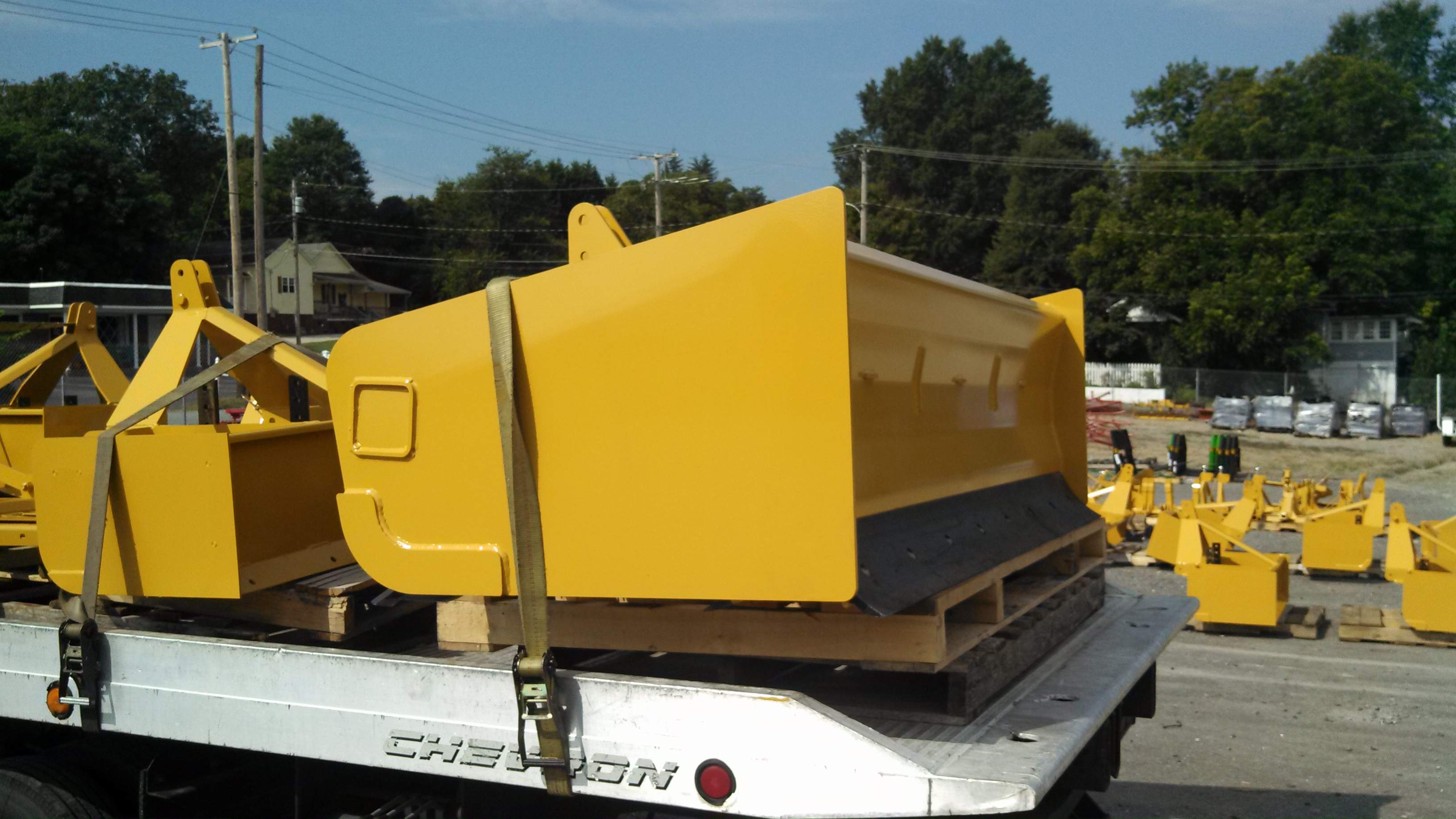

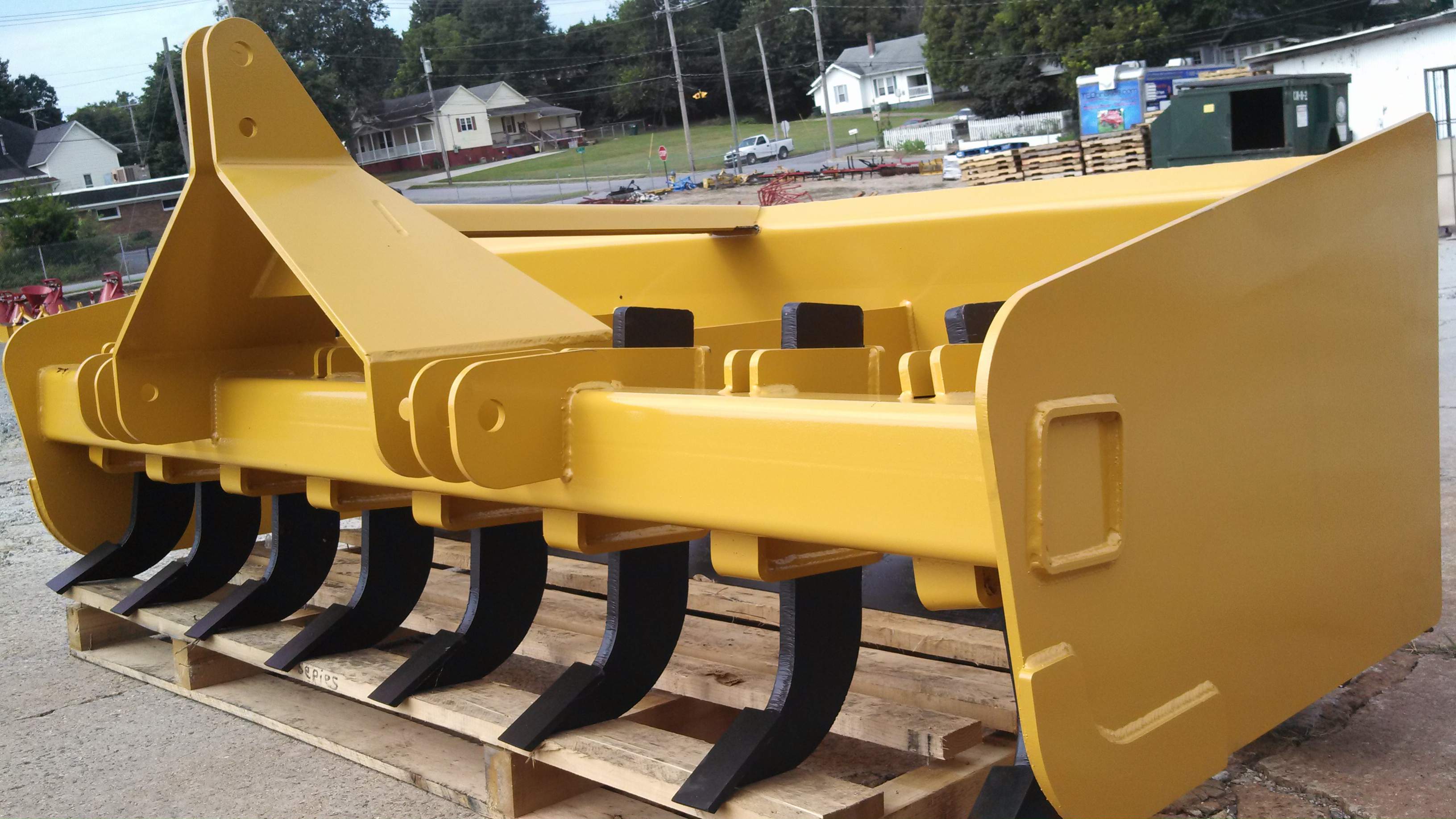

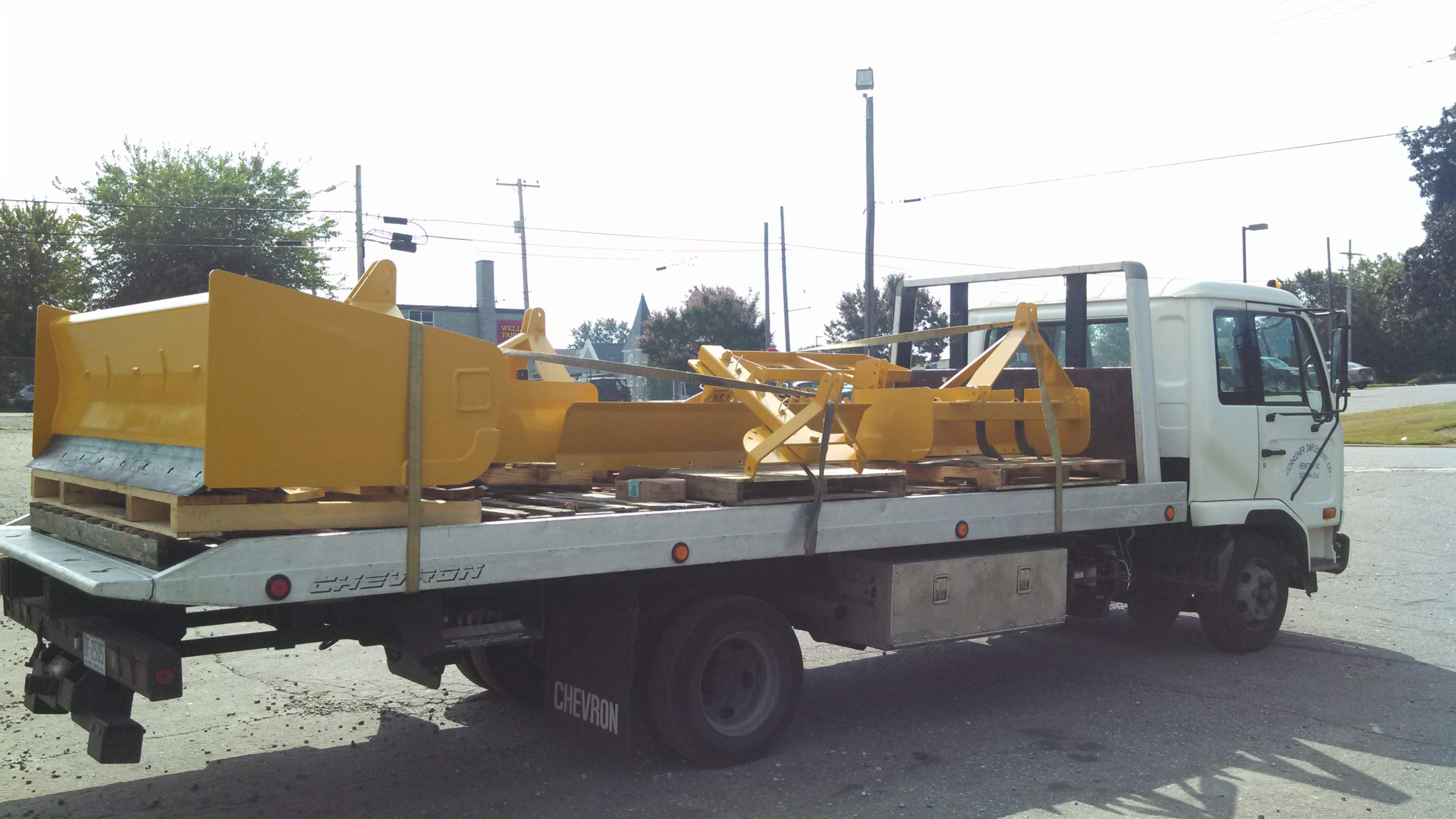

Here are some cell phone pics of the new box blade. Video and high-res pics coming soon...
For those who haven't heard about it, here's some info:
-The one pictured is 96". We are planning to offer it in 78", 90", 108" and 120" widths.
-44" depth, 30" tall back.
-Front tube is 6x6 3/8" tubing.
-Category 2 and 3 Quick Attach compatible hitch.
-Hitch and sides are 1/2" thick with an additional 1/2" plate welded on the leading edge for wear resistance.
-Mold boards consist of two 3/8" thick plates, back to back.
-Cutting edges are 5/8" x 8" viper blades...US made and largest used in the industry.
-Shanks are 1" thick x 4" wide and built in-house. Weld on tips made from AR400.
-96" model weighs over 2,100 pounds. I'll know definite in a little while when we get it on the scale.
-Rated for up to 180hp 4wd tractor or 220hp 2wd.
Ted went right to the top of the scale with this box blade. We will offer boxes in between this one and our current offerings in the future.
This is more than a box blade....It is designed for clearing, shearing and moving massive amounts of dirt. We are going to put it to use soon and see exactly what we're dealing with. Of course, we'll share!!!

Like the added support around the rippers, however at this price point and duty rating the rippers should have been a bit thicker and/or had replaceable teeth.
   / The First Beast is Complete..Serious BoxBlade!!
Looking at this thing in person, I can't see anything that needs to be bigger! It's huge....those rippers are massive.
