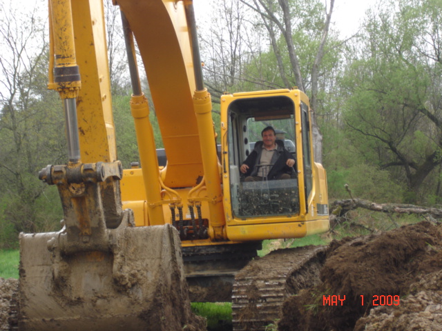

One either provides a surface water source (and discharge) and seals the bottom with clay to prevent infiltration, or one digs one in areas of high groundwater elevation, where permability is a benefit. In doing the latter, I am basically daylighting the groundwater which has flowed down the mountain atop bedrock by removing the gravel it has saturated. As you can see in the pics, the groundwater is perched upon that thick (probably about 6') blue clay layer. If we punched through that, the water may go down the drain! The gravel is confined between blue clay on the bottom, and clayey topsoil.
The water will eventually be clear...and COLD, and is going to be a swimmable pond.
PS....CAT controls seem foreign after some time with Deere controls. I wasted some diesel a few hours ago moving some schlop. However, that "flaw" is WAY eclipsed by the sheer power of that machine. It makes my BH90X seem like a bent spoon......Look at the smile on Nicola's face!
You really haven't dug until you operate an excavator, a purpose built machine, they are amazing at doing what it is they do.

Yeah, I've operated several excavators, up to 322 size and also a 70' stick, but not one of this size and power. It's awesome. I spent a little time on it today, but because of the rain last night, the spoil is still schloppy. The computer operator controls are really handy too.
There is two feet of grade from one side of the pond to the other. The berm levels that out. Once the pond fills, we will finish the berm grade using the water as a "level". I expect to have a little more than 1 foot of freeboard on the pond berm. That means that the pool elevation will be a little less than 1 foot below the top, allowing for storm storage from stream overflow, helping the stream disssipate energy as it had when the area was a field. Two perched springs are at the elevation. One spring is a bit lower. The overall groundwater field is about 2 feet down. If I need a faster rate of water exchange, I can add a water intake pipe and discharge pipe. The intake can be used to spill water over rocks to increase aeration for improved dissolved oxygen.
