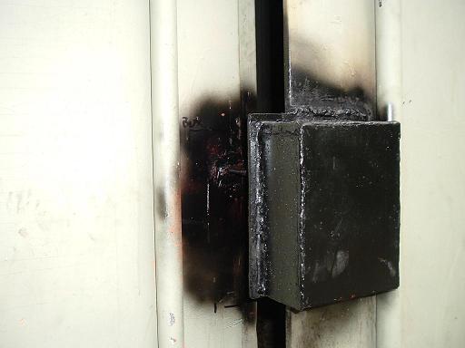

Wow. An old one and lucky to see it up again. I did make such a box for the container out of 1/4" plate. I reach up inside to unlock the rotary style padlock. Only negative is that spiders and bees like to build nests in the open bottomed box.

I didn't see this thread the first time around but i see you've decided to cover the lock. Good idea. Though it makes it difficult with the spiders and bees. I was reading this and thought of the "box" to encase the lock. That's one of the better ways to go in my opinion. Most people don't realize (as I didn't until a few years ago) that a "dangling" lock is not challenge to a fellow weilding a 24"+ "crescent" wrench. Just adjust it to fit the longer sides of the lock and go to twisting. I guess master locks are bullet proof but not wrench proof! Anyway, good thinking on the lock box.:thumbsup:
I have a shrouded gate lock that is horizontal...in the spring Carolina Wrens like to build a nest in it...makes for quite a surprise to reach in and have a bird fly out into your face...
I now look in real good before reaching in...:laughing:
