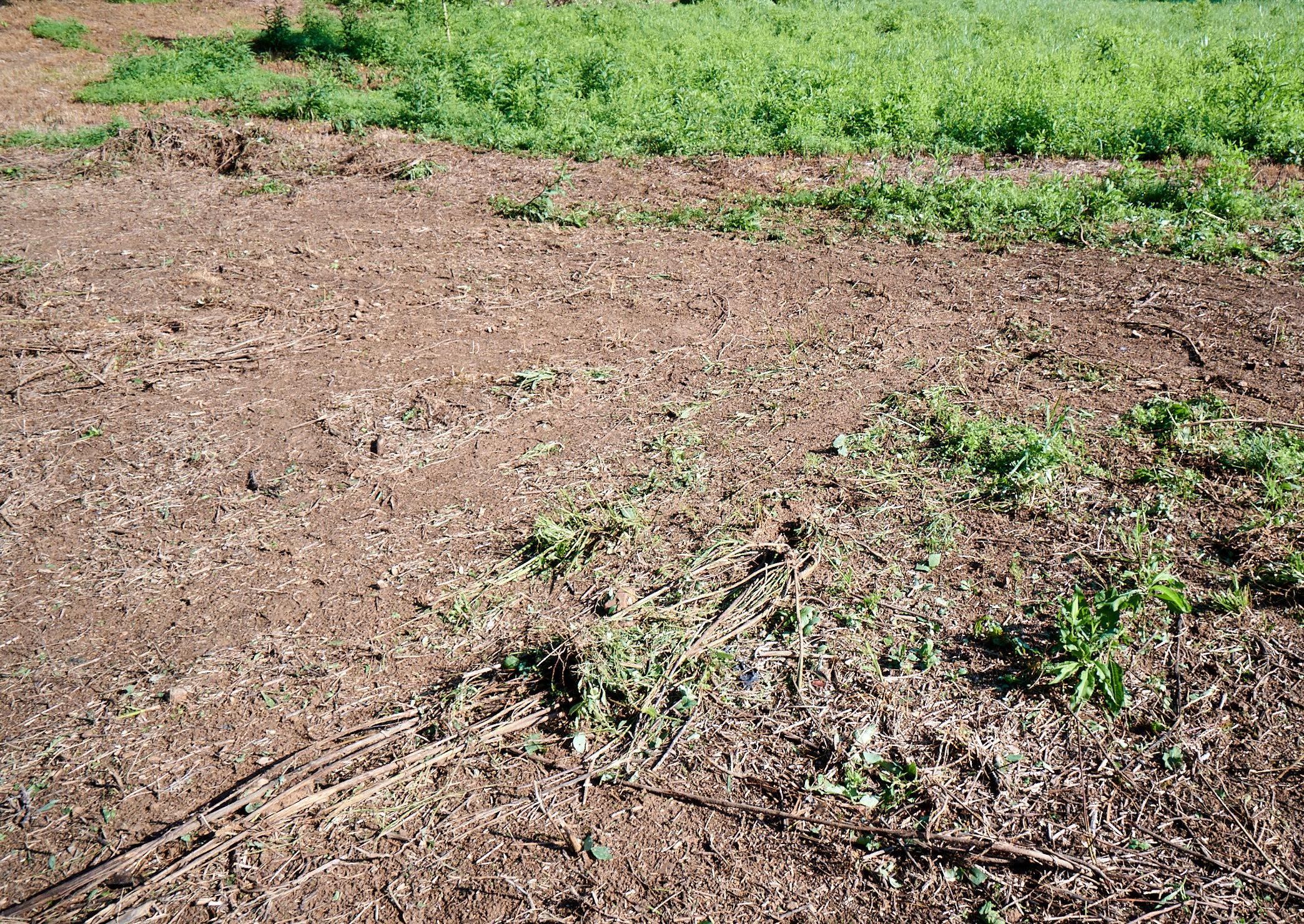

I used a rear mount boom to spray the areas where I saw kudzu leaves two weeks ago with a pretty strong mix of glyphosate and Crossbow at a 3:1 ratio using surfactant.
The area was browned out after two weeks.

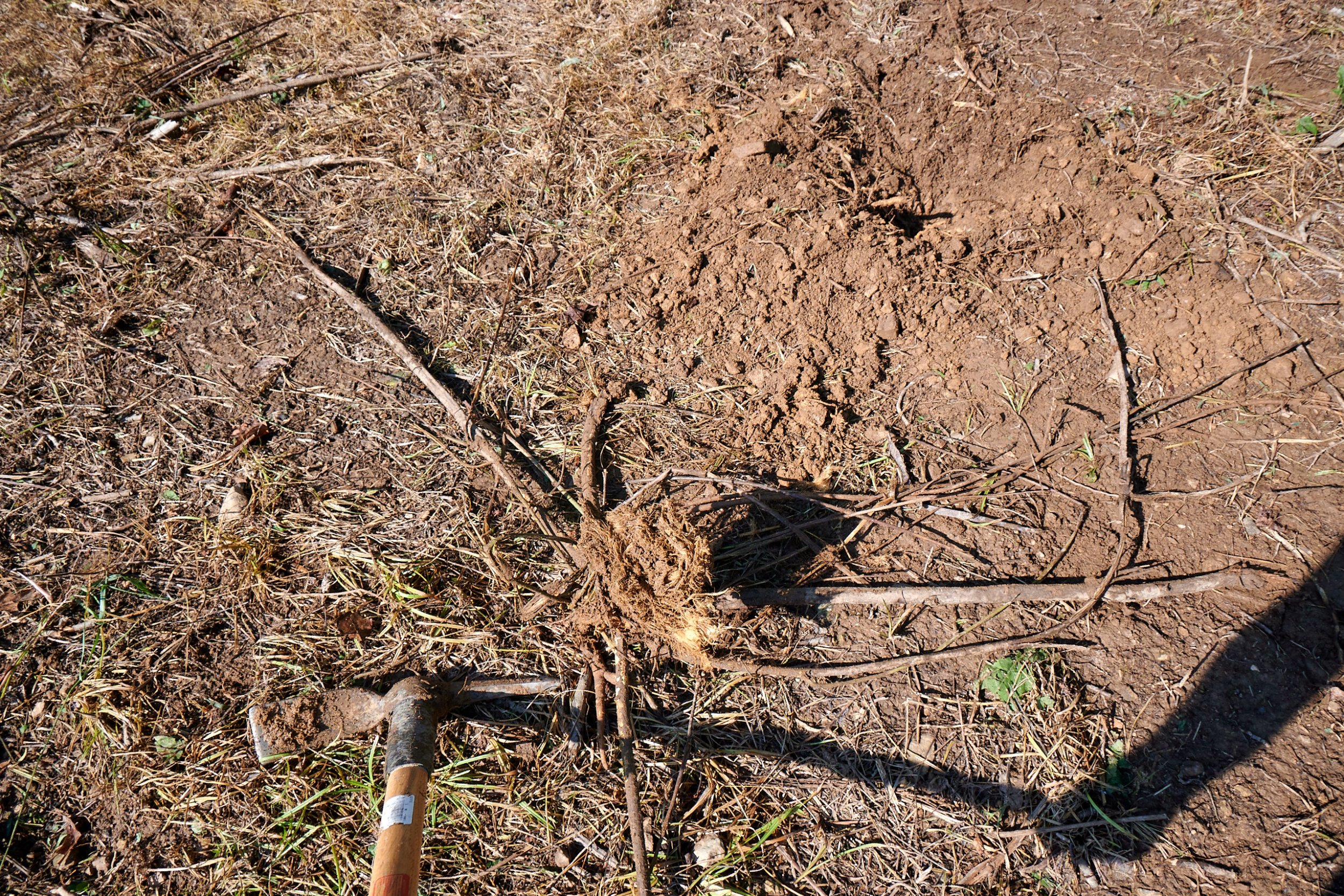

Since kudzu vine grows close to the ground to spread itself, I wanted to see what it really looked like under the dead vegetation. I set the scarifiers on my landscape box to just dig into the ground and pulled off as much vegetation as I could while also trying to rip up the kudzu vine.
I found several clusters of kudzu vine, all of which still appear capable of regrowing. Dug part of one cluster with a pickaxe.
Rotary cutters don't cut close enough to actually cut these vines that lay so close to the ground leaving them to spread. Some of this kudzu is strong enough that I suspect it could break the tines on a landscape rake. That's why I used the landscape box instead.

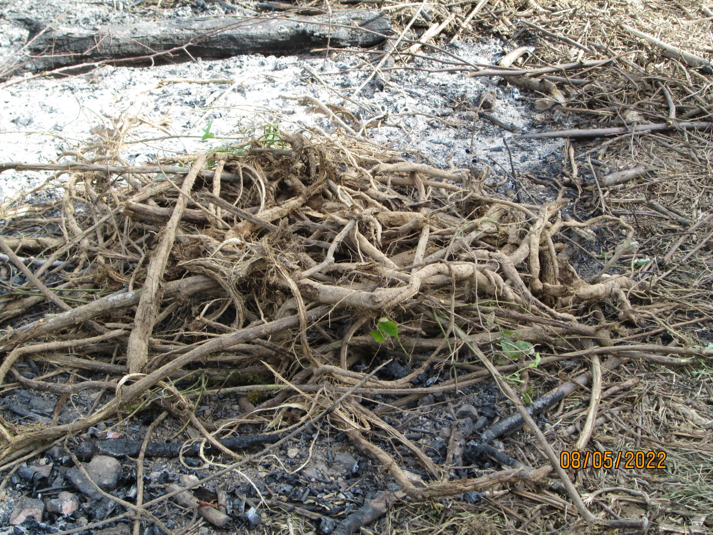

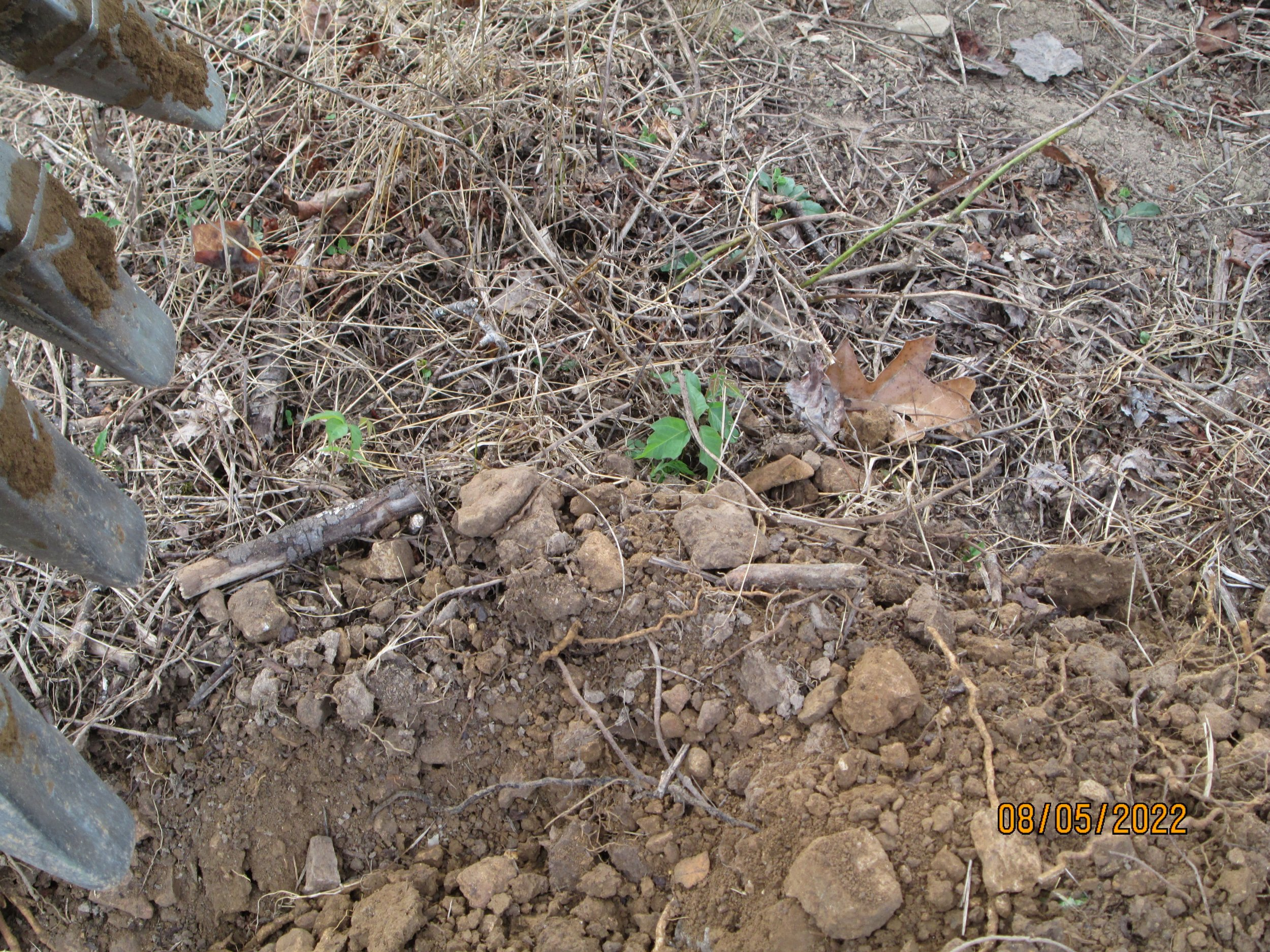

The heat index has been over 100 here for a few weeks now, but with a slight break in temps I did some more digging today to better understand this kudzu.
One of the biggest challenges is how well kudzu camouflages itself to blend in with what's around it. The brown vine blends in with bare dirt. The green vine blends in with grass and other green vegetation. I had literally finished digging out one tuber when I happened to notice another one hiding right beside it.
Another challenge is that it is easy to dismiss a kudzu root crown as insignificant by looking at the surface, but the actual tuber may be nearly a foot long and/or well connected to an extensive root system in the soil.
Todays' digging in a relatively small area turned up several tubers--all of which were still living despite having been sprayed a few weeks ago. My advice to anyone dealing with kudzu is not to assume it has been killed just because the vines on the surface are browned out after spraying them.
