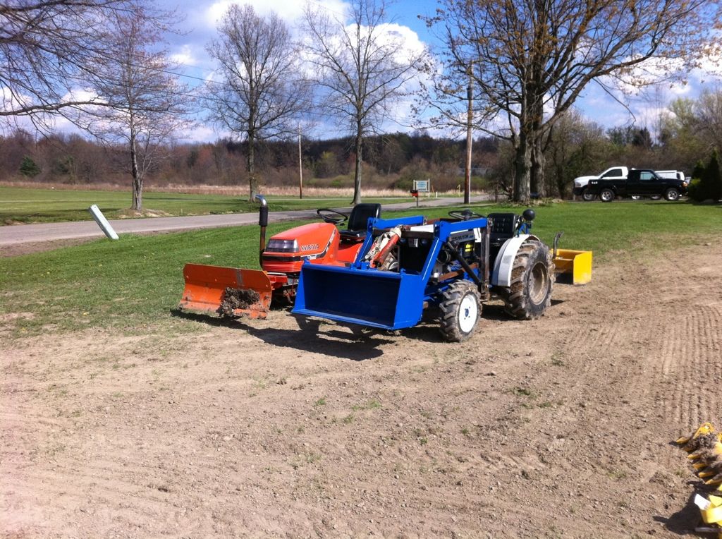

The Bota and the Beaver doin some work!

just got the loader built and don't have the hydraulics hooked up yet.....

I made the stack relatively easy... here was the first design..... It was sweet sounding but it was way too loud mowing for an hour or more....I cut a flange out of 3/8" steel and used a 2" J bend I had laying around from an old exhaust project. I had to notch the hood slightly...
click to play
I then decided to modify the factory muffler. I cut the small tip off of it, dilled a few holes down in the baffle and then welded the Stainless 90 on it.. I too had that laying around..
click to play

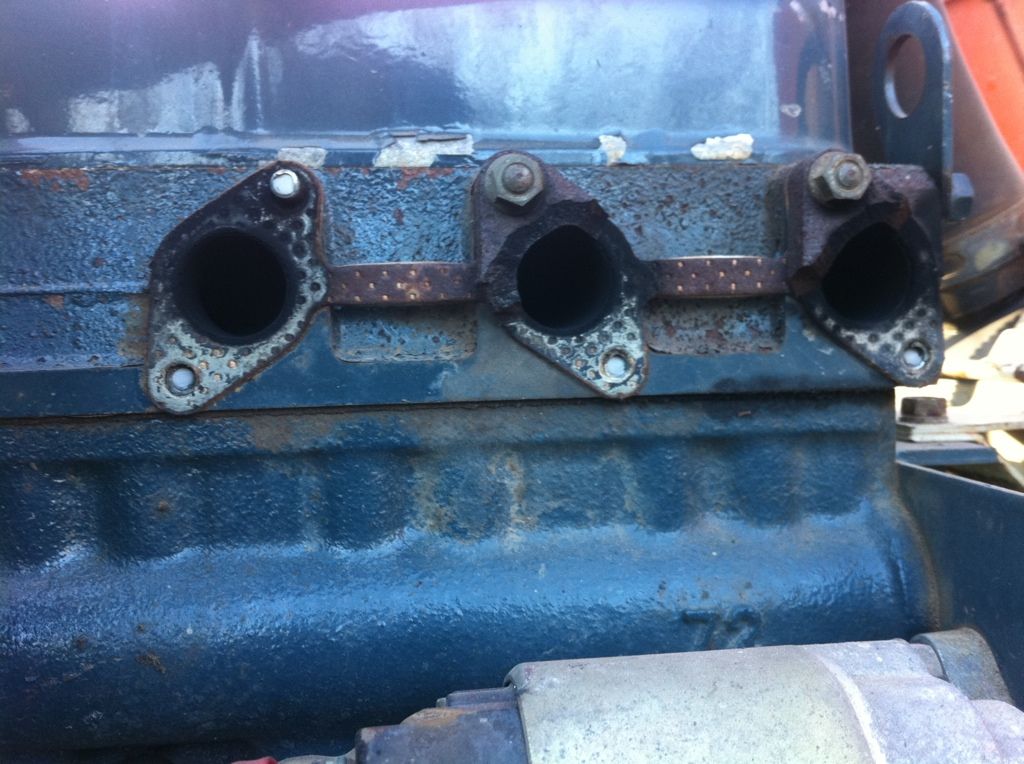

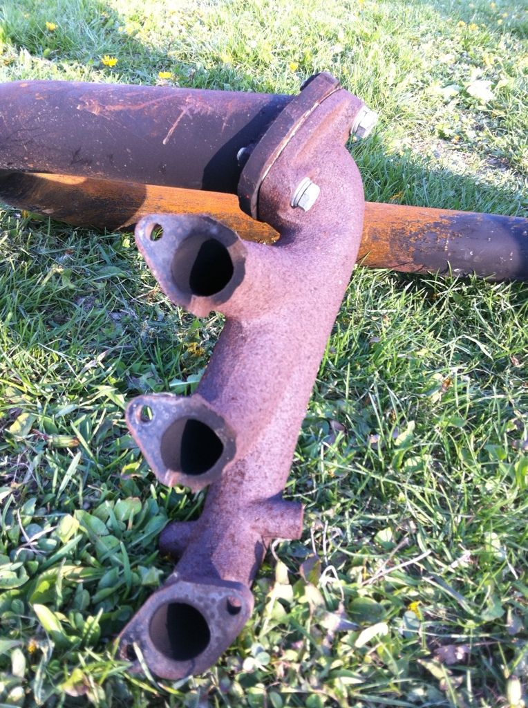

Sounds cool, looks cool. You should see some of the looks I get from people when I'm mowing and they drive by... lol Shortly after this pic was taken ( the original pic in the thread, I was using my tow behind spreader and had it sitting there idleing and the exhaust note changed. I continued raking and didn't think much of it.. I walked over after 10-15 minutes and found this..
The real bummer was that I was going to take off the pipe ( i made it to where I could just cut the U bend off and bolt the muffler back on if I ever wanted to sell it. Well I found a used BX I want and was going to take it off so I could trade it in...
MY advise.... Support the stack!... I know the vibration and the added stress of the taller pipe and thin walled exhaust tubing added to the resonance to eventually over stressed the little 6mm exh studs. I'm waiting on my new manifold to show up. I brazed it back together and cut the stack off and it works for now, but I know its only a matter of time before it breaks again. I can't in good conscious trade it in like that.

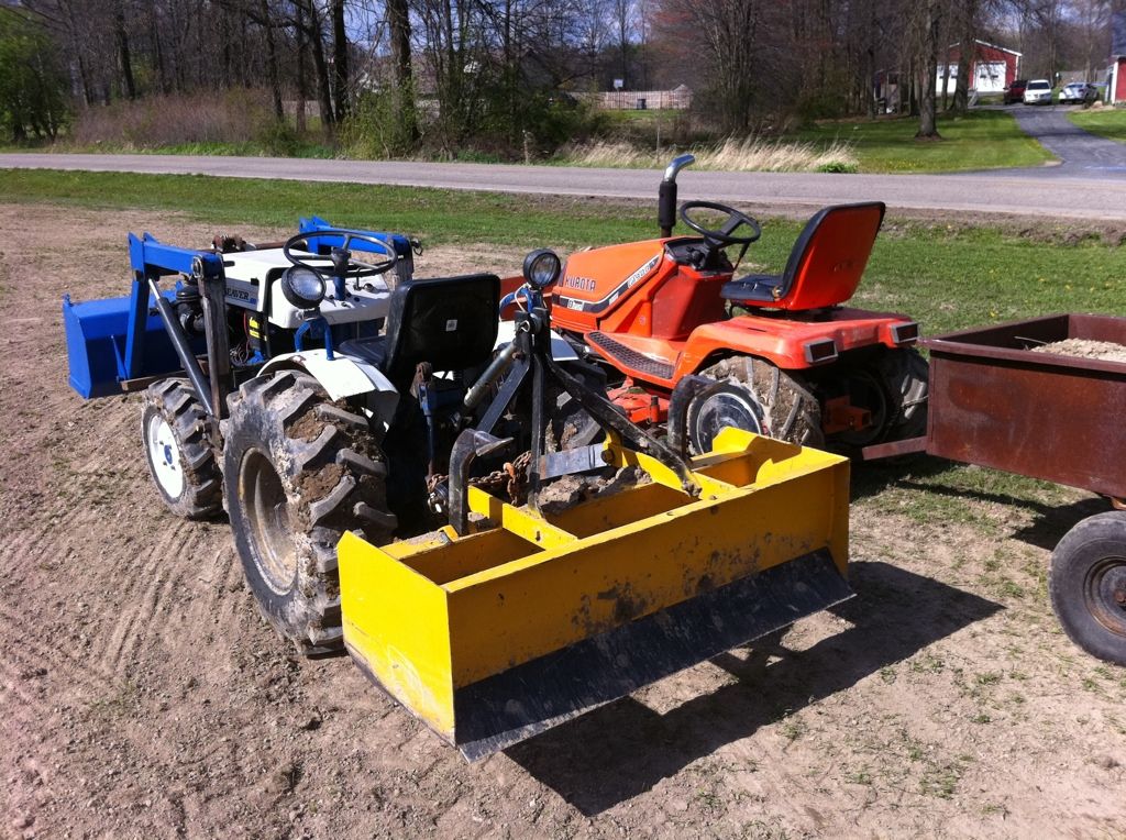

While you are at it...change the hydrostatic fluid and filter. Theres a ton of things you can make or ad to these stout little garden tractors. Heres my rear hitch. Just a simple piece of steel with some holes and a 2 1/2" box tube that will accept a reese style hitch
