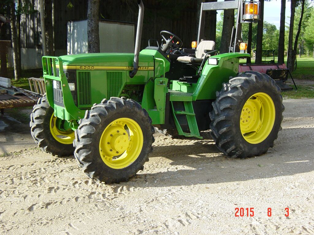

We had gone to the dealer to look at 5000 series tractors. There was a 6000 series in the service department that I climbed aboard. I just had to have one. And at the time, there was no PST or GST tax on the 6000 but was on the 5000 making the choice easier.
Shortly after buying the machine I got a call from JD following up. She said "I understand you just bought a Utility Tractor". I felt a little offended, as I thought we had just bought the biggest tractor in the world!
Anyway, it's large frame and yet only around 70 PTO HP!

That is definitely a utility tractor! Good looking tractor.

That's just coming back from spending eleven grand or so on a different transmission and power reverser. What we should have bought in the first place. Note the mangled steps. A $300.00 oopsie, fixed now. Tractor is circa 91 and only has 1200 hours.

looks good!
