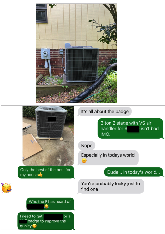

Ended up having to change a no name system out at my house yesterday, because the existing unit we installed about 16 years ago finally had the outdoor TXV go on it, and I decided to change the entire system out.
Below is a text from me to a good friend of mine who I have known since I moved to NC 21 years ago, and we probably are pushing more years closer to retirement age in this industry combined (HVAC).
And below, the original unit that I took out yesterday that was installed around 2006.
So, anytime asks what is the best HVAC system in the world to put in your own home, revert back to this thread.
Don't always go with the lowest price, don't always go with the highest price, go with the person who seems to have given you more information on what and why they are quoting you what they're prosing and trust those people who have the confidence in the equipment they are installing in your home.
Please note, that's like a 40X40 concrete pad. They don't make them anymore or no one is stupid enough to want to use them anymore, so although I would of probably liked to have a larger pad for the newer and physically larger outdoor unit, I ain't moving it or breaking it apart!!
