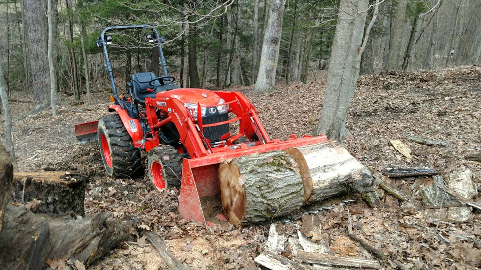

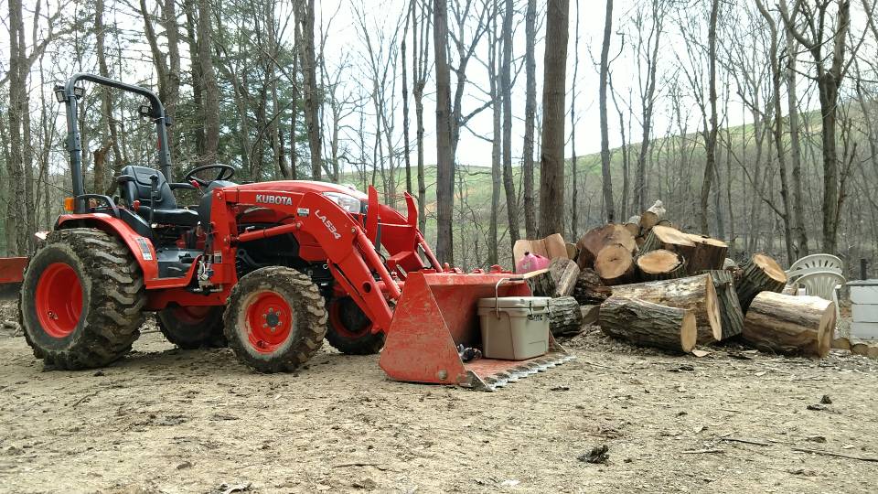

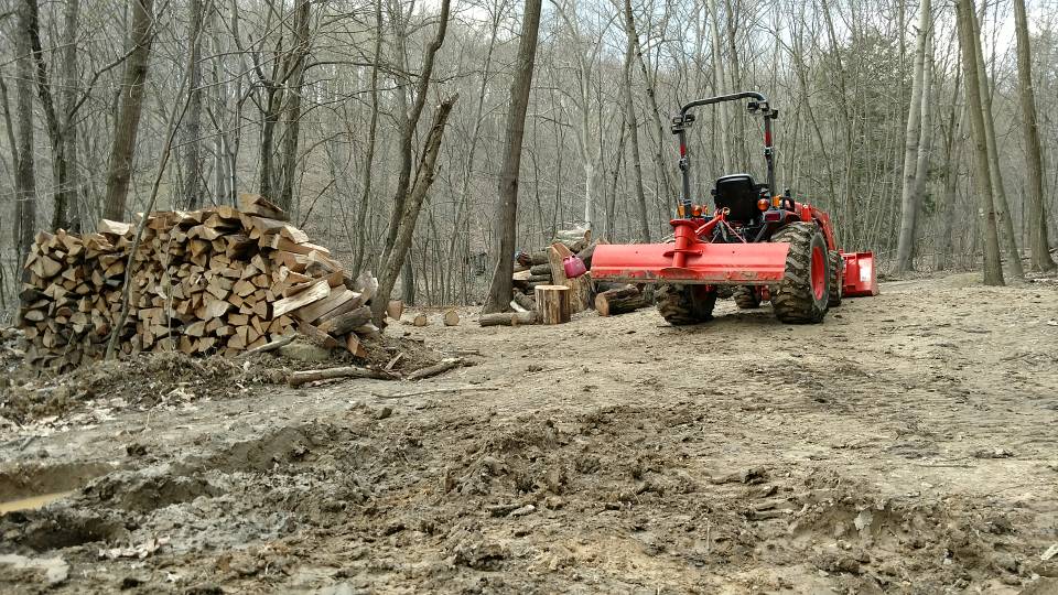

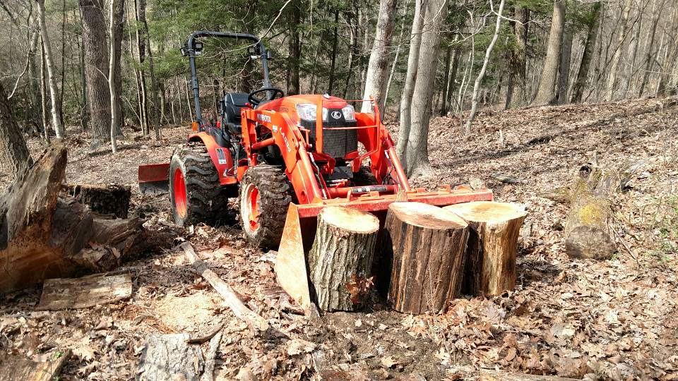

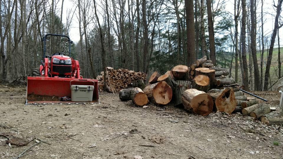

I had a large tree go down last December and I've been trying to find a way to get to it to haul the cut rounds back to our party camp area. Today I finally got a day dry enough to allow me in those slopes! I've got a good but if splitting to do with my new Woods HLS27 splitter tomorrow! I'm excited!
Good! I love this machine! The more time I spend on this thing (70 hours now since mid January) the more I realize how bad that BX25D was. That was a horrible machine for my kind of property and use. This thing is just so awesome in comparison. IMG_20180427_155627045.jpegIMG_20180427_161155664.jpegIMG_20180427_165509732.jpegIMG_20180427_165525691.jpegIMG_20180427_165547734.jpeg

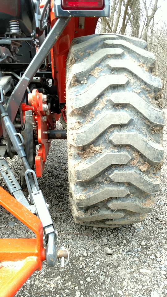

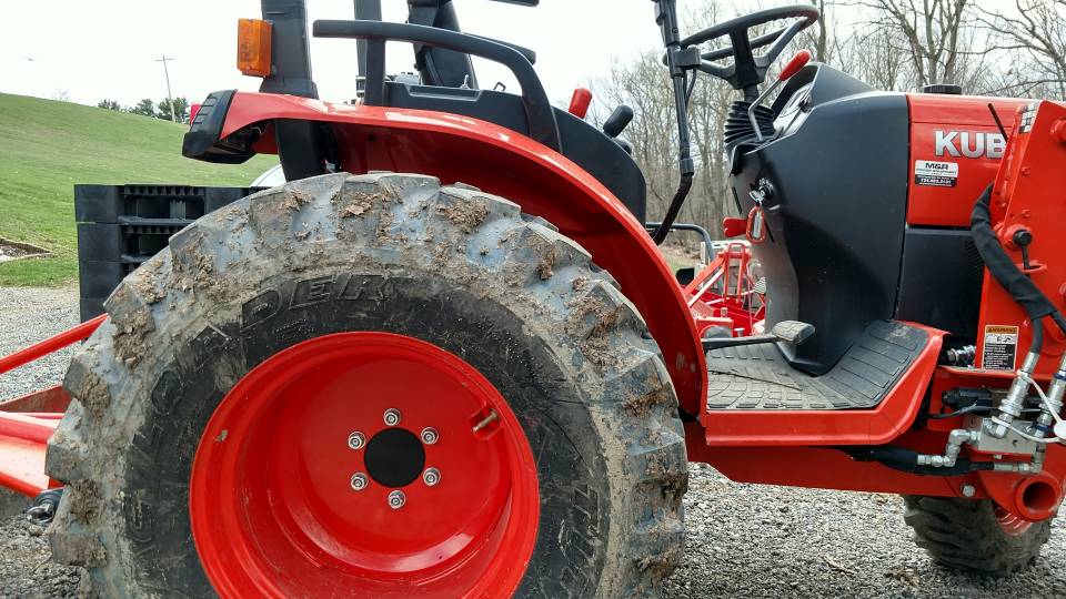

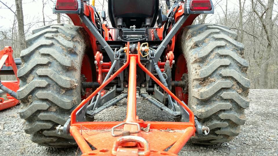

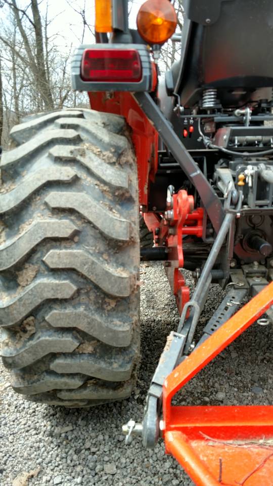

People keep asking me if chains can be used with the larger tires on the B2650. I ran and took some photos so that you can look for yourselves. I'm not using chains and do not plan to. But to me it looks like there is plenty of room with the Kubota 1.5" spacers that are in mine.
IMG_20180429_143425766_HDR.jpegIMG_20180429_143435343_HDR.jpegIMG_20180429_143511882_HDR.jpegIMG_20180429_143528630_HDR.jpeg

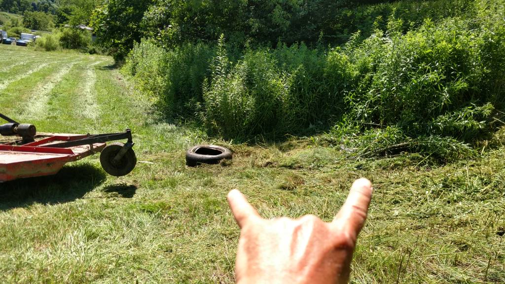

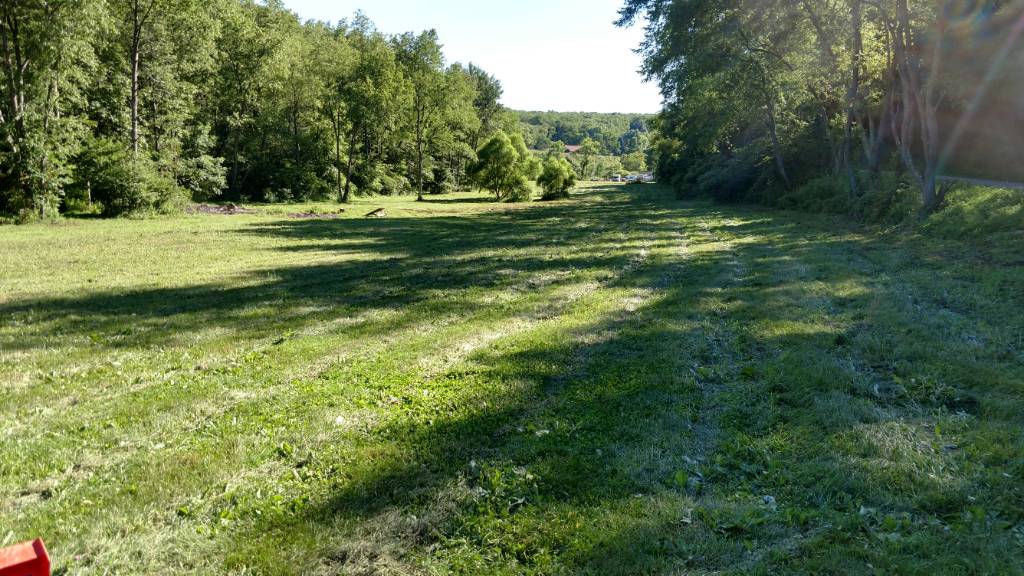

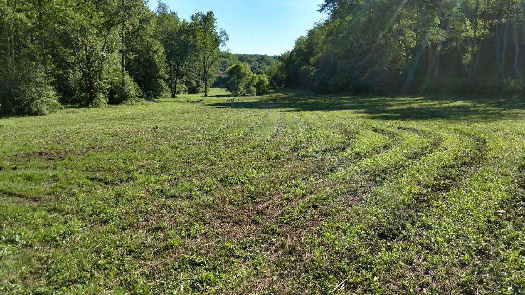

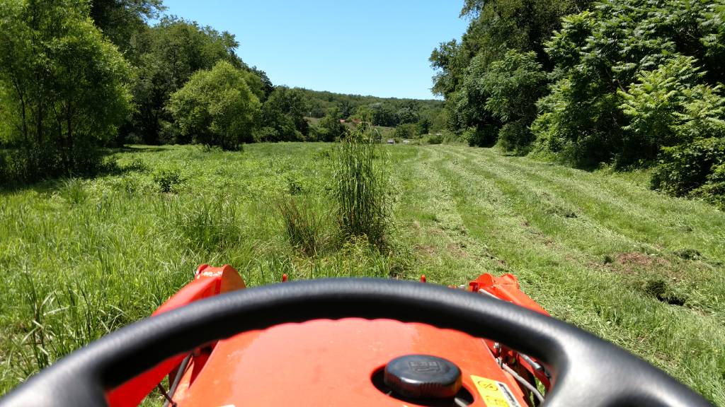

While the countdown is 7 months past, the tractor is at 155 hours and working hard almost every day. Today was brush hogging at the in-laws house. It's 4 acres of relatively flat ground with some swampy mud thrown in for fun.
At 155 hours on the clock, I've got to say that this machine is wonderful! It's a work horse for sure and it never ceases to amaze me.
I've honestly not had any issues beyond a couple fittings leaking in the very beginning, and then a couple minor issues that were user induced. The machine has been a complete beast, and I'm expecting it to keep being a beast for at least a few thousand more hours. I'm expecting to see around 300 by the end of this year, and similar next year. After that, my use time should back down by at least half as my major project is expected to be completed by the end of 2019.
I really love my little bull!IMG_20180707_124935692.jpegIMG_20180707_145421013_HDR.jpegIMG_20180707_174100576_HDR.jpegIMG_20180707_174117894_HDR.jpegIMG_20180707_174228261_HDR.jpeg
