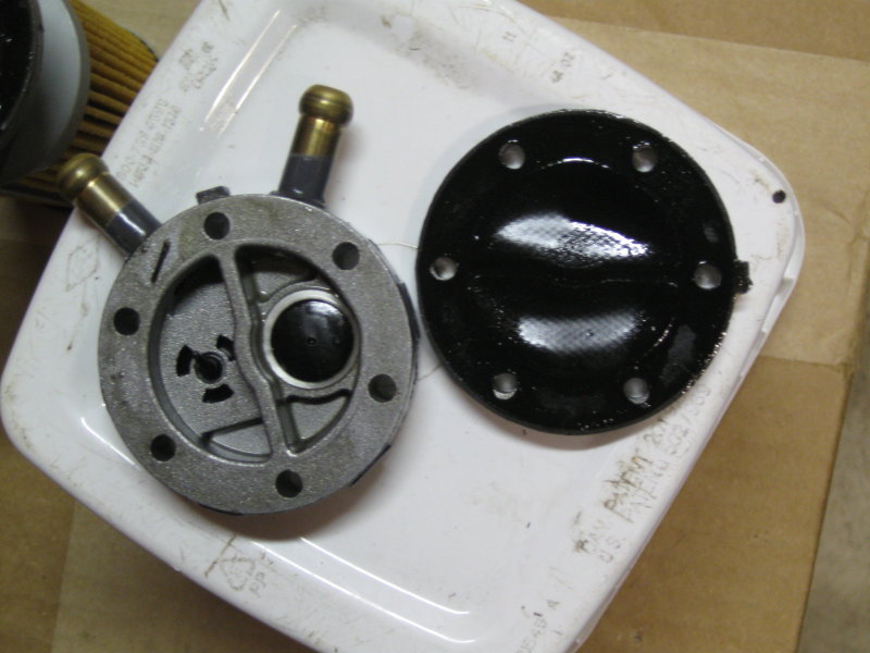

"....causing air to be drawn into the fuel line? Perhaps a fuel pump or relay?" Hmm........... Now I'm looking at the fuel pump. I pulled the fuel pump and taking a deeper look. Allow me to get some pictures of the fuel pump and I'll return...............

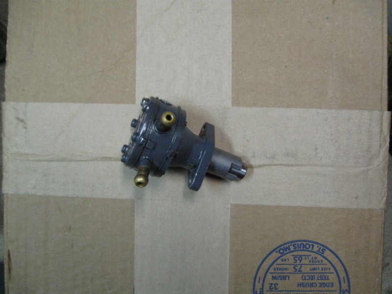

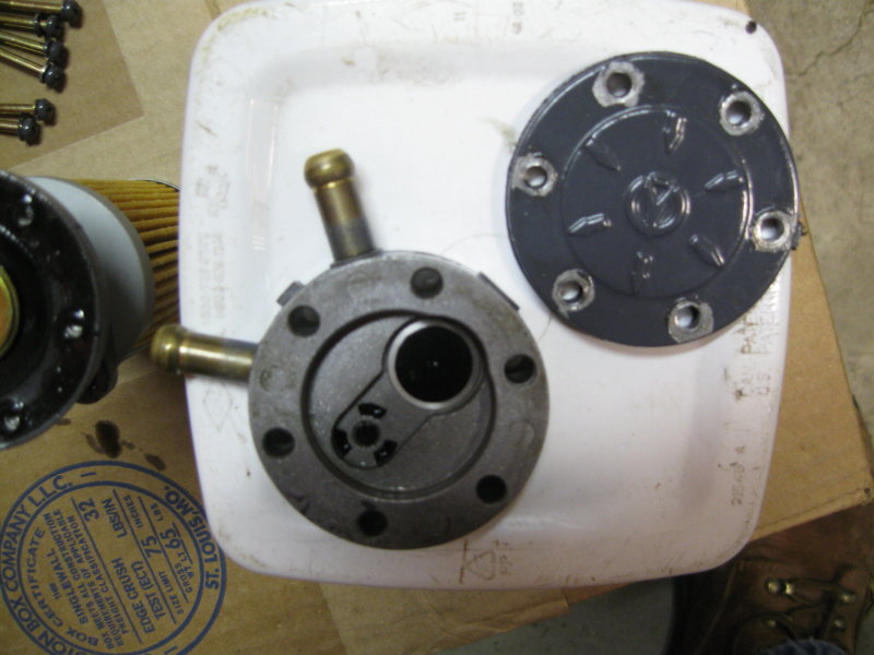

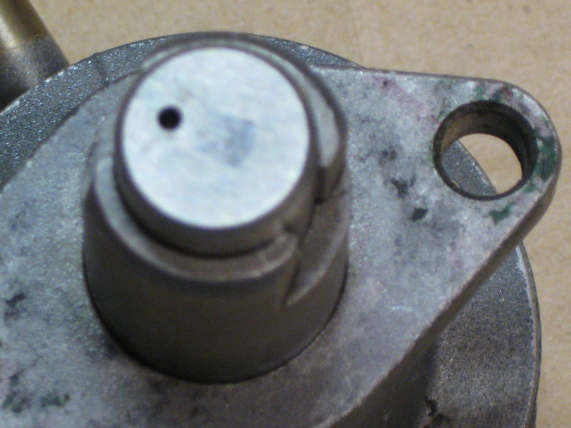

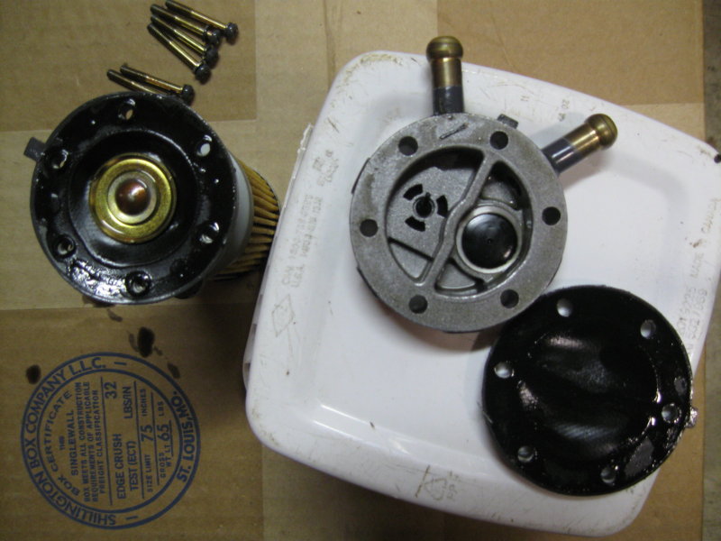

Different views of the fuel pump. I'm not seeing anything torn, broke or bent. Comment?

Fuel bowl was half full, the other half is air, you are getting air in the system and sucking air into your injection pump is going to make your engine run poorly and die.
You have an air leak upstream of the filter.

Fun to see the fuel pump dissassembled. Thanks for the photos. I never meant to imply that the fuel pump was itself electrical. Didn't mean to lead you on a wild goose chase. Just was suggesting that there are electrical parts in there that control the flow of fuel, and that they should be checked out while they are hot.
