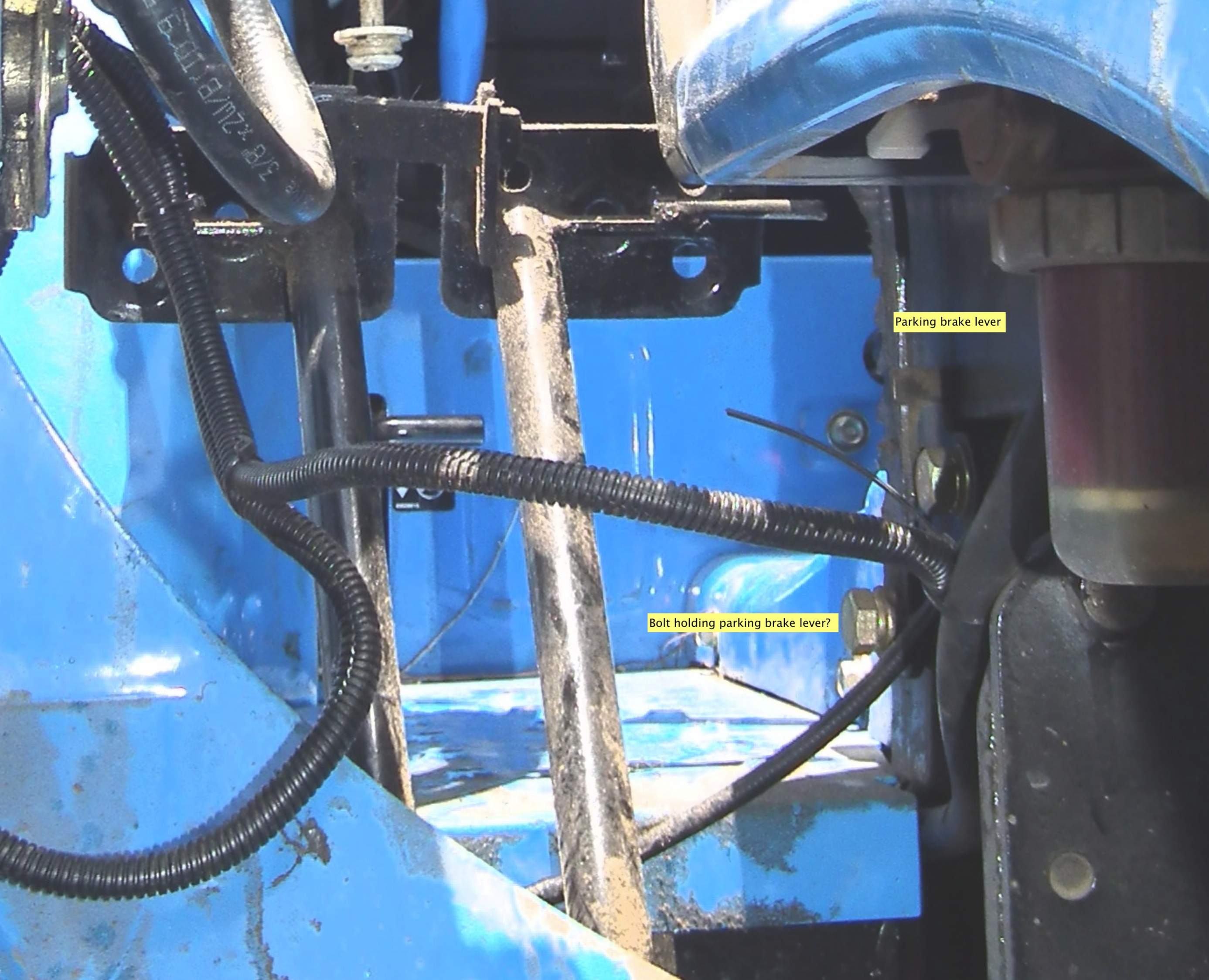

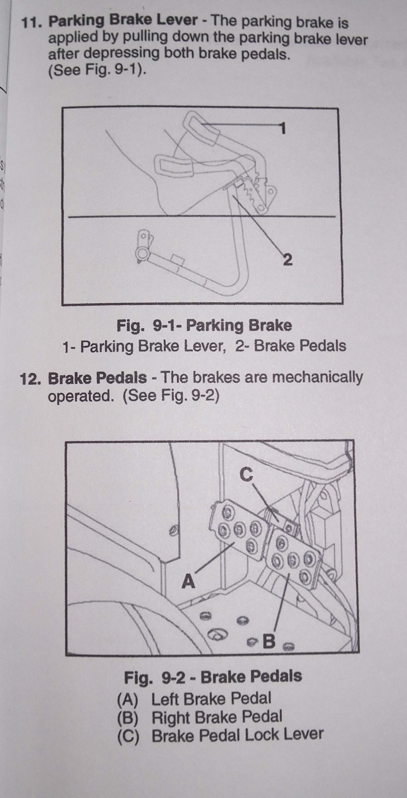

Don't know if any of this will help, but here is what it shows in the S3010 manual:
And here is a shot I took to show the wiring to my diverter. It kinda shows the design of the parking brake:
Good luck if you decide to modify yours.:)
