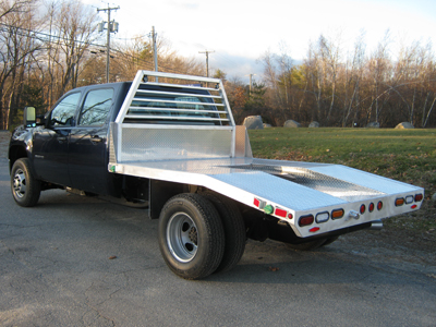

How about something like this?
From this website....
NETD - Flatbeds
