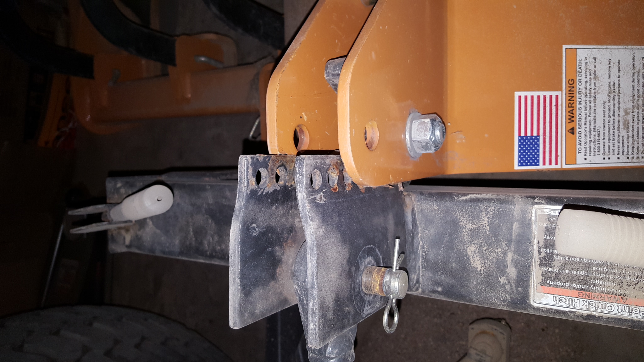

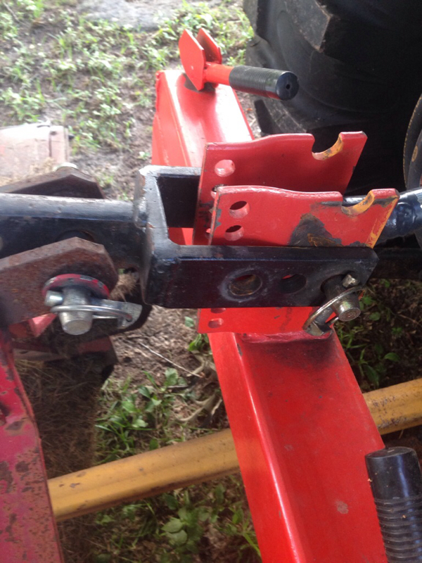

Actually I think I was the first with flush pin mod, but perhaps not the best. The first picture is mine, the second one isn't.
Thanks, Kenny. Apologies for the misdirected credit. It's a very neat solution! The top pic is no doubt yours. BTW, on my two HF QHs, I found I did not need to grind down the thickness of the hook's shank.
The second pic is of my Woods BSM84 box blade hooked on. It shows how the QH bracket just fits between the ears for the BB's toplink pin. I've played around a bit to get the pic to open in the correct orientation when double-clicked, then gave up.

But that would still leave the tight clearance issue on some implements, as shown in the second pic in my post No. 5. That can triple the hook-up because the alignment must be spot on. With my 735 lb BB, muscling the implement by hand to reposition it is not realistic.
If you have a welder big enough to give you adequate penetration in the hook's shank, I'd just weld on an extension and avoid the bracket issue. I'm even thinking about redoing both my QHs that way. But the welds must be very good. Breaking loose with a full load in the BB or the rear snow blade in freezing weather would be ugly. :eek:

Welding the hook solid would give exactly the same clearance as the flush pin method as it's usually the bolt heads that are in the way. From what I can see in your pic, welding it would have provided the same clearance.
I agree with this. But it's the overall width of the QH bracket itself that still is an issue for me. I've attached another pic that shows the QH bracket protruding 1" between the ears on this particular implement. The 1/4" sides of the bracket mean for 1/2" less clearance when I'm trying to hook up. So my alignment has to be almost perfect at the top pin. There is much more clearance, side to side, at the lower implement pins. All I'm saying is that extending the top hook an additional 1" beyond the bracket would make hookup for me much quicker.
