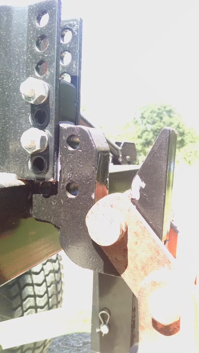

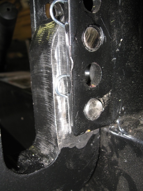

Just a quick shout out to all of you who have shared your great ideas over the years which give the rest of us the benefit of your ingenuity. As an example, earlier this summer I purchased a Quick Harbor Freight Hitch (yeah, you know, on sale and 20% off - cheap!) and of course had the same problems that many of you have had to deal with such as clearance problems, fitment issues, etc. After reviewing many past posts I came to the simple solution similar to what others such as 94Bullet and Fallon have done. For those who are interested, the links to their discussions are included - good stuff.
Although I didn't take any pictures during my build, below you will find a picture of the finished product which show the tweaks that I incorporated to my take on the adaptation of the upper hook. If you look carefully you can see that the extension to the back is a little bit longer with three holes so that I can drop the hook down an additional couple of notches which I needed for one of my really old attachments. In addition, if you look closely, you can see that I cut off about 5/8 inch off down the length of the front of the hook which allows it's thinner profile to fit into tighter openings on the attachments.
Anyway,, although I include my "tweaks" to other's ideas for the hook, the real reason for this post is to thank all of you who have shared and helped out the greater tractor loving/using family.

I do have a question though. You said you "did the flush mount pin mod instead" - what's that?
   / Thanks to all - and HF Quick Hitch tweak #5
Thanks Cadillac (I'm a neighbor in Big Rapids). I agree... the cost was certainly reasonable and what a relief in not having to try to muscle attachments it get them hooked up. :cool2:

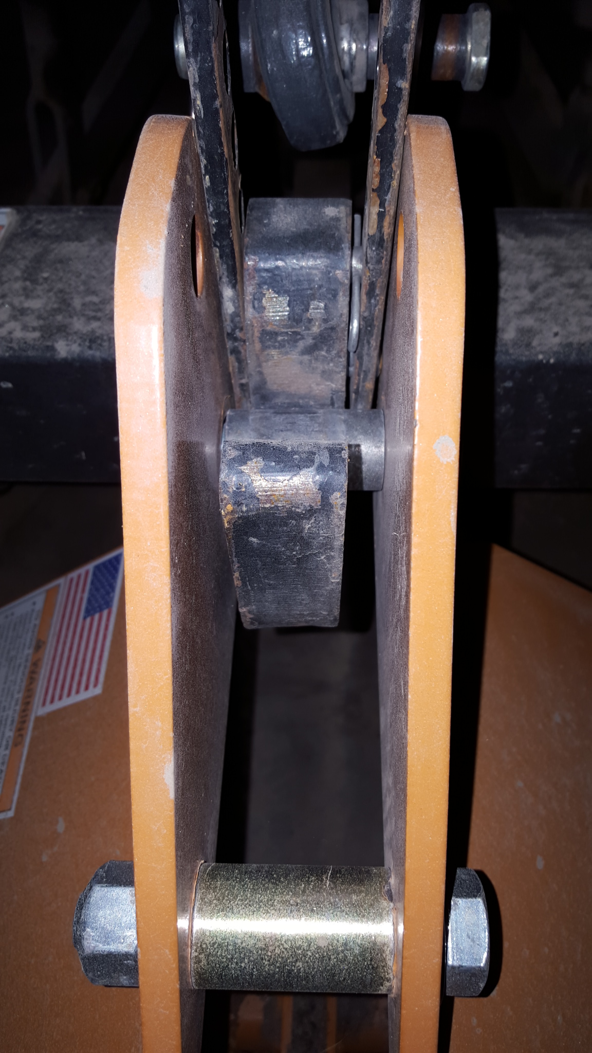

I think he may be referring to this solution (see pics), first posted, I think, by Roger (94Bullit). I've used it on both of my HF QHs and it works well. However, I think the best solution is to add and drill bar stock to the back edge of the hook to extend it farther from the bracket, as you and others have done. That requires a bigger welder than my 155 amp Lincoln mig.
The flush-pin method still requires that the bracket itself be narrow enough to fit within the implement-side toplink bracket. It also requires more precise positioning when hooking up.

Actually I think I was the first with flush pin mod, but perhaps not the best. The first picture is mine, the second one isn't.
