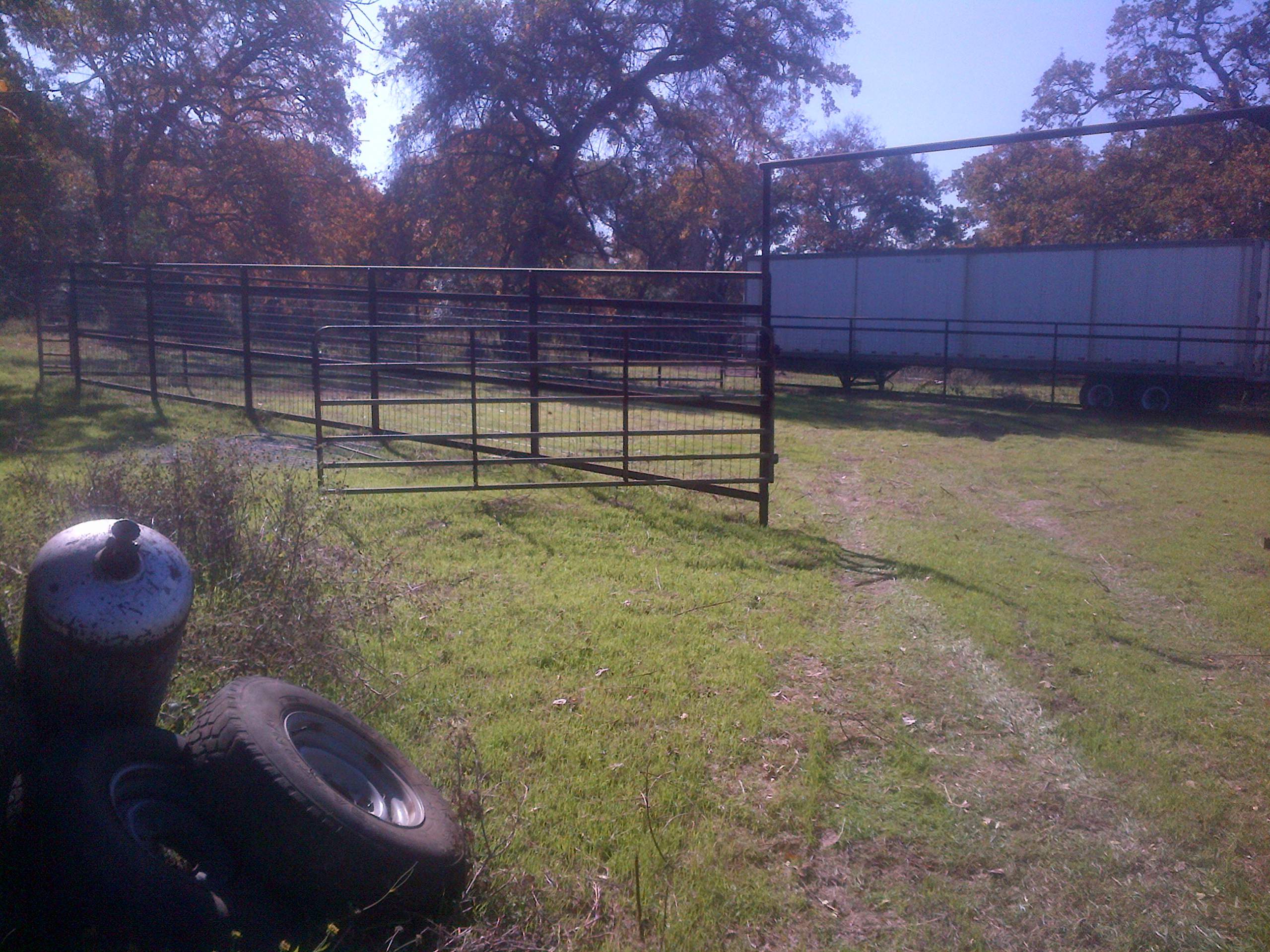

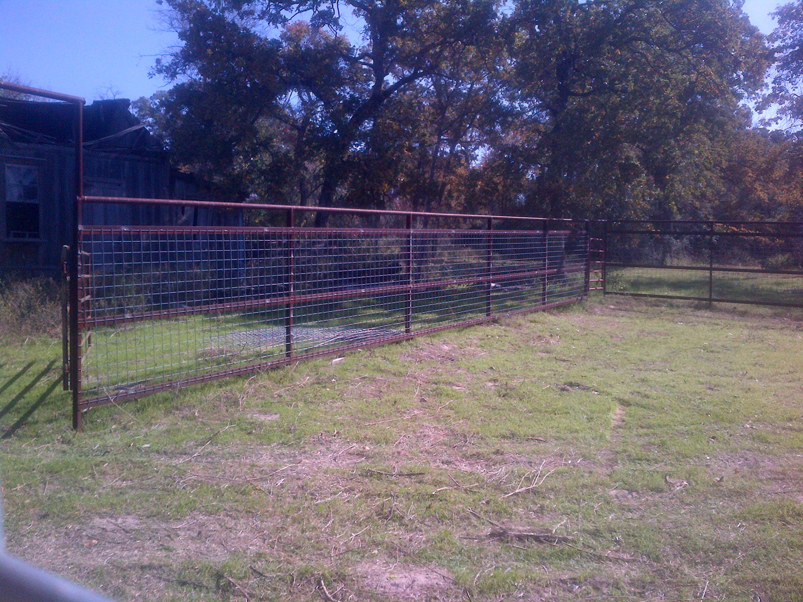

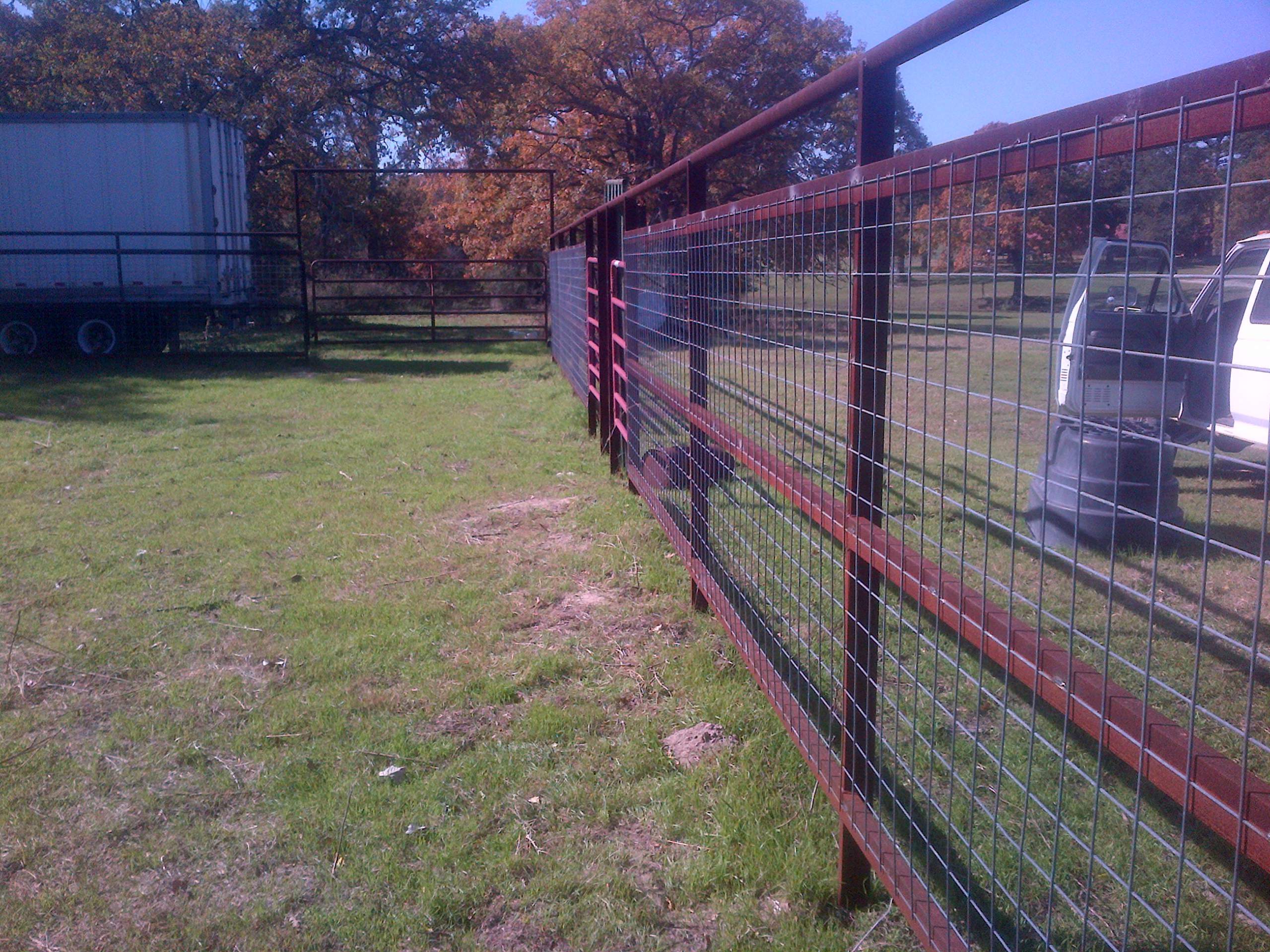

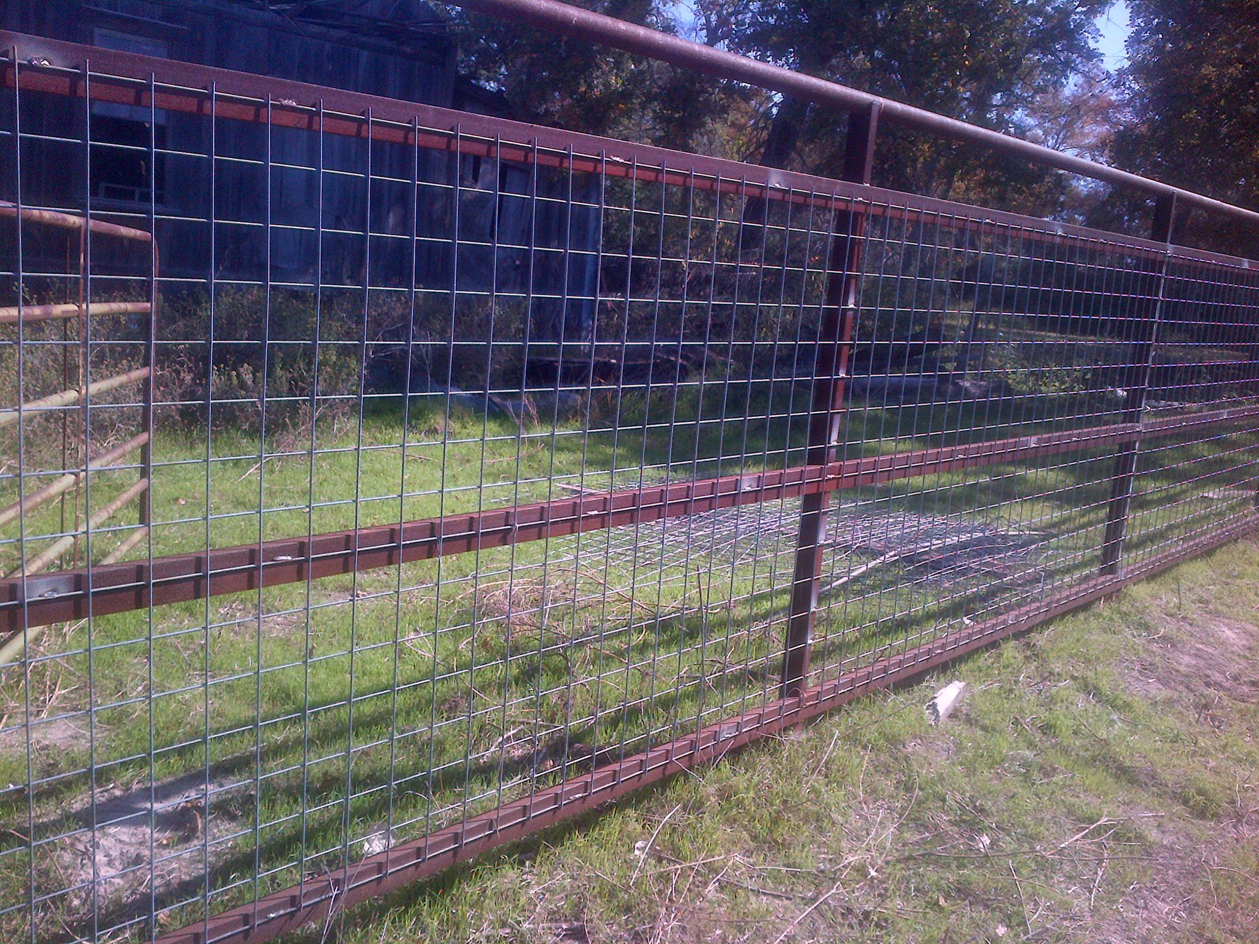

Weather has been so nice I started on my cattle pens again,finally got the outsides done,now for the interior lay-out.
View attachment 346609View attachment 346610View attachment 346611View attachment 346612
Hey man, that looks great! Built a few of those that's for sure. I see you went square tubing, what, ya chicken:laughing: I never thought about the ST, always used the drill stem. Is this a cutting/loading pen? if so, wait until you see the prices of headgates OMG!!

Yeah my main working pen. The top rail is 2&3/8's and the other is 4in. channel. The channel has worked out great and got it for .86ft new and drill stem was $1ft used but don't have any problem welding it. I have a squeeze chute with headgate,its not new but still works,need to repaint. I am thinking about having someone come in to sandblast and paint everything,surely someone around here does that.

I think you may come out WAYY cheaper getting some OSPHO and treating then painting it yourself. We sandblast and on the cheap, it starts @ $4 ft.
OSPHO is great stuff. I have used it for over 20 years probably. Ospho Rust Treatment - Since 1947
I dont think I'd do anything to the chute other than some paint.

Thanks Dennis,I may do the Ospho myself and find someone with paint sprayer,cause hand painting aint happening:D
Do you have to brush it on or a pump-up hand sprayer work?

Foreman, you can brush it on or use a paint mitt. When I do pipe, I usually use paint brush and old T shirt while wearing those rubber dish gloves. Sometimes you need to do 2 coats if it has scaly rust, but I have only had to do that once or twice, it's great stuff.
You could paint it yourself in an afternoon, either use a paint mitt and brushes, or re
nt/borrow one of them wagner sprayers.

It will take me awhile to get the different pens and chute system done on the inside. That would be a lot of brush or paint mitting,think buying a wagner sounds good.

Foreman, I dont think I would spray the OSPHO, I think you would get allot of waste. Paint sure.

I would second using Ospho. We did pipe fence with a mitt. But my first choice would be painting it with Hammerite. That is some really good stuff. But it's thick so brushing or a mitt is about the only way to apply it.
