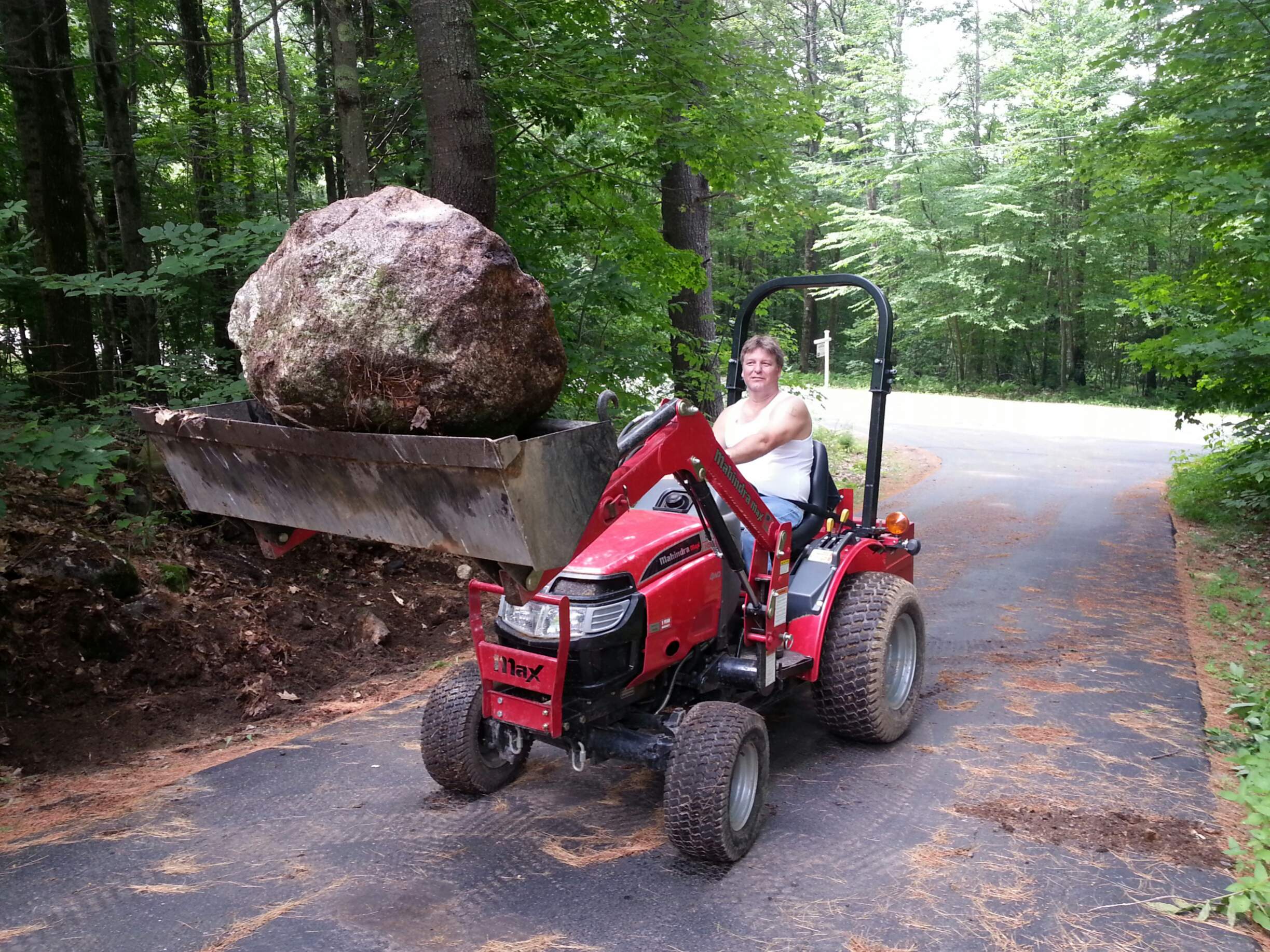

Quite a rock
A bit of advise, never lift you loader that high when carrying something that heavy. High centre of gravity can cause you BIG problems.
/ Testing the limits of a Max 22
I had it that high knowing I was at risk, but couldn't keep it in the bucket down low. Not smart, I knew it when I was making my turn, I could feel it which is why I told my wife to stay clear.
/ Testing the limits of a Max 22 #5
4-500 pound rock. i think the max could handle at least 2 of those. or am i wrong.
No way could I have lifted two. My front end would have been on the ground. I think the rock was a lot more than 400#
/ Testing the limits of a Max 22 #7
I agree. I'm thinking this is a granite rock? Depending on density anywhere from 165-200 lbs per cubic foot.
Yep, it is granite all right. 24x20x20" give or take. That is about 4 cft. All I know is it was one heavy son of a gun and I would not want to go any larger even if the loader would probably lift a little more.
/ Testing the limits of a Max 22 #9
Well towards the end of the video you can see the rear tire lift off the ground. I think that qualifies as "not good". :thumbdown: But knowing your limits is good. :thumbsup:
